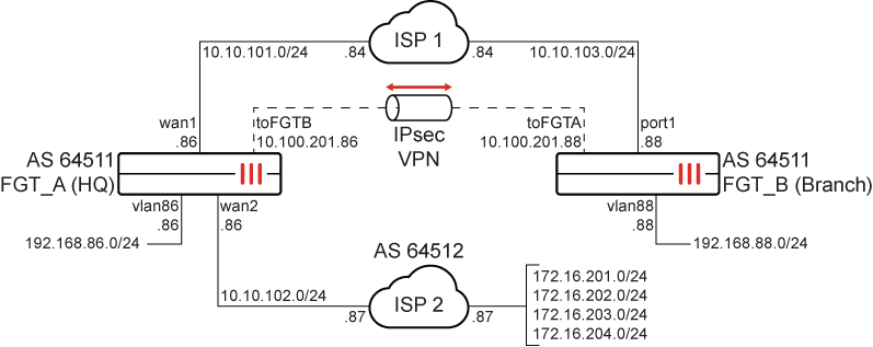

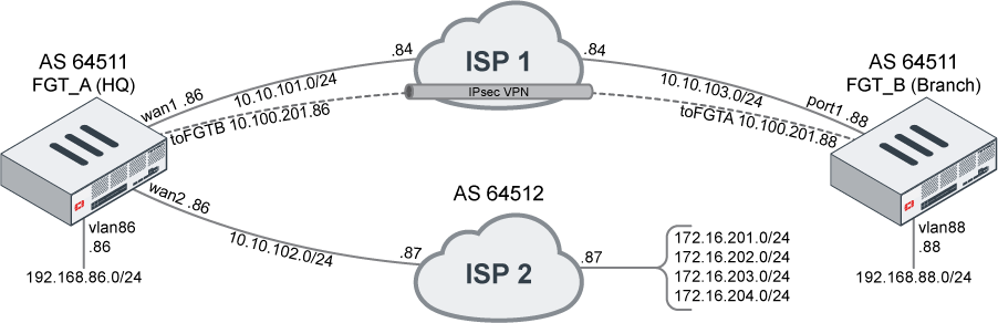

In this example, BGP is configured on two FortiGate devices. The FortiGates are geographically separated, and form iBGP peering over a VPN connection. FGT_A also forms eBGP peering with ISP2.
FGT_A learns routes from ISP2 and redistributes them to FGT_B while preventing any iBGP routes from being advertised.
The internal networks behind the FortiGates can communicate with each other, and the internal networks behind FGT_B can traverse FGT_A to reach networks that are advertised by ISP2.
  • FGT_A and FGT_B have static routes to each other through ISP1. ISP1 does not participate in BGP.
  • The IPsec VPN tunnel between FGT_A and FGT_B is configured with wildcard 0.0.0.0/0 networks for phase2 local and remote selectors. The VPN interfaces have IP addresses already configured and are used for peering between FGT_A and FGT_B.
  • FGT_A is configure to peer with ISP2 on 10.10.102.86.
  • The firewall policies between FGT_A and FGT_B are not NATed. The firewall policies egressing on wan2 are NATed.

Community Links
Basic BGP example
Basic BGP example
Configuring iBGP peering
To configure FGT_A to establish iBGP peering with FGT_B in the GUI:

To check the FGT_A and FGT_B peering:
  1. Check the BGP neighbors:
    # get router info bgp neighbors
  2. Check the networks learned from neighbors:
    # get router info bgp network
  3. Check that the routes are added to the routing table:
    # get router info routing-table all
To see the neighborship status, network, and routing table command outputs for the completed example, see Troubleshooting and debugging.

    Address family IPv6 Unicast: advertised and received
  Received 513 messages, 1 notifications, 0 in queue
  Sent 517 messages, 2 notifications, 0 in queue
  Route refresh request: received 0, sent 0
  Minimum time between advertisement runs is 30 seconds
 For address family: IPv4 Unicast
  BGP table version 5, neighbor version 0
  Index 3, Offset 0, Mask 0x8
  Community attribute sent to this neighbor (both)
  Outbound path policy configured
  Route map for outgoing advertisements is *exclude1root
  4 accepted prefixes, 4 prefixes in rib
  0 announced prefixes
 For address family: IPv6 Unicast
  BGP table version 1, neighbor version 0
  0 accepted prefixes, 0 prefixes in rib
 Connections established 4; dropped 3
Local host: 10.10.102.86, Local port: 20364
Foreign host: 10.10.102.87, Foreign port: 179
Nexthop: 10.10.102.86
Nexthop interface: wan2
Nexthop global: ::
Nexthop local: ::
BGP connection: non shared network
Last Reset: 01:54:42, due to BGP Notification sent
Notification Error Message: (CeaseUnspecified Error Subcode)
BGP neighbor is 10.100.201.88, remote AS 64511, local AS 64511, internal link
  BGP version 4, remote router ID 2.2.2.2
  BGP state = Established, up for 01:54:07
  Last read 00:00:11, hold time is 180, keepalive interval is 60 seconds
  Configured hold time is 180, keepalive interval is 60 seconds
  Neighbor capabilities:
    Route refresh: advertised and received (old and new)
    Address family IPv4 Unicast: advertised and received
  Received 527 messages, 3 notifications, 0 in queue
  Sent 543 messages, 8 notifications, 0 in queue
  Update source is toFGTB
  BGP table version 5, neighbor version 4
  Index 1, Offset 0, Mask 0x2
  NEXT_HOP is always this router
  1 accepted prefixes, 1 prefixes in rib
  5 announced prefixes
  BGP table version 1, neighbor version 1
 Connections established 7; dropped 6
Local host: 10.100.201.86, Local port: 179
Foreign host: 10.100.201.88, Foreign port: 6245
Nexthop: 10.100.201.86
Nexthop interface: toFGTB
Nexthop global: ::
Nexthop local: ::
Last Reset: 01:54:12, due to BGP Notification received
FGT_B # get router info bgp neighbors
VRF 0 neighbor table:
BGP neighbor is 10.100.201.86, remote AS 64511, local AS 64511, internal link
  BGP version 4, remote router ID 1.1.1.1
  BGP state = Established, up for 01:56:04
  Last read 00:00:48, hold time is 180, keepalive interval is 60 seconds
  Received 532 messages, 3 notifications, 0 in queue
  Sent 526 messages, 3 notifications, 0 in queue
  Update source is toFGTA
  BGP table version 4, neighbor version 3
  5 accepted prefixes, 5 prefixes in rib
  1 announced prefixes
Local host: 10.100.201.88, Local port: 6245
Foreign host: 10.100.201.86, Foreign port: 179
Nexthop: 10.100.201.88
Nexthop interface: toFGTA
Nexthop global: ::
Nexthop local: ::
Last Reset: 01:56:09, due to BGP Notification sent
# get router info bgp neighbors <neighbor's IP> can also be used to verify the status of a specific neighbor.
To verify the networks learned from neighbors or a specific network:
FGT_A # get router info bgp network
VRF 0 BGP table version is 5, local router ID is 1.1.1.1
Status codes: s suppressed, d damped, h history, * valid, > best, i - internal,
              S Stale
Origin codes: i - IGP, e - EGP, ? - incomplete
   Network          Next Hop            Metric LocPrf Weight RouteTag Path
*> 172.16.201.0/24  10.10.102.87             0             0        0 64512 i <-/1>
*> 172.16.202.0/24  10.10.102.87             0             0        0 64512 i <-/1>
*> 172.16.203.0/24  10.10.102.87             0             0        0 64512 i <-/1>
*> 172.16.204.0/24  10.10.102.87             0             0        0 64512 i <-/1>
*> 192.168.86.0     0.0.0.0                       100  32768        0 i <-/1>
*>i192.168.88.0     10.100.201.88            0    100      0        0 i <-/1>
Total number of prefixes 6
FGT_A # get router info bgp network 172.16.201.0
VRF 0 BGP routing table entry for 172.16.201.0/24
Paths: (1 available, best #1, table Default-IP-Routing-Table)
  Advertised to non peer-group peers:
   10.100.201.88
  Original VRF 0
  64512
    10.10.102.87 from 10.10.102.87 (192.168.2.87)
      Origin IGP metric 0, localpref 100, valid, external, best
      Last update: Tue Dec 15 22:52:08 2020
FGT_A # get router info bgp network 192.168.88.0
VRF 0 BGP routing table entry for 192.168.88.0/24
  Not advertised to any peer
  Original VRF 0
  Local
    10.100.201.88 from 10.100.201.88 (2.2.2.2)
      Origin IGP metric 0, localpref 100, valid, internal, best
      Last update: Tue Dec 15 22:52:39 2020
FGT_B # get router info bgp network
VRF 0 BGP table version is 4, local router ID is 2.2.2.2
              S Stale
*>i172.16.201.0/24  10.100.201.86            0    100      0        0 64512 i <-/1>
*>i172.16.202.0/24  10.100.201.86            0    100      0        0 64512 i <-/1>
*>i172.16.203.0/24  10.100.201.86            0    100      0        0 64512 i <-/1>
*>i172.16.204.0/24  10.100.201.86            0    100      0        0 64512 i <-/1>
*>i192.168.86.0     10.100.201.86            0    100      0        0 i <-/1>
*> 192.168.88.0     0.0.0.0                       100  32768        0 i <-/1>
To verify the routing tables on FGT_A and FGT_B:
FGT_A # get router info routing-table all
Codes: K - kernel, C - connected, S - static, R - RIP, B - BGP
       O - OSPF, IA - OSPF inter area
       N1 - OSPF NSSA external type 1, N2 - OSPF NSSA external type 2
       E1 - OSPF external type 1, E2 - OSPF external type 2
       i - IS-IS, L1 - IS-IS level-1, L2 - IS-IS level-2, ia - IS-IS inter area
       * - candidate default
Routing table for VRF=0
S*      0.0.0.0/0 [10/0] via 172.16.151.1, port1, [5/0]
                  [10/0] via 192.168.2.1, port2, [10/0]
C       10.10.101.0/24 is directly connected, wan1
C       10.10.102.0/24 is directly connected, wan2
S       10.10.103.0/24 [10/0] via 10.10.101.84, wan1
C       10.100.201.0/24 is directly connected, toFGTB
C       10.100.201.86/32 is directly connected, toFGTB
C       172.16.151.0/24 is directly connected, port1
B       172.16.201.0/24 [20/0] via 10.10.102.87, wan2, 02:09:50
B       172.16.202.0/24 [20/0] via 10.10.102.87, wan2, 02:09:50
B       172.16.203.0/24 [20/0] via 10.10.102.87, wan2, 02:09:50
B       172.16.204.0/24 [20/0] via 10.10.102.87, wan2, 02:09:50
C       192.168.2.0/24 is directly connected, port2
C       192.168.86.0/24 is directly connected, vlan86
B       192.168.88.0/24 [200/0] via 10.100.201.88, toFGTB, 02:09:19
FGT_B # get router info routing-table all
S*      0.0.0.0/0 [10/0] via 10.10.103.84, port1
C       10.10.103.0/24 is directly connected, port1
C       10.100.201.0/24 is directly connected, toFGTA
C       10.100.201.88/32 is directly connected, toFGTA
B       172.16.201.0/24 [200/0] via 10.100.201.86, toFGTA, 02:11:36
B       172.16.202.0/24 [200/0] via 10.100.201.86, toFGTA, 02:11:36
B       172.16.203.0/24 [200/0] via 10.100.201.86, toFGTA, 02:11:36
B       172.16.204.0/24 [200/0] via 10.100.201.86, toFGTA, 02:11:36
B       192.168.86.0/24 [200/0] via 10.100.201.86, toFGTA, 02:11:36
C       192.168.88.0/24 is directly connected, vlan88
