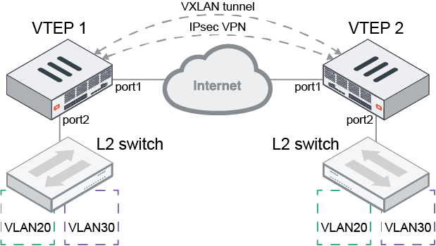

VXLAN between two VTEPs over IPsec
In scenarios where VTEPs are located in different sites and traffic must be secured between the sites, VXLAN will need to be encrypted over IPsec. The VXLAN interface must use the IPsec interface as its outgoing interface. The remote-ip must be configured as the IP of the remote IPsec gateway. The VXLAN interface can be combined with port2 into the same L2 network using a software switch or virtual wire pair. Devices under the L2 switches can communicate with each other.
See VXLAN over IPsec tunnel with virtual wire pair for an example configuration. A variation of this scenario is explained in FortiGate LAN extension and in FortiExtender as FortiGate LAN extension (FortiExtender FortiGate-Managed Administration Guide).

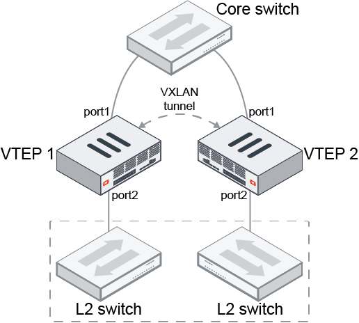

Basic VXLAN between two VTEPs
In this topology, a FortiGate (VTEP 1) is configured with a VXLAN interface over port1 where the remote-ip points to port1 of VTEP 2. The VXLAN interface and port2 can be associated with the same L2 network by making them members of either a software switch or a virtual wire pair. Devices under the L2 switches are part of the same L2 network.
See Virtual wire pair with VXLAN for an example configuration.

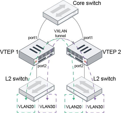

VXLAN between two VTEPs with wildcard VLANs
In this topology, a FortiGate (VTEP 1) is configured with a VXLAN interface over port1 where the remote-ip points to port1 of VTEP 2. The VXLAN interface is combined with port2 into the same L2 network using a virtual wire pair. The virtual wire pair allows wildcard VLANs to pass, which allows VLAN tags to be encapsulated over VXLAN. As a result, VLANs can span different switches over VXLAN.
Variations of these two scenarios can also be found in FortiGate to FortiSwitch FortiLink connections over VXLAN. See Deployment procedures in the FortiSwitch VXLAN Deployment Guide for example configurations.

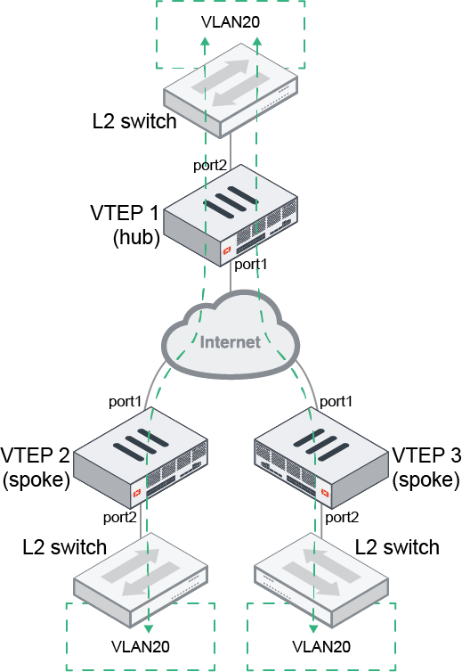

VXLAN between multiple VTEPs in an IPsec hub and spoke topology
In this topology, an IPsec VPN hub and spoke overlay network is already configured between sites. To allow networks behind the hub and spokes to be connected together, each spoke has a VXLAN connection to the hub, and the hub allows interconnection between its private network and each of the VXLAN interfaces to the spokes. In this scenario, the private networks behind each spoke are actually on the same L2 network as the private network behind the hub.
See VXLAN over IPsec using a VXLAN tunnel endpoint for an example configuration.
