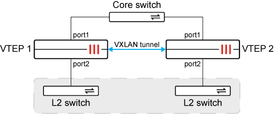

Topologies
Many topologies can be deployed with VXLAN. A FortiGate can connect to VXLAN endpoints that are Fortinet devices or devices from other vendors. In the following topologies, it is assumed that at least one of the VTEPs is a FortiGate. The second VTEP can be any vendor.
Basic VXLAN between two VTEPs
In this topology, a FortiGate (VTEP 1) is configured with a VXLAN interface over port1 where the remote-ip points to port1 of VTEP 2. The VXLAN interface and port2 can be associated with the same L2 network by making them members of either a software switch or a virtual wire pair. Devices under the L2 switches are part of the same L2 network.
See Virtual wire pair with VXLAN for an example configuration.
