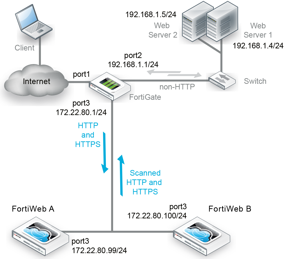

Example: Using WCCP with multiple FortiWeb appliances
You can use WCCP to create a high availability cluster in which both appliances are active (active-active). You synchronize the cluster members using FortiWeb's configuration synchronization feature so that each cluster member is ready to act as backup if the other appliance is not available. The WCCP server provides load balancing between the HA pair and redirects all traffic to one cluster member if the other member is unavailable.
To create this configuration, you first configure FortiWeb A and use the configuration synchronization feature to "push" the configuration to FortiWeb B. (See Replicating the configuration without FortiWeb HA (external HA).) You then complete the configuration for FortiWeb B. The Config-Synchronization feature does not synchronize the following configuration when the operating mode is WCCP:
  • System > Network > Interface
  • System > Network > Static Route
  • System > Network > Policy Route
  • System > Config > WCCP Client
  • Administrator accounts
  • Access profiles
  • HA settings
For detailed configuration settings for each FortiWeb, see Example: Using WCCP with FortiOS 5.2.x.
You can link the FortiGate and FortiWeb appliances in this topology without using a switch. Instead, you can link the FortiWeb appliances to FortiGate directly and use the following commands to create a switch on the firewall:
config system interface
edit "port3"
set vdom "root"
set vlanforward enable
set type physical
set alias "FortiWeb-A"
edit "port4"
set vdom "root"
set type physical
set alias "FortiWeb-B"
edit "WCCP_Server"
set vdom "root"
set ip 172.22.80.1 255.255.255.0
set allowaccess ping
set type switch
set wccp enable

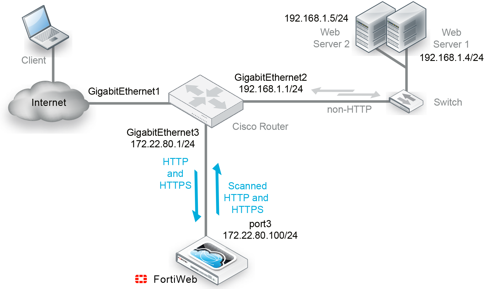

Example: Using WCCP with a Cisco router
You can use FortiWeb's WCCP feature to integrate it with third-party devices that support the WCCP protocol.
In this example, a router running Cisco IOS routes HTTP and HTTPS traffic destined for the back-end servers to a FortiWeb for scanning.
You create the WCCP server configuration using a series of Cisco IOS commands.
Because the WCCP configuration is standardized, FortiWeb can work interchangeably with different WCCP servers s long as they have the same WCCP configuration. Thus, theFortiWeb WCCP client configuration mostly the same as the one described in Example: Using WCCP with FortiOS 5.2.x.
Ciso IOS command examples
Specify WCCP version 2:
Router# config terminal
Router(config)# ip wccp version 2
Add the FortiWeb to the list of WCCP clients:
Router(config)# ip access-list extended wccp_client
Router (config-ext-nacl) # permit ip host 172.22.80.100 any
Router (config-ext-nacl) # exit
Configure a WCCP access list that routes HTTP and HTTPS requests for the subnet used by the back-end servers to FortiWeb:
Router(config)# ip access-list extended wccp_acl
Router (config-ext-nacl) # permit tcp any 192.168.1.0 0.0.0.255 eq www 443
Configure a service group that registers the router to the FortiWeb:
Router(config)# ip wccp source-interface GigabitEthernet3
Router(config)# ip wccp 52 redirect-list wccp_acl group-list wccp_client password 0 fortinet
Alternatively, you can register the router to a multicast address:
Router(config)# ip wccp 52 group-address 239.0.0.0 redirect-list wccp_acl password 0 123456
Enable packet redirection on the inbound interface using WCCP:
Router(config)# interface GigabitEthernet1
Router(config)# ip wccp 52 redirect in
Enable packet redirection on the outbound interface using WCCP:
Router(config)# interface GigabitEthernet2
Router(config)# ip wccp 52 redirect out
If the service group uses a multicast address, register the router to the multicast address you specified earlier (239.0.0.0):
Router(config)# ip multicast-routing distributed
Router(config)# interface GigabitEthernet3
Router(config)# ip wccp 52 group-listen
Router(config)# ip pim sparse-dense-mode
When the configuration is complete, check WCCP status:
Router#show ip wccp <service_id> detail
Router#debug ip wccp events
Router#debug ip wccp packets
FortiWeb WCCP configuration
The System > Config > WCCP Clientconfiguration for this example is different from the one described in Example: Using WCCP with FortiOS 5.2.x in the following two ways:
  • If the service group uses a multicast address, you specify a value for Group Address instead of for Router List.
  • You enable Authentication and specify a password.
Otherwise, network interface, WCCP client and server pool and policy configuration is the same as the one found in Example: Using WCCP with FortiOS 5.2.x.
  • Access profiles
  • HA settings
