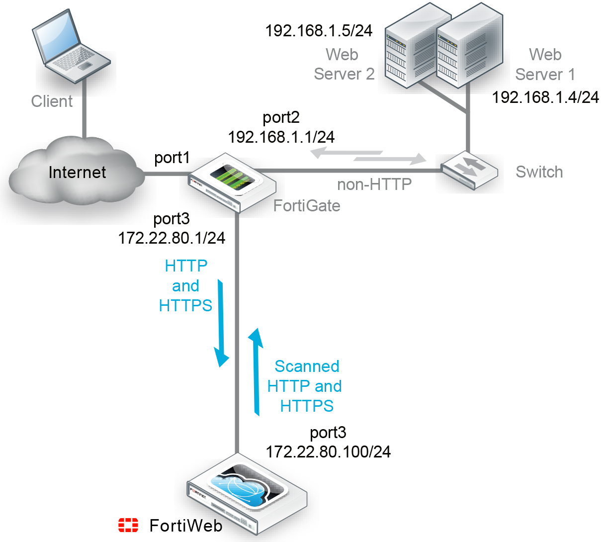

Example: Using WCCP with FortiOS 5.2.x
This configuration uses WCCP in a one-arm topology and WCCP to route HTTP and HTTP traffic to a FortiWeb for scanning before forwarding permitted traffic to the back-end servers.
The following command sets the IP address and enables WCCP for port3 on the firewall running FortiOS 5.2.x:
config system interface
edit "port3"
set ip 172.22.80.1 255.255.255.0
set wccp enable
On the firewall, the following command specifies a WCCP service group using a service group ID (52), the firewall interface that supports WCCP (172.22.80.1), and the interface the FortiWeb uses for WCCP communication (172.22.80.100).
config system wccp
edit "52"
set router-id 172.22.80.1
set server-list 172.22.80.100 255.255.255.0
The following firewall policies specify the traffic that FortiGate routes to the FortiWeb for scanning:
  • A port1 to port2 policy that accepts HTTP and HTTPS traffic and for which WCCP is enabled.
  • A port1 to port2 policy that accepts HTTP and HTTPS traffic and for which WCCP is not enabled. This policy maintains traffic flow when the WCCP client is not available (for example, if FortiWeb is rebooting).
  • A port3 to port2 policy that accepts scanned HTTP and HTTPS traffic from the FortiWeb.
config firewall policy
set srcintf "Port1"
set dstintf "Port2"
set srcaddr "all"
set dstaddr "192.168.1.4" "192.168.1.5"
set service "HTTP" "HTTPS"
set wccp enable
set srcintf "Port1"
set dstintf "Port2"
set srcaddr "all"
edit 3
set srcintf "Port3"
set dstintf "Port2"
set srcaddr "all"
WCCP is enabled for the interface that connects FortiWeb to the firewall.
The WCCP client configuration on FortiWeb adds it to the WCCP service group 52, specifies the interface used for WCCP client functionality (172.22.80.100) and the WCCP server (172.22.80.1).
The destination servers are members of a WCCP server pool. This pool is selected in the WCCP Servers server policy that FortiWeb applies to the traffic it receives from the firewall via WCCP.
Example: Using WCCP with FortiOS 5.4
You can use the commands and settings described in Example: Using WCCP with FortiOS 5.2.x to create that same configuration with a firewall running FortiOS 5.4.
However, FortiOS 5.4 also allows you to configure WCCP communication with FortiWeb using its External Security Devices settings. This example creates the same environment as Example: Using WCCP with FortiOS 5.2.x.
FortiGate configuration:
  • WCCP is enabled for port3 on the firewall running FortiOS 5.4 (172.22.80.1).
  • In System > External Security Devices, HTTP Service is enabled. For FortiWeb IPs, the FortiWeb acting as a WCCP client is specified.
  • The service ID is 51. This is the only service ID that the firewall can use for WCCP clients configured using the web UI.
  • In the Security Profiles > Web Application Firewall settings, for Inspection Device, select External.
  • In the Policy & Objects > IPv4 Policy settings, configure a policy for which Web Application Firewall is enabled.
  • A second policy for which Web Application Firewall is not enabled to maintain traffic flow when the WCCP client is not available
  • A third policy accepts scanned HTTP and HTTPS traffic from the FortiWeb.
FortiWeb configuration:
Configuration is the same as Example: Using WCCP with FortiOS 5.2.x, except the service ID value is 51. This is the only service ID value you can use when you configure WCCP communication using the FortiOS 5.4 External Security Devices settings.

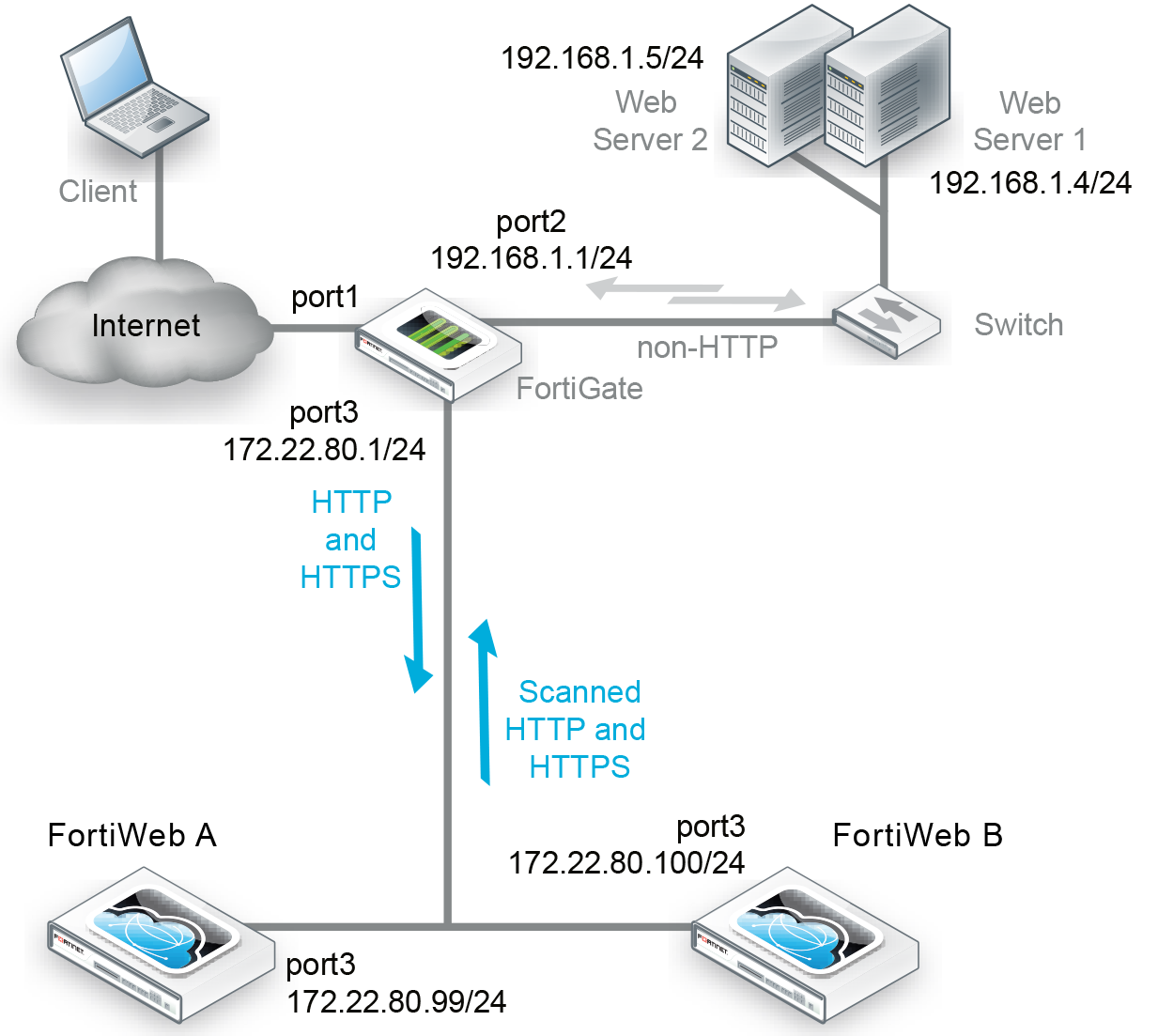

Example: Using WCCP with multiple FortiWeb appliances
You can use WCCP to create a high availability cluster in which both appliances are active (active-active). You synchronize the cluster members using FortiWeb's configuration synchronization feature so that each cluster member is ready to act as backup if the other appliance is not available. The WCCP server provides load balancing between the HA pair and redirects all traffic to one cluster member if the other member is unavailable.
To create this configuration, you first configure FortiWeb A and use the configuration synchronization feature to "push" the configuration to FortiWeb B. (See Replicating the configuration without FortiWeb HA (external HA).) You then complete the configuration for FortiWeb B. The Config-Synchronization feature does not synchronize the following configuration when the operating mode is WCCP:
  • Network > Interface
  • Network > Static Route
  • Network > Policy Route
  • System > Config > WCCP Client
  • Administrator accounts
  • Access profiles
  • HA settings
For detailed configuration settings for each FortiWeb, see Example: Using WCCP with FortiOS 5.2.x.
You can link the FortiGate and FortiWeb appliances in this topology without using a switch. Instead, you can link the FortiWeb appliances to FortiGate directly and use the following commands to create a switch on the firewall:
edit "port3"
set vdom "root"
set vlanforward enable
set type physical
set alias "FortiWeb-A"
edit "port4"
set vdom "root"
set type physical
set alias "FortiWeb-B"
edit "WCCP_Server"
set vdom "root"
set allowaccess ping
set type switch
set wccp enable

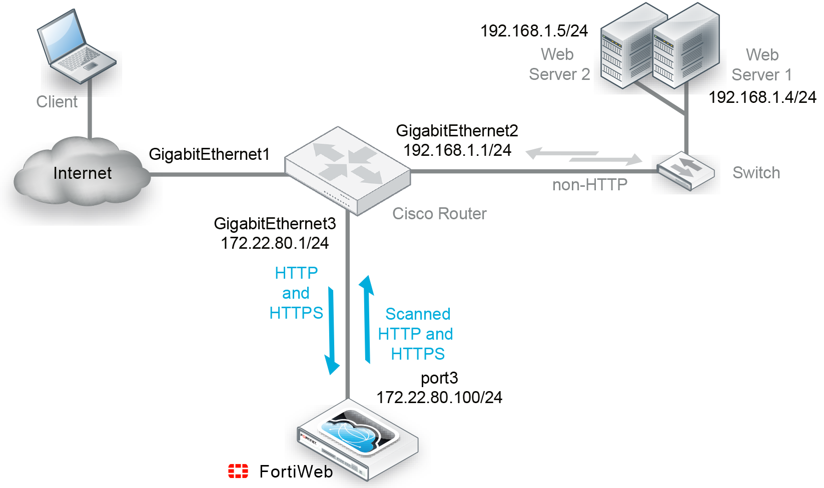

Example: Using WCCP with a Cisco router
You can use FortiWeb's WCCP feature to integrate it with third-party devices that support the WCCP protocol.
In this example, a router running Cisco IOS routes HTTP and HTTPS traffic destined for the back-end servers to a FortiWeb for scanning.
You create the WCCP server configuration using a series of Cisco IOS commands.
Because the WCCP configuration is standardized, FortiWeb can work interchangeably with different WCCP servers s long as they have the same WCCP configuration. Thus, theFortiWeb WCCP client configuration mostly the same as the one described in Example: Using WCCP with FortiOS 5.2.x.
Ciso IOS command examples
Specify WCCP version 2:
Router# config terminal
Router(config)# ip wccp version 2
Add the FortiWeb to the list of WCCP clients:
Router(config)# ip access-list extended wccp_client
Router (config-ext-nacl) # permit ip host 172.22.80.100 any
Router (config-ext-nacl) # exit
Configure a WCCP access list that routes HTTP and HTTPS requests for the subnet used by the back-end servers to FortiWeb:
Router(config)# ip access-list extended wccp_acl
Router (config-ext-nacl) # permit tcp any 192.168.1.0 0.0.0.255 eq www 443
Configure a service group that registers the router to the FortiWeb:
Router(config)# ip wccp source-interface GigabitEthernet3
Router(config)# ip wccp 52 redirect-list wccp_acl group-list wccp_client password 0 fortinet
Alternatively, you can register the router to a multicast address:
Router(config)# ip wccp 52 group-address 239.0.0.0 redirect-list wccp_acl password 0 123456
Enable packet redirection on the inbound interface using WCCP:
Router(config)# interface GigabitEthernet1
Router(config)# ip wccp 52 redirect in
Enable packet redirection on the outbound interface using WCCP:
Router(config)# interface GigabitEthernet2
Router(config)# ip wccp 52 redirect out
If the service group uses a multicast address, register the router to the multicast address you specified earlier (239.0.0.0):
Router(config)# ip multicast-routing distributed
Router(config)# interface GigabitEthernet3
Router(config)# ip wccp 52 group-listen
Router(config)# ip pim sparse-dense-mode
When the configuration is complete, check WCCP status:
Router#show ip wccp <service_id> detail
Router#debug ip wccp events
Router#debug ip wccp packets
FortiWeb WCCP configuration
The System > Config > WCCP Clientconfiguration for this example is different from the one described in Example: Using WCCP with FortiOS 5.2.x in the following two ways:
  • If the service group uses a multicast address, you specify a value for Group Address instead of for Router List.
  • You enable Authentication and specify a password.
Otherwise, network interface, WCCP client and server pool and policy configuration is the same as the one found in Example: Using WCCP with FortiOS 5.2.x.
edit "port3"
set wccp enable
config system wccp
edit "52"
  • Access profiles
  • HA settings
edit "port3"
set vdom "root"
set type physical
edit "port4"
set vdom "root"
set type physical
edit "WCCP_Server"
set vdom "root"
set type switch
set wccp enable
