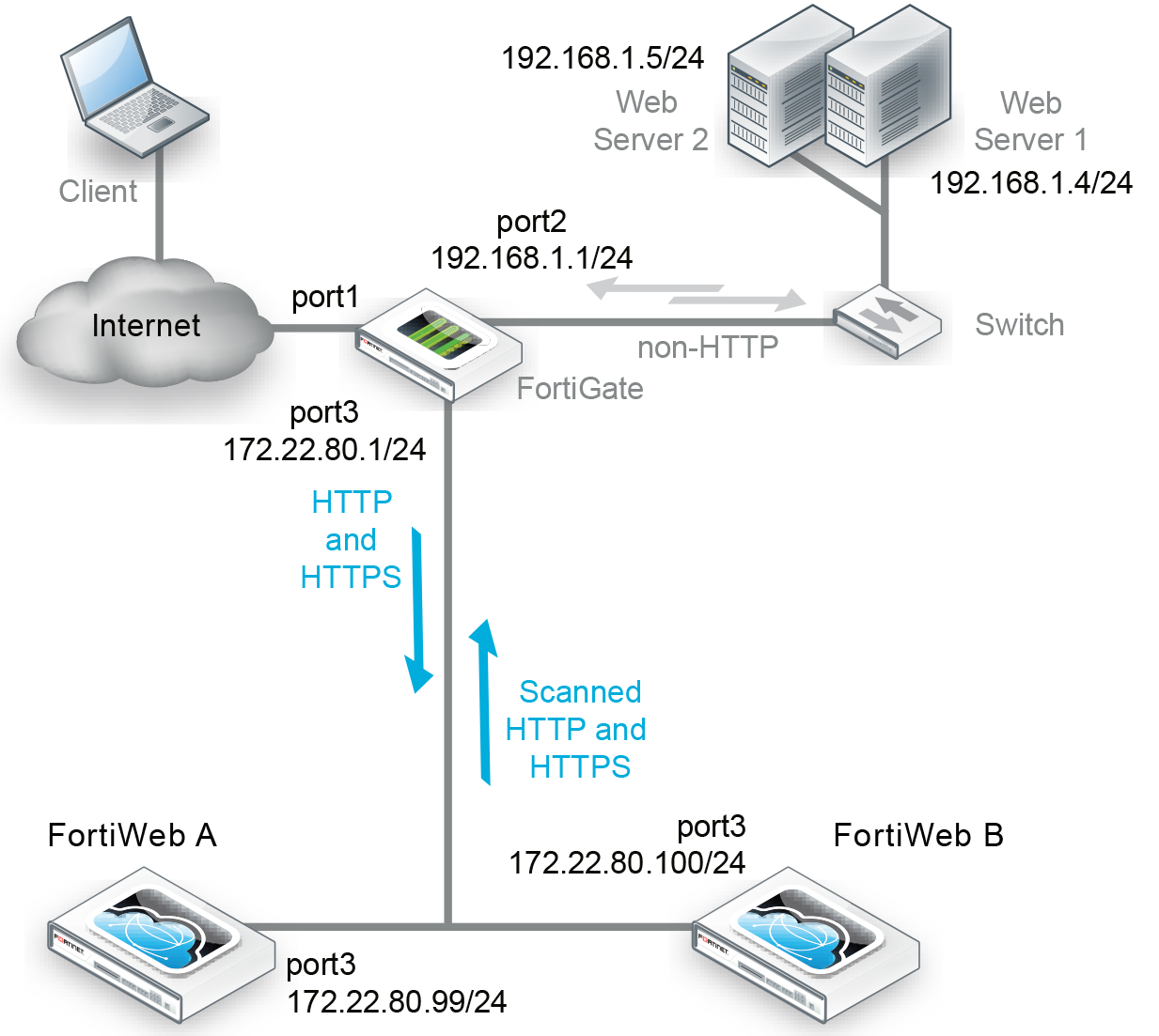

Example: Using WCCP with FortiOS 5.4
You can use the commands and settings described in Example: Using WCCP with FortiOS 5.2.x to create that same configuration with a firewall running FortiOS 5.4.
However, FortiOS 5.4 also allows you to configure WCCP communication with FortiWeb using its External Security Devices settings. This example creates the same environment as Example: Using WCCP with FortiOS 5.2.x.
FortiGate configuration:
  • WCCP is enabled for port3 on the firewall running FortiOS 5.4 (172.22.80.1).
  • In System > External Security Devices, HTTP Service is enabled. For FortiWeb IPs, the FortiWeb acting as a WCCP client is specified.
  • The service ID is 51. This is the only service ID that the firewall can use for WCCP clients configured using the web UI.
  • In the Security Profiles > Web Application Firewall settings, for Inspection Device, select External.
  • In the Policy & Objects > IPv4 Policy settings, configure a policy for which Web Application Firewall is enabled.
  • A second policy for which Web Application Firewall is not enabled to maintain traffic flow when the WCCP client is not available
  • A third policy accepts scanned HTTP and HTTPS traffic from the FortiWeb.
FortiWeb configuration:
Configuration is the same as Example: Using WCCP with FortiOS 5.2.x, except the service ID value is 51. This is the only service ID value you can use when you configure WCCP communication using the FortiOS 5.4 External Security Devices settings.
Example: Using WCCP with multiple FortiWeb appliances
You can use WCCP to create a high availability cluster in which both appliances are active (active-active). You synchronize the cluster members using FortiWeb's configuration synchronization feature so that each cluster member is ready to act as backup if the other appliance is not available. The WCCP server provides load balancing between the HA pair and redirects all traffic to one cluster member if the other member is unavailable.
To create this configuration, you first configure FortiWeb A and use the configuration synchronization feature to "push" the configuration to FortiWeb B. (See Replicating the configuration without FortiWeb HA (external HA).) You then complete the configuration for FortiWeb B. The Config-Synchronization feature does not synchronize the following configuration when the operating mode is WCCP:
  • System > Network > Interface
  • System > Network > Static Route
  • System > Network > Policy Route
  • System > Config > WCCP Client
  • Administrator accounts
  • Access profiles
  • HA settings
For detailed configuration settings for each FortiWeb, see Example: Using WCCP with FortiOS 5.2.x.
You can link the FortiGate and FortiWeb appliances in this topology without using a switch. Instead, you can link the FortiWeb appliances to FortiGate directly and use the following commands to create a switch on the firewall:
config system interface
edit "port3"
set vdom "root"
set vlanforward enable
set type physical
set alias "FortiWeb-A"
edit "port4"
set vdom "root"
set type physical
set alias "FortiWeb-B"
edit "WCCP_Server"
set vdom "root"
set ip 172.22.80.1 255.255.255.0
set allowaccess ping
set type switch
set wccp enable
This configuration uses WCCP in a one-arm topology and WCCP to route HTTP and HTTP traffic to a FortiWeb for scanning before forwarding permitted traffic to the back-end servers.
The following command sets the IP address and enables WCCP for port3 on the firewall running FortiOS 5.2.x:
edit "port3"
set wccp enable
On the firewall, the following command specifies a WCCP service group using a service group ID (52), the firewall interface that supports WCCP (172.22.80.1), and the interface the FortiWeb uses for WCCP communication (172.22.80.100).
config system wccp
edit "52"
set router-id 172.22.80.1
set server-list 172.22.80.100 255.255.255.0
The following firewall policies specify the traffic that FortiGate routes to the FortiWeb for scanning:
  • A port1 to port2 policy that accepts HTTP and HTTPS traffic and for which WCCP is enabled.
  • A port1 to port2 policy that accepts HTTP and HTTPS traffic and for which WCCP is not enabled. This policy maintains traffic flow when the WCCP client is not available (for example, if FortiWeb is rebooting).
  • A port3 to port2 policy that accepts scanned HTTP and HTTPS traffic from the FortiWeb.
config firewall policy

WCCP is enabled for the interface that connects FortiWeb to the firewall.
The WCCP client configuration on FortiWeb adds it to the WCCP service group 52, specifies the interface used for WCCP client functionality (172.22.80.100) and the WCCP server (172.22.80.1).
The destination servers are members of a WCCP server pool. This pool is selected in the WCCP Servers server policy that FortiWeb applies to the traffic it receives from the firewall via WCCP.
  • Access profiles
  • HA settings

edit "WCCP_Server"
set vdom "root"
set type switch
set wccp enable
