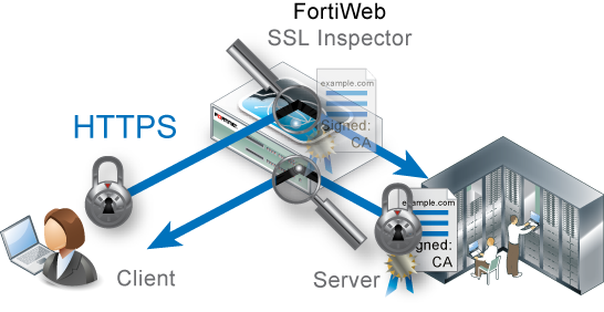

However, depending on the operation mode, FortiWeb is not always an SSL terminator.
By their asynchronous nature, SSL termination cannot be supported in Transparent Inspection and Offline Protection modes. To terminate, FortiWeb must process traffic synchronously with the connection state. In those modes, the web server uses its own certificate, and acts as its own SSL terminator. The web server bears the load for SSL processing. FortiWeb only “listens in” and can interrupt the connection, but otherwise cannot change or reroute packets.
In those modes, FortiWeb only uses the web server’s certificate to decrypt traffic in order to scan it for policy violations. If there are no violations, it allows the existing encrypted traffic to continue without interruption. FortiWeb does not expend CPU and resources to re-encrypt, because it is not a terminator.
In other words, FortiWeb performs SSL inspection, not SSL offloading.
