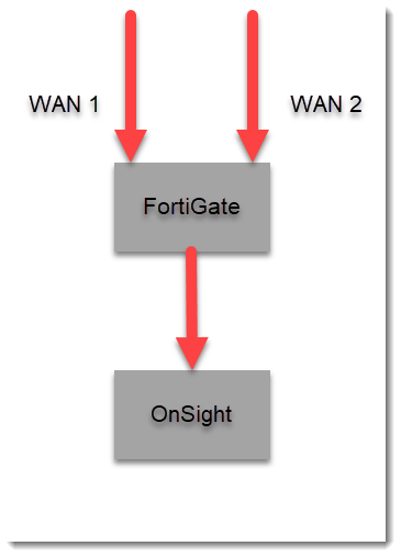

SD-WAN underlay monitoring is achieved by assigning additional IP addresses to the OnSight, one per underlay, which are then routed out through the FortiGate using a single underlay. Synthetic checks will then be automatically configured to originate from each of the source IPs in order to test each underlay.
To set up monitoring, you need to create a reserved IP on the FortiGate for each of the underlays. These need to exist within the same subnet as the primary OnSight IP (but are separate addresses from the primary OnSight IP) and not already in use by another device on your network.
After assigning the IPs on the FortiGate according to the instructions below, they will be automatically added and configured on the OnSight.

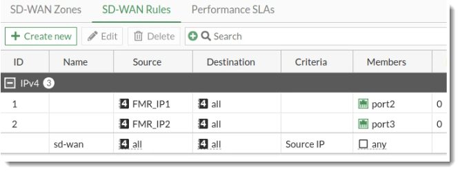

Create SD-WAN rules
SD-WAN rules must first be set up to use SD-WAN synthetic monitoring. A specific IP address is needed for each WAN connection.
In this step we will create a manual SD-WAN rule to steer each OnSight IPs monitoring traffic through its respective WAN underlay.
  • OnSight monitoring traffic will be marked using the agent-exclusive command. This command marks traffic as FortiMonitor health checks.
  • Each OnSight firewall object will be manually steered to its respective WAN underlay.
  1. Launch the CLI console.
  2. Enter the following command to create the SD-WAN rules:
    Copy
    config system sdwan
    config service
    set dst "all"
    set src "FMR_IP1"
    set priority-members 1
    set agent-exclusive enable
    set dst "all"
    set src "FMR_IP2"
    set priority-members 2
Note: The command set agent-exclusive enable is a FortiOS dependency of 7.2.4 or later.
In this example, rules 1 and 2 are used but you may configure any available rule ID.
The Source (src) and Destination (dst) parameters are used to identify traffic. If the traffic is from a specific source address ,its associated SD-WAN rule will be used. See SD-WAN rules overview for more information.
Note that the SD-WAN rules created for SD-WAN synthetic monitoring must be set to the highest priority. You can do this by dragging the rules to the top of the list.

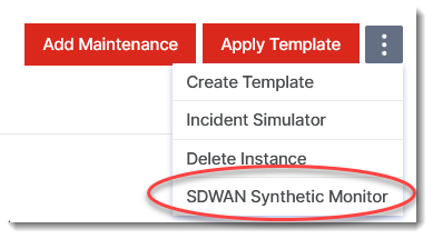

    • If there are no issues, the SD-WAN synthetic monitoring menu option will be enabled.
    • After enabling SD-WAN synthetic monitoring. the OnSight will then assign the additional IP addresses.
  2. Open the FortiGate details page in the Control Panel.
  3. Click SD-WAN Synthetic Monitor.
  4. On the modal that appears, click Enable SDWAN Synthetic Monitor.

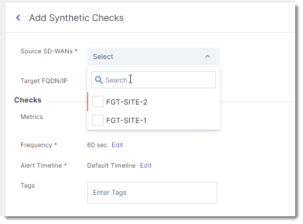

Add SD-WAN monitoring to an application
  1. Go to Monitoring > Application.
  2. Select the application where you want to add SD-WAN monitoring.
  3. Select Locations.
  4. Select Add Locations > SD-WAN Devices.
  5. In the Source SD-WANs drop-down field, select the FortiGate you configured.
  6. Click Save.
