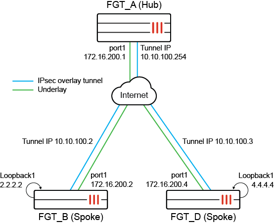

In this example, the hub is configured as a VPN dial-up server and both of the spokes are connected to the hub. It is assumed that the VPN configuration is already done, with a dynamic gateway type and kernel device creation (net-device) disabled. Only one SD-WAN interface is used, so there is only one VPN overlay member in the SD-WAN zone. Multiple WAN interfaces and VPN overlays could be used.
The VPN interfaces and IP addresses are:

A recurring speed test is configured that runs on the hub over the dial-up interfaces. The speed tests are performed over the underlay interface from the hub to the spoke. Each spoke is configured to operate as a speed test server and to allow the speed test to run on its underlay interface. The spokes establish BGP peering with the hub over the VPN interface, and advertises its loopback network to the hub. The specific configuration is only shown for FGT_B.
When the speed test is running, routing through the VPN overlay can be bypassed, and route maps are used to filter the routes that are advertised to peers. The spoke's route map does not advertise any routes to the peer, forcing the hub to use others paths to reach the spoke's network.
When no speed tests are running, the spoke's route map allows its network to be advertised on the hub.
When the speed test is complete, the measured egress bandwidth is dynamically applied to the VPN tunnel on the hub, and the result is cached for future use, in case the tunnel is disconnected and reconnected again.
