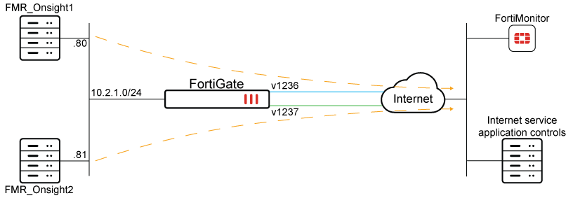

In this example, routing is achieved through SD-WAN rules. The agent-based health check detection mode creates the FortiMonitor IP address and FortiGate SD-WAN interface map.
This example assumes that the FortiMonitor has already been added to the Security Fabric (see Configuring FortiMonitor for detailed instructions). The FortiMonitor OnSight (client) can be configured for two or more IP addresses, and each IP address is capable of sending application probes to user-specified applications.
Specific routing is implemented on the FortiGate to ensure each FortiMonitor client collects performance statistics for only one SD-WAN member interface. The FortiMonitor is configured to send application-specific probes to measure that application’s performance on a given SD-WAN member. The FortiGate uses the FortiMonitor performance statistics to determine link quality based on application performance by mapping the health check. The link quality for a given application can then be used to steer the matching application traffic with greater accuracy.
