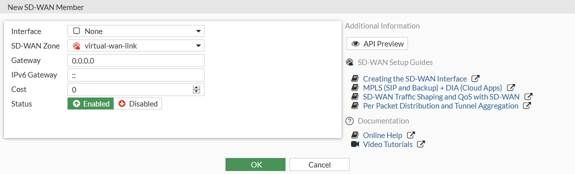

To create the SD-WAN members in the GUI:
- Go to Network > SD-WAN, select the SD-WAN Zones tab, and click Create New > SD-WAN Member.
- Leave all the settings set to their default values and click OK.
- Repeat the above steps to create a second member.

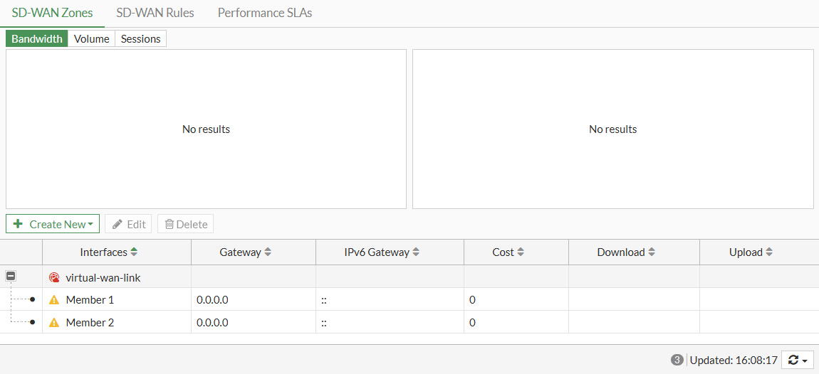

The empty members are listed on the SD-WAN Zones tab.
The members are disabled until interfaces are configured, but can still be used in performance SLAs and SD-WAN rules.

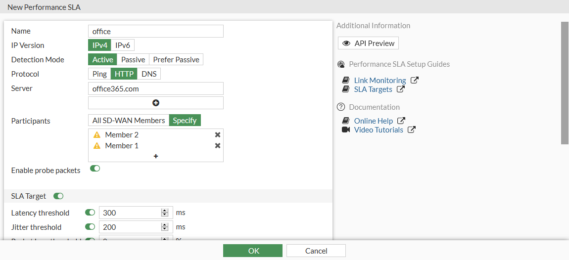

To create a performance SLA in the GUI:
- Go to Network > SD-WAN and select the Performance SLAs tab.
- Click Create New.
- Configure the performance SLA, specifying the empty members as participants.
- Click OK.

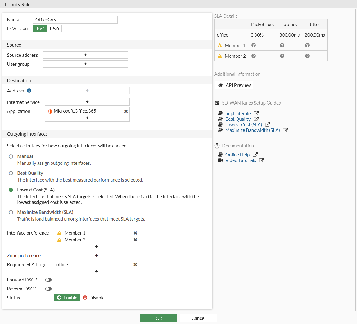

To create an SD-WAN rule in the GUI:
- Go to Network > SD-WAN, select the SD-WAN Rules tab, and click Create New.
- Configure the rule, adding both members to the Interface preference field:
- Click OK.

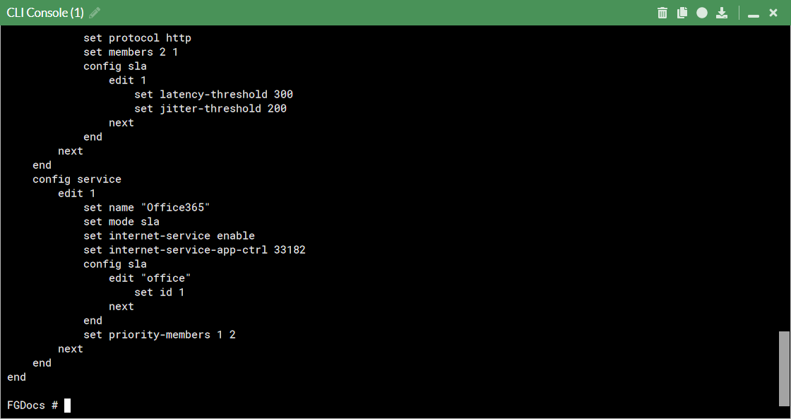

To configure the SD-WAN in the CLI:
- Create SD-WAN members:
config system sdwan set status enable config members edit 1 next edit 2 next end end - Create a health check (performance SLA):
config system sdwan config health-check edit "office" set server "office365.com" set protocol http set sla-fail-log-period 300 set sla-pass-log-period 300 set members 2 1 config sla edit 1 set latency-threshold 300 set jitter-threshold 200 next edit 2 set link-cost-factor latency set latency-threshold 20 next end next end end - Create a service (rule):
config system sdwan config service edit 3 set name "Office365" set mode sla set internet-service enable set internet-service-app-ctrl 33182 config sla edit "office" set id 2 next end set priority-members 1 2 next end endThe SD-WAN configuration can now be used in as a template for new spokes, as in Example 2.

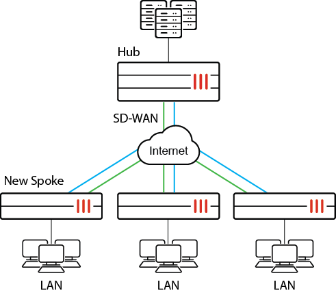

Example 2
In this example, the configuration from Example 1 is copied onto a new FortiGate.

- Enter the following command:
show system sdwan
- Either click Download and open the file in a text editor, or click Copy to clipboard and paste the content into a text editor.
