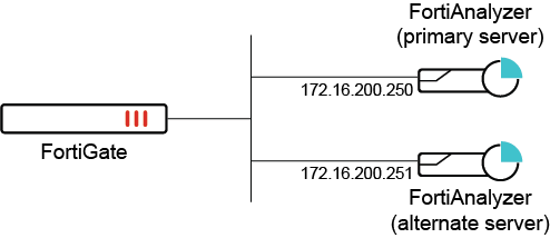

To configure switching to an alternate FortiAnalyzer when the main FortiAnalyzer is unavailable:
Ensure the FortiAnalyzer units are operating in geo-redundant HA mode. See Geo-redundant HA for more information.
Configure primary and alternate FortiAnalyzer servers:
config log fortianalyzer setting set status enable set server "172.16.200.250" set alt-server "172.16.200.251" set fallback-to-primary enable set serial "FAZ-VMTM22000000" "FAZ-VMTM23000003" end -
Verify the primary and alternate FortiAnalyzer server IPs:
# diagnose test application fgtlogd 1 vdom-admin=1 mgmt=vdom1 fortilog: faz: global , enabled server=172.16.200.250, alt-server=172.16.200.251, active-server=172.16.200.250, realtime=3, ssl=1, state=connected server_log_status=Log is allowed., src=, mgmt_name=FGh_Log_vdom1_172.16.200.250, reliable=0, sni_prefix_type=none, required_entitlement=none, region=ca-west-1, logsync_enabled:1, logsync_conn_id:65535, seq_no:0 disconnect_jiffies:0 status: ver=6, used_disk=0, total_disk=0, global=0, vfid=0 conn_verified=Y SNs: last sn update:11 seconds ago. Sn list: (FAZ-VMTM22000000,age=11s) (FAZ-VMTM23000003,age=12s) queue: qlen=0. filter: severity=6, sz_exclude_list=0 traffic virus webfilter ips emailfilter anomaly voip dlp app-ctrl waf dns ssh ssl file-filter icap sctp-filter virtual-patch subcategory: traffic: forward local multicast sniffer ztna virus:all subcategories are enabled. webfilter:all subcategories are enabled. ips:all subcategories are enabled. emailfilter:all subcategories are enabled. anomaly:all subcategories are enabled. voip:all subcategories are enabled. dlp:all subcategories are enabled. app-ctrl:all subcategories are enabled. waf:all subcategories are enabled. dns:all subcategories are enabled. ssh:all subcategories are enabled. ssl:all subcategories are enabled. file-filter:all subcategories are enabled. icap:all subcategories are enabled. sctp-filter:all subcategories are enabled. virtual-patch:all subcategories are enabled. server: global, id=0, ready=1, name=172.16.200.250 addr=172.16.200.250:514 oftp-state=connected primary oftp status:null probe oftp status:null, 442The 172.16.200.250 server is currently active and acting as the primary FortiAnalyzer.
Make the primary FortiAnalyzer server go down. The FortiGate will automatically connect to the alternate FortiAnalyzer server.
Verify the FortiAnalyzer server status information:
# diagnose test application fgtlogd 1 vdom-admin=1 mgmt=vdom1 fortilog: faz: global , enabled server=172.16.200.250, alt-server=172.16.200.251, active-server=172.16.200.251, realtime=3, ssl=1, state=connected server_log_status=Log is allowed., src=, mgmt_name=FGh_Log_vdom1_172.16.200.250, reliable=0, sni_prefix_type=none, required_entitlement=none, region=ca-west-1, logsync_enabled:1, logsync_conn_id:65535, seq_no:0 disconnect_jiffies:0 status: ver=6, used_disk=0, total_disk=0, global=0, vfid=0 conn_verified=Y SNs: last sn update:30 seconds ago. Sn list: (FAZ-VMTM22000000,age=30s) (FAZ-VMTM23000003,age=31s) queue: qlen=0. filter: severity=6, sz_exclude_list=0 traffic virus webfilter ips emailfilter anomaly voip dlp app-ctrl waf dns ssh ssl file-filter icap sctp-filter virtual-patch subcategory: traffic: forward local multicast sniffer ztna virus:all subcategories are enabled. webfilter:all subcategories are enabled. ips:all subcategories are enabled. emailfilter:all subcategories are enabled. anomaly:all subcategories are enabled. voip:all subcategories are enabled. dlp:all subcategories are enabled. app-ctrl:all subcategories are enabled. waf:all subcategories are enabled. dns:all subcategories are enabled. ssh:all subcategories are enabled. ssl:all subcategories are enabled. file-filter:all subcategories are enabled. icap:all subcategories are enabled. sctp-filter:all subcategories are enabled. virtual-patch:all subcategories are enabled. server: global, id=0, ready=1, name=172.16.200.250 addr=172.16.200.250:514 oftp-state=connected probe oftp status:null, 38The 172.16.200.251 server is currently active and acting as the primary FortiAnalyzer.
Restore the connection to the 172.16.200.250 server. The FortiGate will automatically reconnect to this FortiAnalyzer server.
# diagnose test application fgtlogd 1 vdom-admin=1 mgmt=vdom1 fortilog: faz: global , enabled server=172.16.200.250, alt-server=172.16.200.251, active-server=172.16.200.250, realtime=3, ssl=1, state=connected server_log_status=Log is allowed., src=, mgmt_name=FGh_Log_vdom1_172.16.200.250, reliable=0, sni_prefix_type=none, required_entitlement=none, region=ca-west-1, logsync_enabled:1, logsync_conn_id:65535, seq_no:0 disconnect_jiffies:0 status: ver=6, used_disk=0, total_disk=0, global=0, vfid=0 conn_verified=Y SNs: last sn update:11 seconds ago. Sn list: (FAZ-VMTM22000000,age=58s) (FAZ-VMTM23000003,age=59s) queue: qlen=0. filter: severity=6, sz_exclude_list=0 traffic virus webfilter ips emailfilter anomaly voip dlp app-ctrl waf dns ssh ssl file-filter icap sctp-filter virtual-patch subcategory: traffic: forward local multicast sniffer ztna virus:all subcategories are enabled. webfilter:all subcategories are enabled. ips:all subcategories are enabled. emailfilter:all subcategories are enabled. anomaly:all subcategories are enabled. voip:all subcategories are enabled. dlp:all subcategories are enabled. app-ctrl:all subcategories are enabled. waf:all subcategories are enabled. dns:all subcategories are enabled. ssh:all subcategories are enabled. ssl:all subcategories are enabled. file-filter:all subcategories are enabled. icap:all subcategories are enabled. sctp-filter:all subcategories are enabled. virtual-patch:all subcategories are enabled. server: global, id=0, ready=1, name=172.16.200.250 addr=172.16.200.250:514 oftp-state=connected primary oftp status:null probe oftp status:null, 530The 172.16.200.250 server is currently active and acting as the primary FortiAnalyzer again.
