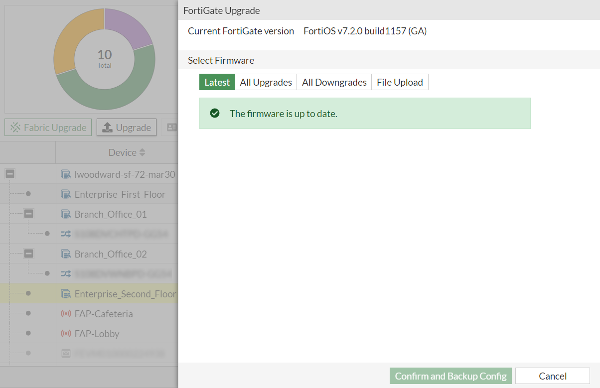

To downgrade to a previous firmware version in the GUI:
  1. Log into the FortiGate GUI as the admin administrative user.
  2. Go to System > Firmware & Registration. The Firmware Version column displays the version and either (Feature) or (Mature).
  3. Select the FortiGate, and click Upgrade. The FortiGate Upgrade pane opens.

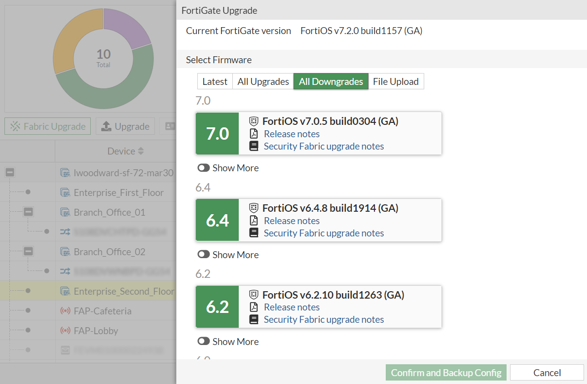

  4. Click one of the following tabs to select a downgrade method:
    All Downgrades
    Click the All Downgrades tab to view and select all firmware versions that are available from FortiGuard for downgrade.
    File Upload
    Click the File Upload tab to upload a firmware file that you previously downloaded from the Fortinet Customer Service & Support website.
    See Downloading a firmware image.
    In this example, the All Downgrades tab is selected.
  5. Select a firmware version and click Confirm and Backup Config. A warning message is displayed.
  6. Click Continue to continue with the downgrade.
    The FortiGate unit backs up the current configuration to the management computer, uploads the firmware image file, downgrades to the firmware version, and restarts. This process takes a few minutes.
