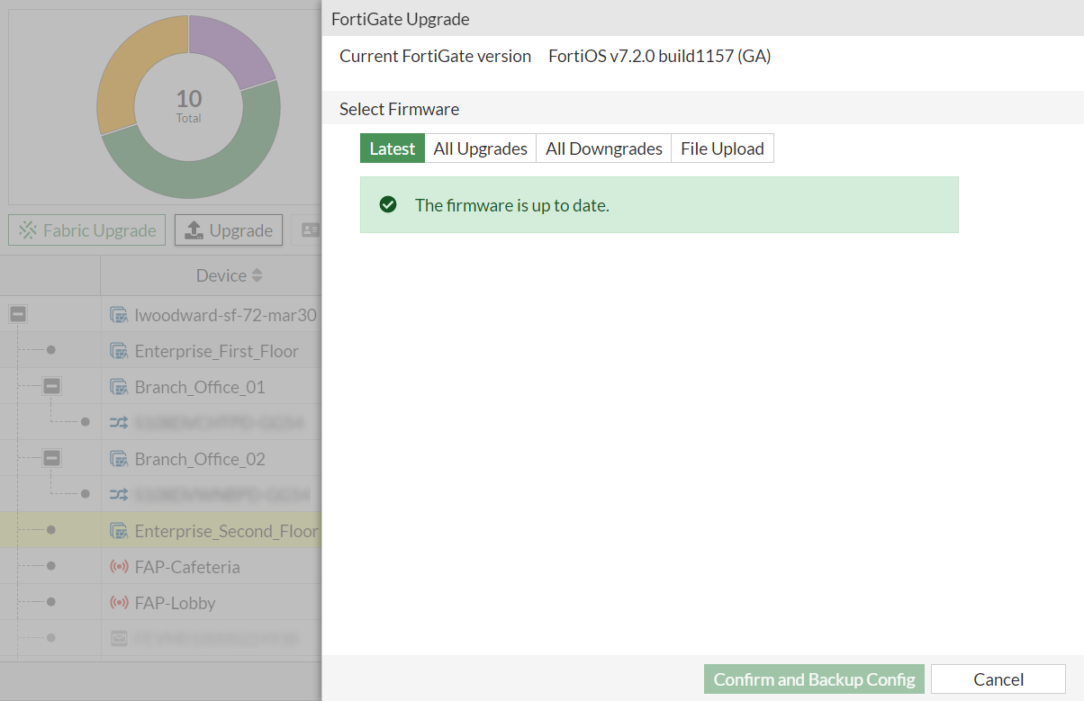

- Go to System > Fabric Management. The Firmware Version column displays the version and either (Feature) or (Mature).
- Select the FortiGate, and click Upgrade. The FortiGate Upgrade pane opens.
- Click one of the following tabs to select a downgrade method:

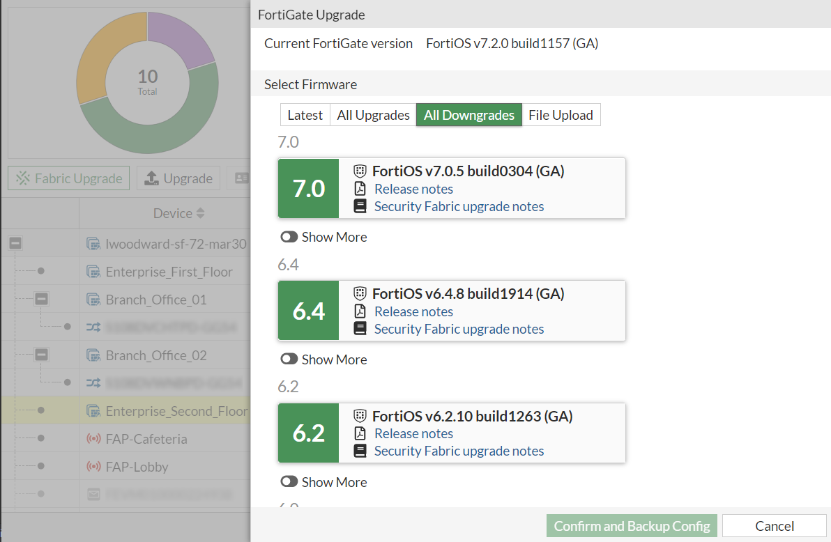

All Downgrades
Click the All Downgrades tab to view and select all firmware versions that are available from FortiGuard for downgrade.

In this example, the All Downgrades tab is selected.
- Select a firmware version and click Confirm and Backup Config. A warning message is displayed.
- Click Continue to continue with the downgrade.
