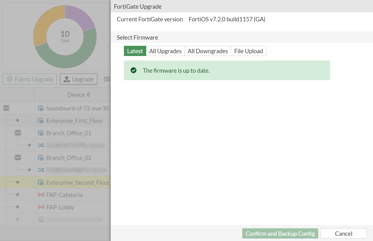

- Select the FortiGate, and click Upgrade. The FortiGate Upgrade pane opens.

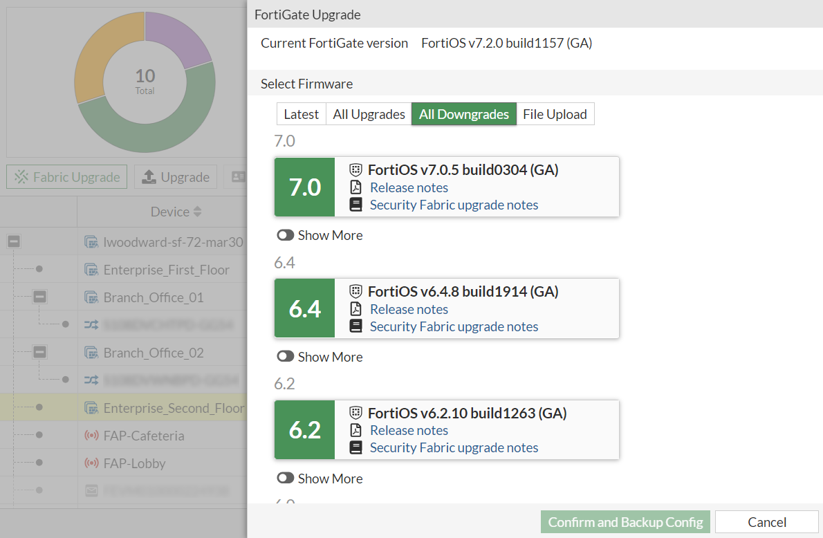

- Click one of the following tabs to select a downgrade method:
All Downgrades
Click the All Downgrades tab to view and select all firmware versions that are available from FortiGuard for downgrade.
File Upload
Click the File Upload tab to upload a firmware file that you previously downloaded from the Fortinet Customer Service & Support website.
In this example, the All Downgrades tab is selected.
- Select a firmware version and click Confirm and Backup Config. A warning message is displayed.
- Click Continue to continue with the downgrade.
