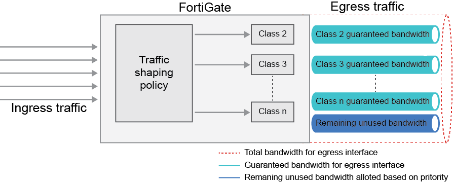

At the most basic level, policing involves traffic prioritization and bandwidth limits. Traffic prioritization helps categorize traffic into different priority levels: low, medium, high, critical, and top. When bandwidth is limited, traffic with higher priority levels will take precedence over lower priority traffic. Traffic with lower priority levels that exceeds available bandwidth will be dropped. These levels are only applicable in the context of traffic shaping profiles and should not be confused with global traffic prioritization levels.
Bandwidth limits define the guaranteed and maximum bandwidth allotted to each traffic class. These limits are configured as a percentage of the outbandwidth, which is the outbound bandwidth configured on an interface.
Guaranteed bandwidth limits guarantee the minimum bandwidth that is allotted to a given class of traffic. The sum of all guaranteed bandwidth of all classes within a traffic shaping profile cannot exceed 100%. However, the sum of all guaranteed bandwidth does not need to add up to 100%. The guaranteed bandwidth is always respected, even if one class has lower priority than another.
Maximum bandwidth limits define the maximum percentage of the outbandwidth that a traffic class can use up. This value often will be 100%, given that when there is no other traffic going through other classes, you would want to fully utilize the bandwidth of the outbound link. Traffic throughput exceeding the maximum bandwidth will be dropped.
The following diagram illustrates ingress traffic and how the FortiGate assigns classes and bandwidth to each class.

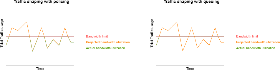

Traffic shaping with queuing
When traffic congestion occurs and if there is no queuing, then the excess packets are dropped. With queuing, when traffic exceeds the configured bandwidth limits, the traffic is delayed for transport until bandwidth frees up. Traffic may still be dropped if the queues are full.
In queuing, before a packet egresses an interface, it is first enqueued using an algorithm, such as random early detection (RED) or first in, first out (FIFO). The kernel then dequeues the packet based on the HTB algorithm before sending it out. Queuing can be configured per shaping profile, and it can be customized per class.
The following diagram shows how traffic policing differs from traffic queuing by comparing the bandwidth limit, projected bandwidth utilization, and actual bandwidth utilization.

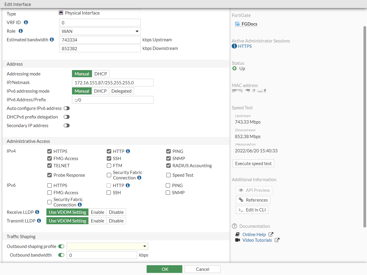

Configuring the interface outbandwidth
There are two settings that must be configured on an interface that has traffic shaping applied to egressing traffic: a traffic shaping profile must be assigned, and the outbound bandwidth must be configured.
Since traffic shaping is often configured on the WAN interface for egressing traffic, the outbound bandwidth is effectively the upstream bandwidth allowed by your ISP. On the FortiGate, it is possible to perform a speed test on interfaces are assigned a WAN role assigned (see GUI speed test). The speed test performs measurements against public cloud servers, and provides an accurate measurement of the upstream bandwidth. After the test is complete, the results can be used to populate the Outbound bandwidth field.
To configure traffic shaping on an interface:
  1. Go to Network > Interfaces and double-click an interface to edit it.
  2. For interfaces assigned a WAN role, in the right-side of the screen, click Execute speed test.
  3. When the test completes, click OK in the Confirm pane to apply the results to the estimated bandwidth. The speed test results are populated in the Estimated bandwidth fields for kbps Upstream and kbps Downstream.
  4. In the Traffic Shaping section, enable Outbound shaping profile and select a profile.
  5. Enable Outbound bandwidth and copy the kbps Upstream value from the speed test, or enter a custom value.
  6. Click OK.

When configuring a traffic shaping profile, the settings can be defined per class.
The following options can be configured for traffic shaping classes:
GUI option
CLI option
Default
set default-class-id <class-id>
Set the default class ID.
Each profile must have one default class ID. The default class ID can be changed at any time.
Traffic shaping class ID
set class-id <integer>
Set the class ID (2 - 31).
set guaranteed-bandwidth-percentage <integer>
Set the percentage of the outbandwidth that will be guaranteed for the class ID.
Maximum bandwidth
set maximum-bandwidth-percentage <integer>
Set the percentage of the outbandwidth that will be the maximum bandwidth for the class ID.
Priority
set priority {top | critical | high | medium | low}
Select the priority level for the class ID.
NP7 and NP7Lite (SOC5) processors do not support setting a priority in a traffic shaping profile. The priority option is ignored by NP7 and NP7Lite processors. Otherwise, once the guaranteed bandwidth is satisfied, traffic shaping works as expected for NP7 or NP7Lite-offloaded sessions.
For information about how NP7 processors affect traffic shaping, see NP7 traffic shaping.
  6. Click OK.
