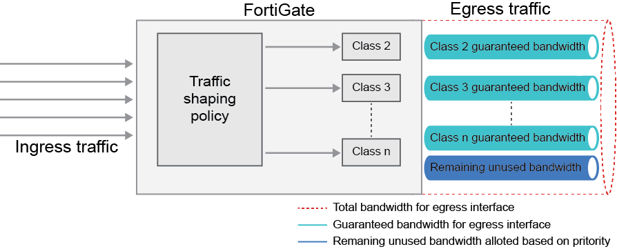

The following diagram illustrates ingress traffic and how the FortiGate assigns classes and bandwidth to each class.
When comparing traffic shaping profiles and traffic shapers, it is important to remember that guaranteed and maximum bandwidth in a traffic shaping profile is a percentage of the outbandwidth, while guaranteed and maximum bandwidth in a traffic shaper is a rate (Kbps, Mbps, and so on). As long as the outbandwidth is true to its measurement, the bandwidth usage should not exceed the available bandwidth of a link when using a traffic shaping profile.
Congestion occurs when actual traffic surpasses the outbandwidth limit. At this point, traffic prioritization helps determine which traffic will be prioritized over others. First, the guaranteed bandwidth limit is allocated for each class. The left over bandwidth is allocated to traffic classes based on priority. The traffic classes with the highest priority can use as much of the remaining bandwidth as needed. Then, the remaining bandwidth can be allocated to classes at the next priority level, and so forth.

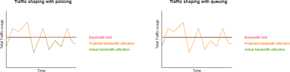

When traffic congestion occurs and if there is no queuing, then the excess packets are dropped. With queuing, when traffic exceeds the configured bandwidth limits, the traffic is delayed for transport until bandwidth frees up. Traffic may still be dropped if the queues are full.
In queuing, before a packet egresses an interface, it is first enqueued using an algorithm, such as random early detection (RED) or first in, first out (FIFO). The kernel then dequeues the packet based on the HTB algorithm before sending it out. Queuing can be configured per shaping profile, and it can be customized per class.
The following diagram shows how traffic policing differs from traffic queuing by comparing the bandwidth limit, projected bandwidth utilization, and actual bandwidth utilization.

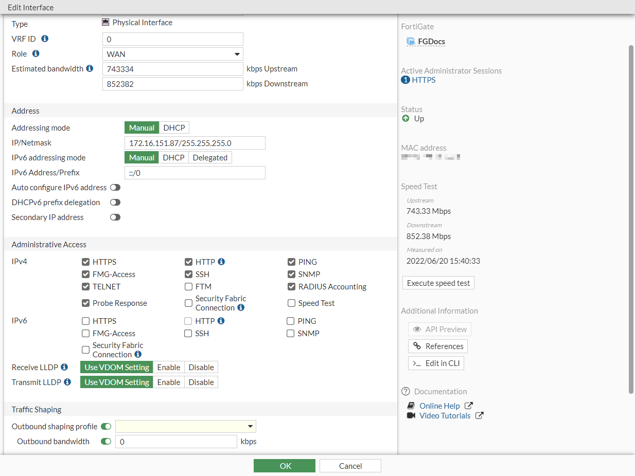

There are two settings that must be configured on an interface that has traffic shaping applied to egressing traffic: a traffic shaping profile must be assigned, and the outbound bandwidth must be configured.
Since traffic shaping is often configured on the WAN interface for egressing traffic, the outbound bandwidth is effectively the upstream bandwidth allowed by your ISP. On the FortiGate, it is possible to perform a speed test on interfaces are assigned a WAN role assigned (see Manual interface speedtest). The speed test performs measurements against public cloud servers, and provides an accurate measurement of the upstream bandwidth. After the test is complete, the results can be used to populate the Outbound bandwidth field.
To configure traffic shaping on an interface:
- Go to Network > Interfaces and double-click an interface to edit it.
- For interfaces assigned a WAN role, in the right-side of the screen, click Execute speed test.
- When the test completes, click OK in the Confirm pane to apply the results to the estimated bandwidth. The speed test results are populated in the Estimated bandwidth fields for kbps Upstream and kbps Downstream.
- In the Traffic Shaping section, enable Outbound shaping profile and select a profile.
- Enable Outbound bandwidth and copy the kbps Upstream value from the speed test, or enter a custom value.
- Click OK.
