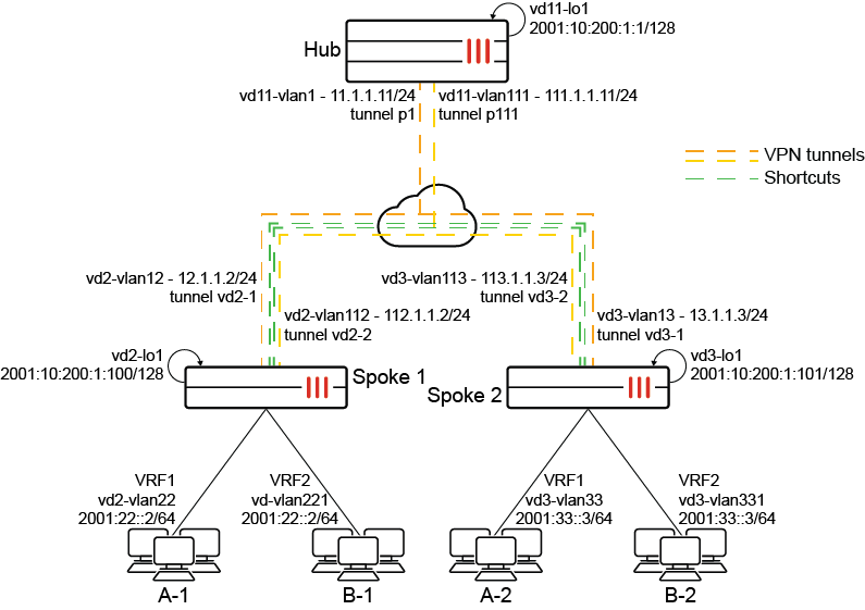

In this example, multiple companies (or departments of a company) share the ADVPN. Company A and company B each have two branches in two different locations. Company A's branches (A-1 and A-2) can talk to each other using the VPN shortcut, but not to company B's branches (B-1 and B-2). Likewise, company B's branches can talk to each other using the VPN shortcut, but not to company A's branches. Traffic can share the tunnels and shortcuts, but cannot be mixed up.
In this example, two spokes each have two tunnels to the hub.
- Each spoke has two VRFs behind it that can use the same IP address or subnets.
- The computers in VRF1 behind spoke 1 can talk to the computers in VRF1 behind spoke 2, but not to any of the computers in the VRF2s behind either spoke.
- The computers in VRF2 behind spoke 1 can talk to the computers in VRF2 behind spoke 2, but not to any of the computers in the VRF1s behind either spoke.
- Loopback addresses are used for communication between the spokes and the hub instead of tunnel IP address.
