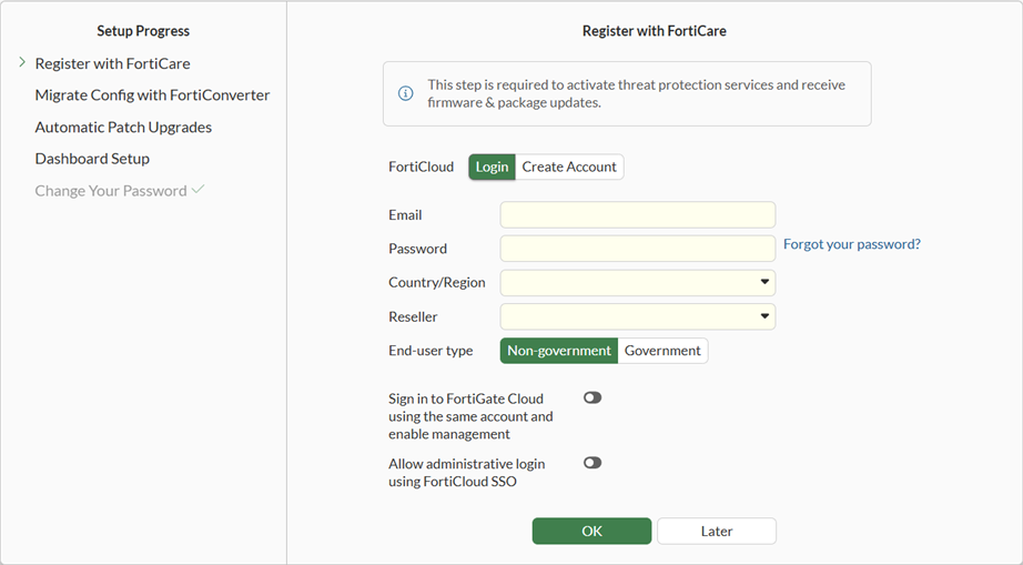

  1. Log in to the FortiOS GUI. The Register with FortiCare dialog box is displayed:
    You can temporarily postpone registration to access the seven-day setup period. See Postponing registration to access the setup period.
  2. With FortiCloud set to Login, complete the fields, and click OK to register with FortiCare.
    If you do not want to register the device now, click Log Out, and register the device another time. However, you will be unable to access the GUI for further device configuration.

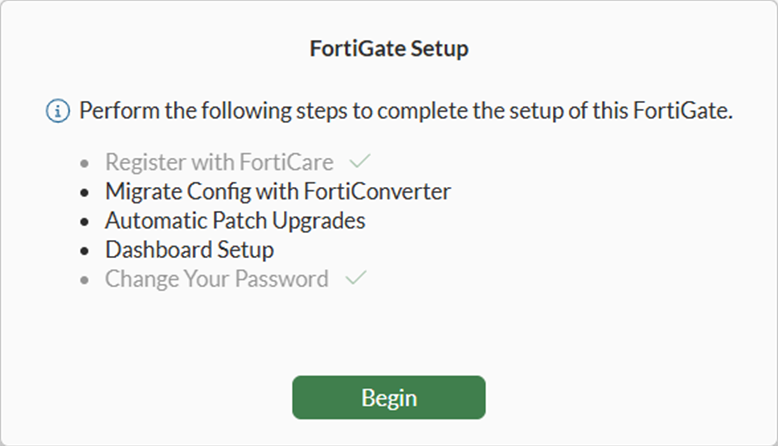

    The FortiGate Setup wizard is displayed.
  3. Click Begin to continue. See Completing the FortiGate Setup wizard.

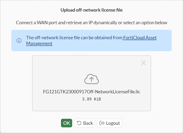

The FortiGate setup wizard can be used to manually upload a previously downloaded license file, allowing successful registration even when the device is unable to reach FortiCare. On FortiCare, register the FortiGate, download the license file, and use the wizard to upload the offline license file to the off-network FortiGate. As long as the FortiGate serial number in the license file matches the serial number of the off-network FortiGate, the device is considered registered. This is particularly useful for air-gapped environments where the lack of internet connectivity is by design.
To register an off-network FortiGate to FortiCare:
  1. Go to FortiCare, log in, and register the FortiGate using the Asset Management portal. See Registering assets.
  2. From FortiCare, download the license file. See Viewing licenses and keys.
  3. On the off-network FortiGate, log in to FortiOS and select Upload off-network license file.
  4. Upload the off-network license file and click OK.
    Once the upload is completed and the serial number in the license file matches the serial number of the FortiGate, the following screen is displayed:
  5. Click OK to continue to proceed to the FortiGate Setup wizard. See Completing the FortiGate Setup wizard.

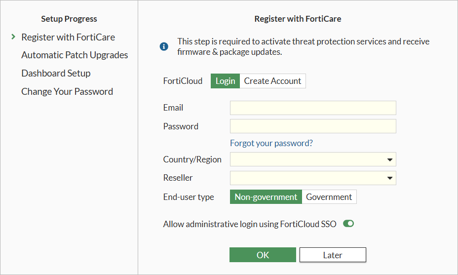

  1. Connect to the FortiGate GUI. The FortiGate Setup wizard appears.
  2. Click Begin. The Register with FortiCare step is displayed.
  3. Register the FortiGate to FortiCare, and click OK. The next step in the wizard is displayed.

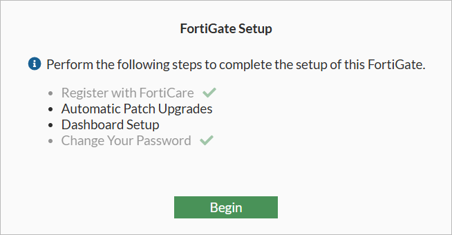

  4. Click Begin to continue. See also Completing the FortiGate Setup wizard.
