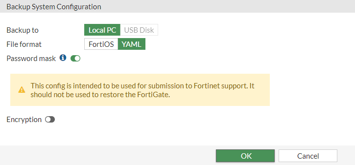

When backing up a configuration that will be shared with a third party, such as Fortinet Inc. Support, passwords and secrets should be obfuscated from the configuration to avoid information being unintentionally leaked. Password masking can be completed in the Backup System Configuration page and in the CLI. When password masking is enabled, passwords and secrets will be replaced in the configuration file with FortinetPasswordMask.
To mask passwords in the GUI:
  1. Click on the username in the upper right-hand corner of the screen and select Configuration > Backup.
  2. Select YAML as the File format.
  3. Enable Password mask. A warning message is displayed.
  4. Click OK. The configuration file is saved to your computer with passwords and secrets obfuscated.

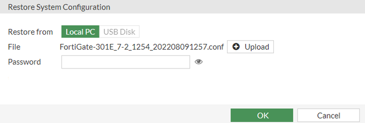

Configuration files can be used to restore the FortiGate to a previous configuration in the Restore System Configuration page.
To restore the FortiGate configuration using the GUI:
  1. Click on the user name in the upper right-hand corner of the screen and select Configuration > Restore.
  2. Identify the source of the configuration file to be restored: your Local PC or a USB Disk.
    The USB Disk option will not be available if no USB drive is inserted in the USB port. You can restore from the FortiManager using the CLI.
  3. Click Upload, locate the configuration file, and click Open.
  4. Enter the password if required.
  5. Click OK.

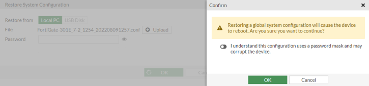

When restoring a configuration file that has password masking enabled, obfuscated passwords and secrets will be restored with the password mask.
Restoring the FortiGate with a configuration with passwords obfuscated is not recommended.
To restore an obfuscated YAML configuration using the GUI:
  2. Click Upload. The File Explorer is displayed.
  3. Navigate to the configuration file and click Open.
  4. (Optional) Enter the file password in the Password field.
  5. Click OK. The Confirm pane is displayed with a warning.
  6. Toggle the acknowledgment.
  7. Click OK.

To back up the configuration in YAML format using the GUI:
  1. Click on the user name in the upper right-hand corner of the screen and select Configuration > Backup.
  2. Direct the backup to your Local PC or to a USB Disk.
  3. Select YAML for the File format.
  4. Click OK.

Restoring configuration files from the GUI
  5. Click OK.
  7. Click OK.
