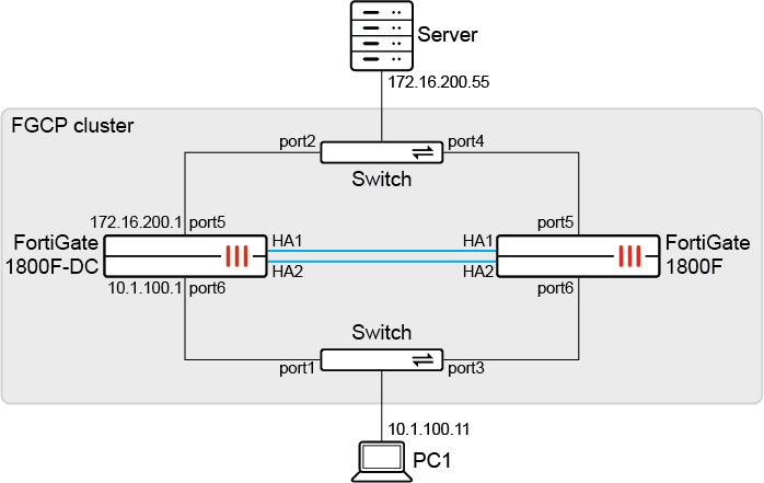

To improve power redundancy, FGCP HA clusters can support forming HA between units of the same model but with different AC PSU and DC PSU power supplies. This enables redundancy in a situation where power is completely lost on the AC grid, but traffic can fail over to a cluster member running on an independent DC grid.
The cluster members must be the same model with the same firmware installed, and must have the same hardware configuration other than the PSU.
In the following examples, there is an FGCP cluster with AC and DC PSU members: a FortiGate 1800F-DC (primary) and FortiGate 1800F (secondary).

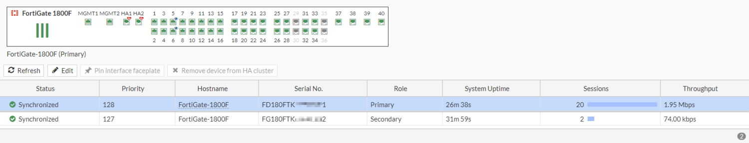

To configure the FGCP cluster in the GUI:
  1. On the primary FortiGate (FG-1800F-DC), go to System > HA.
  2. Configure the following settings:

  3. Click OK.
  4. On the secondary FortiGate (FG-1800F), go to System > HA.

  6. Click OK.
  7. Verify that the cluster status is Synchronized.

Testing synchronization in the cluster
Based on the preceding example, the interface and firewall policy configurations are changed on the primary FortiGate. These configuration changes and sessions are synchronized to the secondary FortiGate. If the switch interface connected to the primary's port5 is down (port2), this triggers the monitor interface to be down, and the PC1 traffic will fail over to the secondary FortiGate.
To test configuration synchronization in the FGCP cluster:

FGCP HA between FortiGates of the same model with different AC and DC PSUs NEW
Basic configuration
    Mode
    Active-Passive
    Device priority

  3. Verify the cluster status on the primary FortiGate:
    # get system ha status
    HA Health Status: OK
    Model: FortiGate-1800F
    Mode: HA A-P
    Group Name: Example_cluster
    Group ID: 0
    Debug: 0
    Cluster Uptime: 0 days 0:56:11
    Cluster state change time: 2023-05-29 19:11:14
    Primary selected using:
        <2023/05/29 19:11:14> vcluster-1: FG180FTK*******1 is selected as the primary because its uptime is larger than peer member FG180FTK*******2.
        <2023/05/29 18:59:45> vcluster-1: FG180FTK*******2 is selected as the primary because its uptime is larger than peer member FG180FTK*******1.
        <2023/05/29 18:59:45> vcluster-1: FG180FTK*******1 is selected as the primary because its override priority is larger than peer member FG180FTK*******2.
    ses_pickup: enable, ses_pickup_delay=disable
    override: disable
    Configuration Status:
        FG180FTK*******1(updated 4 seconds ago): in-sync
        FG180FTK*******1 chksum dump: 95 4e 92 c3 39 75 8e 0e db 83 8d b7 b2 b1 9f 04
        FG180FTK*******2(updated 5 seconds ago): in-sync
        FG180FTK*******2 chksum dump: 95 4e 92 c3 39 75 8e 0e db 83 8d b7 b2 b1 9f 04
    System Usage stats:
            sessions=4, npu-sessions=0, average-cpu-user/nice/system/idle=0%/0%/0%/99%, memory=22%
            sessions=0, npu-sessions=0, average-cpu-user/nice/system/idle=0%/0%/0%/99%, memory=22%
    HBDEV stats:
            ha2: physical/10000full, up, rx-bytes/packets/dropped/errors=18367581/33512/0/0, tx=9563450/16609/0/0
            ha1: physical/10000full, up, rx-bytes/packets/dropped/errors=11543018/22166/0/0, tx=12359673/22151/0/0
            ha2: physical/10000full, up, rx-bytes/packets/dropped/errors=19133123/35087/0/0, tx=10685583/18475/0/0
            ha1: physical/10000full, up, rx-bytes/packets/dropped/errors=17011332/25876/0/0, tx=11919050/24991/0/0
    MONDEV stats:
            port5: physical/1000full, up, rx-bytes/packets/dropped/errors=988220/13742/0/0, tx=106998000/73260/0/0
            port6: physical/1000full, up, rx-bytes/packets/dropped/errors=107084264/73624/0/0, tx=953158/13611/0/0
            port5: physical/1000full, up, rx-bytes/packets/dropped/errors=38194/128/0/0, tx=0/0/0/0
            port6: physical/1000full, up, rx-bytes/packets/dropped/errors=99019/448/0/0, tx=0/0/0/0
    Primary     : FortiGate-1800F , FG180FTK*******1, HA cluster index = 1
    Secondary   : FortiGate-1800F , FG180FTK*******2, HA cluster index = 0
    number of vcluster: 1
    vcluster 1: work 169.254.0.2
    Primary: FG180FTK*******1, HA operating index = 0
    Secondary: FG180FTK*******2, HA operating index = 1

    root@pc1:~# ifconfig eth1
    eth1      Link encap:Ethernet  HWaddr 00:0c:29:a0:60:d6
              inet addr:10.1.100.11  Bcast:10.1.100.255  Mask:255.255.255.0
    root@pc1:~# route -n
    Kernel IP routing table
    Destination     Gateway         Genmask         Flags Metric Ref    Use Iface
    0.0.0.0         10.1.100.1      0.0.0.0         UG    0      0        0 eth1
    10.1.100.0      0.0.0.0         255.255.255.0   U     0      0        0 eth1

  2. Using Wget, initiate a large file download with HTTP that will maintain a long session:
    root@pc1:~# wget http://172.16.200.55/big100MB.html   --keep-session-cookies --limit-rate=128k --progress=dot -S -r --delete-after

  3. On the primary FortiGate (FG-1800F-DC), check the session information:
    # diagnose sys session filter  dport  80
    # diagnose sys session list

  4. On the secondary FortiGate (FG-1800F), check that the session is synchronized:

To test failover in the FGCP cluster:
  1. On the switch connected to port5 of the primary FortiGate, change port2's status to be down:
    config switch physical-port
        edit port2
            set status down
  2. Check the HA status on the primary FortiGate (FG-1800F-DC), which now becomes the secondary device:

  3. Check the HA status on the new primary FortiGate (FG-1800F):
