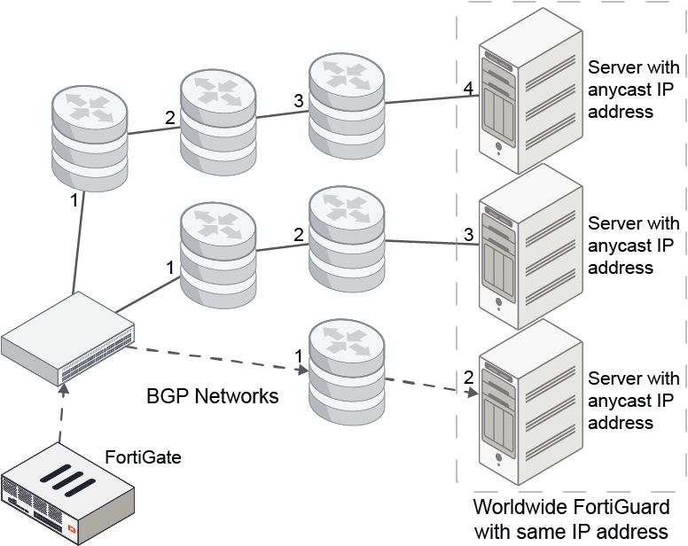

Anycast
FortiGuard servers use Anycast addresses in order to optimize and distribute traffic across many servers. Anycast is the default access mode for FortiGates when connecting to FortiGuard which by default utilizes HTTPS and port 443.
Each type of FortiGuard servers and services have a FortiGuard domain name that resolves to a single Anycast IP address. Regardless of where the FortiGate is located, the resolution is still the same. Fortinet maintains the network in the background to ensure routes to the FortiGuard servers are optimized. In the below diagram, several servers have the same Anycast IP, but the FortiGate will connect to the one with the least hops.

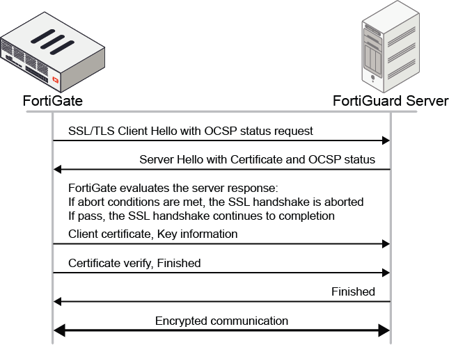

Connection and OCSP stapling
When the FortiGate connects to a FortiGuard server, it is important for it to validate the server is indeed a real FortiGuard server. Hence, FortiGuard servers provide the following security:
  • The domain name of each FortiGuard service is the common name in that service's certificate, which is signed by a third-party intermediate CA.
  • The FortiGuard server also applies Online Certificate Status Protocol (OCSP) stapling check, in which it attaches a time-stamped OCSP status of the server certificate from the OCSP server to the TLS response.
This ensures FortiGate can validate the FortiGuard server certificate efficiently during the TLS handshake.
The following illustrates the connection process:
FortiGate will only complete the TLS handshake with an anycast server when abort conditions are not met. Abort conditions include:
  • The CN in the server's certificate does not match the domain name resolved from the DNS.
  • The OCSP status is revoked or unknown.
  • The issuer-CA is revoked by the root-CA.

Anycast
