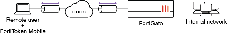

This is a sample configuration of SSL VPN that uses FortiToken mobile push two-factor authentication. If you enable push notifications, users can accept or deny the authentication request.
Sample topology
Sample configuration
WAN interface is the interface connected to ISP. This example shows static mode. You can also use DHCP or PPPoE mode. The SSL VPN connection is established over the WAN interface.

    1. Go to VPN > SSL-VPN Portals to edit the full-access portal.
      This portal supports both web and tunnel mode.
    2. Disable Enable Split Tunneling so that all SSL VPN traffic goes through the FortiGate.
  8. Configure SSL VPN settings:
    1. Go to VPN > SSL-VPN Settings.
    2. Select the Listen on Interface(s), in this example, wan1.
    3. Set Listen on Port to 10443.
    4. Set Server Certificate to the authentication certificate.
    5. Under Authentication/Portal Mapping, set default Portal web-access for All Other Users/Groups.
    6. Create new Authentication/Portal Mapping for group sslvpngroup mapping portal full-access.
  9. Configure SSL VPN firewall policy:
    2. Fill in the firewall policy name. In this example, sslvpn certificate auth.
    3. Incoming interface must be SSL-VPN tunnel interface(ssl.root).
    4. Set the Source Address to all and Source User to sslvpngroup.
    5. Set the Outgoing Interface to the local network interface so that the remote user can access the internal network. In this example, port1.
    6. Set Destination Address to the internal protected subnet 192.168.1.0.
    7. Set Schedule to always, Service to ALL, and Action to Accept.
    8. Enable NAT.
    9. Configure any remaining firewall and security options as desired.
    10. Click OK.
To configure SSL VPN using the CLI:
  1. Configure the interface and firewall address.
    config system interface
        edit "wan1"
            set vdom "root"
            set ip 172.20.120.123 255.255.255.0
  2. Configure internal interface and protected subnet, then connect the port1 interface to the internal network.
        edit "port1"
            set vdom "root"
            set ip 192.168.1.99 255.255.255.0
    config firewall address
        edit "192.168.1.0"
            set subnet 192.168.1.0 255.255.255.0
  3. Register FortiGate for FortiCare Support.
    To add or download a mobile token on FortiGate, FortiGate must be registered for FortiCare Support. If your FortiGate is registered, skip this step.
    diagnose forticare direct-registration product-registration -a "your account@xxx.com" -p "your password" -T "Your Country/Region" -R "Your Reseller" -e 1
  4. Add FortiToken mobile to FortiGate:
    execute fortitoken-mobile import <your FTM code>
    If your FortiGate has FortiToken installed, skip this step.
    Every FortiGate has two free mobile Tokens. You can download the free token.
    execute fortitoken-mobile import 0000-0000-0000-0000-0000
  5. Enable FortiToken mobile push:
    1. To use FTM-push authentication, ensure server-ip is reachable from the Internet and enable FTM-push in the FortiGate:
      config system ftm-push
          set server-ip 172.20.120.123
          set status enable
    2. Enable FTM service on WAN interface:
          edit "wan1"
              append allowaccess ftm
  6. Configure user and user group:
    config user local
        edit "sslvpnuser1"
            set type password
            set two-factor fortitoken
            set fortitoken <select mobile token for the option list>
            set email-to <user's email address>
            set passwd <user's password>
    config user group
        edit "sslvpngroup"
            set member "sslvpnuser1"
  7. Activate the mobile token.
    When the user sslvpnuser1 is created, an email is sent to the user's email address. Follow the instructions to install your FortiToken mobile application on your device and activate your token.
  8. Configure SSL VPN web portal:
    config vpn ssl web portal
        edit "full-access"
            set tunnel-mode enable
            set web-mode enable
            set ip-pools "SSLVPN_TUNNEL_ADDR1"
            set split-tunneling disable
  9. Configure SSL VPN settings:
    config vpn ssl settings
        set servercert "server_certificate"
        set tunnel-ip-pools "SSLVPN_TUNNEL_ADDR1"
        set source-interface "wan1"
        set source-address "all"
        set default-portal "web-access"
        config authentication-rule
                set groups "sslvpngroup"
                set portal "full-access"
  10. Configure one SSL VPN firewall policy to allow remote user to access the internal network:
    config firewall policy
            set name "sslvpn web mode access"
            set srcintf "ssl.root"
            set dstintf "port1"
            set srcaddr "all"
            set dstaddr "192.168.1.0"
            set groups “sslvpngroup”
            set service "ALL"
            set nat enable
To see the results of web portal:
  1. From a remote device, use a web browser to log into the SSL VPN web portal http://172.20.120.123:10443.
  2. Log in using the sslvpnuser1 credentials.
    The FortiGate pushes a login request notification through the FortiToken mobile application.
  3. Check your mobile device and select Approve.
    When the authentication is approved, sslvpnuser1 is logged into the SSL VPN portal.
  4. On the FortiGate, go to Dashboard > Network and expand the SSL-VPN widget to verify the user’s connection.
To see the results of tunnel connection:
  1. Download FortiClient from www.forticlient.com.
  2. Open the FortiClient Console and go to Remote Access > Configure VPN.
  3. Add a new connection:
    1. Set the connection name.
    2. Set Remote Gateway to the IP of the listening FortiGate interface, in this example, 172.20.120.123.
    3. Select Customize Port and set it to 10443.
  4. Save your settings.
  5. Log in using the sslvpnuser1 credentials and click FTM Push.
  6. Check your mobile device and select Approve.
    When the authentication is approved, sslvpnuser1 is logged into the SSL VPN tunnel.
To check the SSL VPN connection using the GUI:
  1. Go to Dashboard > Network and expand the SSL-VPN widget to verify the user’s connection.
  2. Go to Log & Report > Forward Traffic to view the details of the SSL VPN traffic.
To check the web portal login using the CLI:
get vpn ssl monitor
SSL VPN Login Users:
 Index   User           Auth Type    Timeout   From           HTTP in/out   HTTPS in/out
 0       sslvpnuser1    1(1)         229       10.1.100.254   0/0           0/0
SSL VPN sessions:
 Index   User    Source IP      Duration        I/O Bytes       Tunnel/Dest IP
To check the tunnel login using the CLI:
get vpn ssl monitor
 0       sslvpnuser1   1(1)         291       10.1.100.254   0/0          0/0
SSL VPN sessions:
 0       sslvpnuser1   10.1.100.254   9          22099/43228    10.212.134.200
