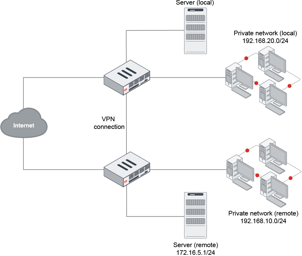

This section explains how to specify the source and destination IP addresses of traffic transmitted through an IPsec VPN, and how to define appropriate security policies.
Topology
Defining policy addresses
In a gateway-to-gateway, hub-and-spoke, dynamic DNS, redundant tunnel, or transparent configuration, you need to define a policy address for the private IP address of the network behind the remote VPN peer (for example, 192.168.10.0/255.255.255.0 or 192.168.10.0/24).
In a peer-to-peer configuration, you need to define a policy address for the private IP address of a server or host behind the remote VPN peer (for example, 172.16.5.1/255.255.255.255, 172.16.5.1/32, or 172.16.5.1).
Topology
