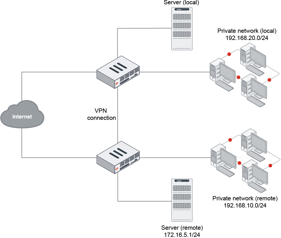

Topology
Defining policy addresses
In a gateway-to-gateway, hub-and-spoke, dynamic DNS, redundant tunnel, or transparent configuration, you need to define a policy address for the private IP address of the network behind the remote VPN peer (for example, 192.168.10.0/255.255.255.0
or 192.168.10.0/24
In a peer-to-peer configuration, you need to define a policy address for the private IP address of a server or host behind the remote VPN peer (for example, 172.16.5.1/255.255.255.255
, 172.16.5.1/32
, or 172.16.5.1

Policy-based VPN
An IPsec policy enables the transmission and reception of encrypted packets, specifies the permitted direction of VPN traffic, and selects the VPN tunnel. In most cases, a single policy is needed to control both inbound and outbound IP traffic through a VPN tunnel. For a detailed example, see Policy-based IPsec tunnel. Be aware of the following before creating an IPsec policy.
