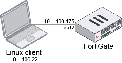

In this example, the FortiGate’s port2 is configured with virtual patching enabled. In the test scenario, the FortiGate is set to debug mode in order to block a harmless attack. IPS will scan local-in traffic and all matched local-in traffic will be dropped accordingly. Intrusion prevention logs will be recorded.
To configure virtual patching on the local-in management interface:
  1. Configure the local-in policy:
    config firewall local-in-policy
            set intf "port2"
            set srcaddr "all"
            set dstaddr "all"
            set service "ALL"
            set virtual-patch enable
  2. For testing purpose only, enable all signatures for the virtual patch feature:
    # diagnose ips vpatch enable-all
  3. From the Linux client, start a cURL download:
    root@PC02:~# curl -vk -F "file=@eicar" https://10.1.100.175 -m 10
    The attack is blocked, and a security event log (intrusion prevention) is recorded.
  4. Reset the virtual patch enabled signatures back to the default:
    # diagnose ips vpatch reset
