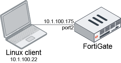

Example
In this example, the FortiGate’s port2 is configured with virtual patching enabled. In the test scenario, the FortiGate is set to debug mode in order to block a harmless attack. IPS will scan local-in traffic and all matched local-in traffic will be dropped accordingly. Intrusion prevention logs will be recorded.
To configure virtual patching on the local-in management interface:
Configure the local-in policy:
config firewall local-in-policy edit 1 set intf "port2" set srcaddr "all" set dstaddr "all" set action accept set service "ALL" set schedule "always" set virtual-patch enable next end -
