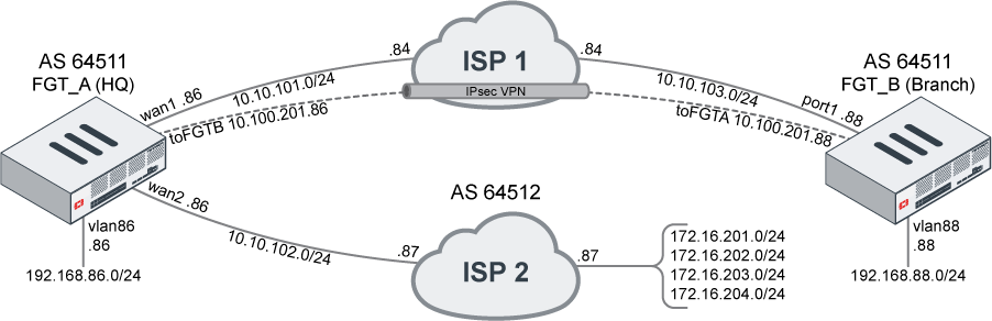

In this example, BGP is configured on two FortiGate devices. The FortiGates are geographically separated, and form iBGP peering over a VPN connection. FGT_A also forms eBGP peering with ISP2.
FGT_A learns routes from ISP2 and redistributes them to FGT_B while preventing any iBGP routes from being advertised.
The internal networks behind the FortiGates can communicate with each other, and the internal networks behind FGT_B can traverse FGT_A to reach networks that are advertised by ISP2.
  • FGT_A and FGT_B have static routes to each other through ISP1. ISP1 does not participate in BGP.
  • The IPsec VPN tunnel between FGT_A and FGT_B is configured with wildcard 0.0.0.0/0 networks for phase2 local and remote selectors. The VPN interfaces have IP addresses already configured and are used for peering between FGT_A and FGT_B.
  • FGT_A is configure to peer with ISP2 on 10.10.108.86.
  • The firewall policies between FGT_A and FGT_B are not NATed. The firewall policies egressing on wan2 are NATed.
Configuring iBGP peering
To configure FGT_A to establish iBGP peering with FGT_B in the GUI:
  1. Go to Network > BGP.
  2. Set Local AS to 64511
  3. Set Router ID to 1.1.1.1.
  4. In the Neighbors table, click Create New and set the following:
    IP
    10.100.201.88
    Remote AS
    64511
  5. Click OK.
  6. Under Networks, set IP/Netmask to 192.168.86.0/24.
  7. Click Apply.
  8. In the CLI, set the interface used as the source IP address of the TCP connection (where the BGP session, TCP/179, is connecting from) for the neighbor (update-source) to toFGTB.
To configure FGT_A to establish iBGP peering with FGT_B in the CLI:
