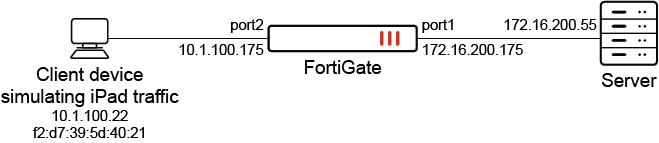

This example demonstrates the flow for OT virtual patching from start to finish. First, a device (10.1.100.22) goes through device detection, which matches an OT detection signature downloaded on the FortiGate. Next, known vulnerabilities and OT patch signatures for this device are mapped to its MAC address. When traffic is generated by this device, IPS scans the traffic to identify any traffic patterns that match known OT patch signatures for this device. If a match is found, traffic is blocked by the FortiGate.
For demonstrative purposes, the simulated vulnerable OT device is a PC simulating web traffic from an iPad. An OT detection signature is specially crafted to match this Apple iPad traffic to the OT device category. To simulate vulnerable traffic, a test OT patch signature is used to match a generic cross-site scripting (XSS) attack over HTTP.
