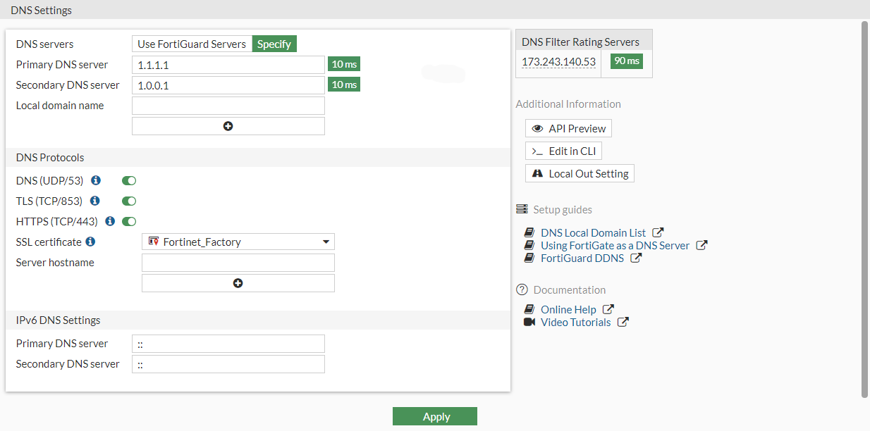

To enable DoT and DoH DNS in the GUI:
  1. Go to Network > DNS.
  2. Enter the primary and secondary DNS server addresses.
  3. In the DNS Protocols section, enable TLS (TCP/853) and HTTPS (TCP/443).
  4. Configure the other settings as needed.
  5. Click Apply.

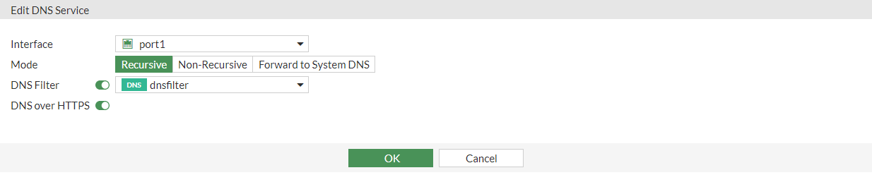

To enable DoH on the DNS server in the GUI:
  1. Go to Network > DNS Servers.
  2. In the DNS Service on Interface section, edit an existing interface, or create a new one.
  3. Select a Mode, and DNS Filter profile.
  4. Enable DNS over HTTPS.
  5. Click OK.

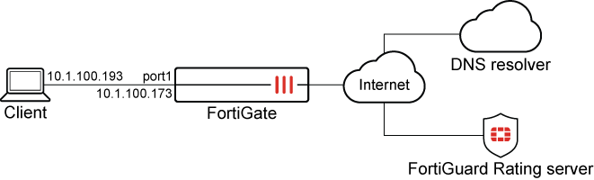

Examples
The following examples demonstrate how configure DNS settings to support DoT and DoH queries made to the FortiGate.
