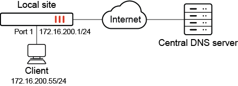

In this example, a client PC is configured with the IP address 172.16.200.55, and an administrator adds the IP address to the IP ban list.
To add an IP address to the ban list:
# diagnose user banned-ip add src4 172.16.200.55 2 admin
