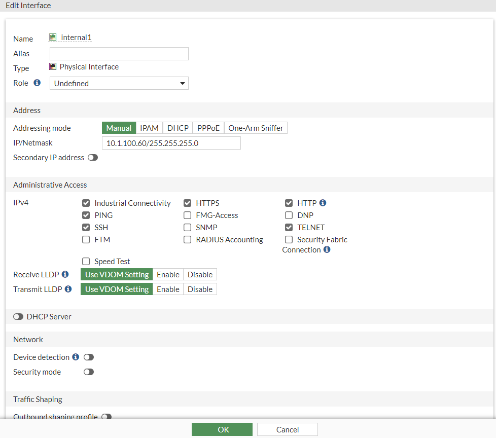

To enable Industrial Connectivity for an interface in the GUI:
Go to Network > Interfaces.
Click Create New > Interface, or double-click an interface to open in for editing.
Set Role to Undefined or WAN
Only internal and WAN interfaces support Industrial Connectivity administrative access.
In the Administrative Access section, select Industrial Connectivity.
Set the remaining options as desired, and click OK.

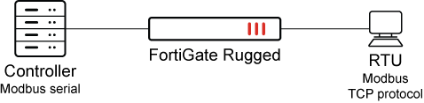

After the Industrial Connectivity service is enabled and configured for an interface, supported FortiGate Rugged devices can receive data from Supervisory Control and Data Acquisition (SCADA) systems in serial format and convert it to TCP/IP formats.
In the following topology, PC1 uses the IEC 60870-5-101 (shortened to IEC-101) protocol to transmit data from SCADA systems to FortiGate Rugged, where the data is converted to the IEC 60870-5-104 (shortened to IEC-104) protocol, and sent to PC2.
The data is converted as follows:
FortiGate Rugged transmits data over TCP port 502.
Protocols IEC 60870-5-101 and IEC 60870-5-104 are both used to transmit the data.
While IEC-101 is based on a serial transmission of data (for example, using RS-232 and FSK-based modems), IEC-104 is packet oriented and based on TCP/IP transmission.

After the Industrial Connectivity service is enabled and configured for an interface, supported FortiGate Rugged devices can receive data from Modbus networks in serial format and convert it to TCP.
In the following topology, the Modbus controller uses Modbus serial to transmit data to FortiGate Rugged, where the data is converted to the Modbus TCP, and sent to the Modbus Remote Terminal Unit (RTU).
