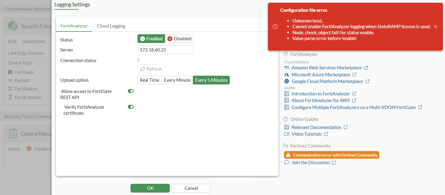

Blocking unsupported features on StateRamp devices
When trying to enable services that are not supported on StateRamp devices, an error will be returned in the GUI and CLI. Likewise, some features are hidden in the GUI if they are disabled for StateRamp devices.
In the following example, the user attempts to enable FortiAnalyzer on a StateRamp FortiGate which is an unsupported service on StateRamp devices.
To view StateRamp device unsupported feature errors:
  1. In the CLI, verify that the device has a StateRamp license:
    # get system status
    Version: FortiGate-1101E v7.4.11,build2878,260126 (GA.M)
    First GA patch build date: 230509
    Current Security Level: High
    Firmware Signature: certified
    License Status: StateRAMP
  2. Test configuring the unsupported feature in the GUI:
    1. In the GUI, go to Security Fabric > Fabric Connectors.
    2. Edit Logging & Analytics.
    3. Attempt to enable FortiAnalyzer.
      An error is displayed and the Switch Controller feature is hidden.
  3. Test configuring the unsupported feature in the CLI:
    1. Attempt to enable FortiAnalyzer.
      config log fortianalyzer setting
          set status enable
              Cannot enable FortiAnalyzer logging when StateRAMP license is used.
              node_check_object fail! for status enable
              value parse error before 'enable'
              Command fail. Return code -39
      An error is displayed.
    # get system status
          set status enable
