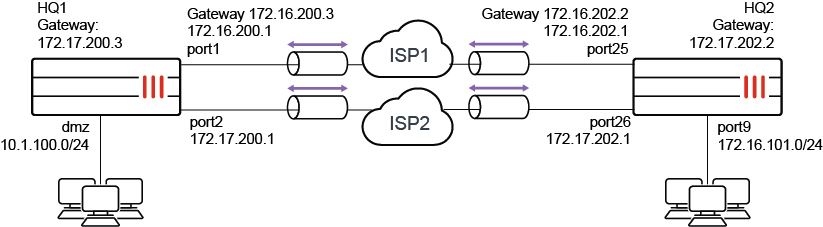

This is a sample configuration of using OSPF with IPsec VPN to set up network redundancy. Route selection is based on OSPF cost calculation. You can configure ECMP or primary/secondary routes by adjusting OSPF path cost.

Each FortiGate has two WAN interfaces connected to different ISPs. The ISP1 link is for the primary FortiGate and the IPS2 link is for the secondary FortiGate.

- Configure IPsec phase1-interface and phase-2 interface. On each FortiGate, configure two IPsec tunnels: a primary and a secondary.
