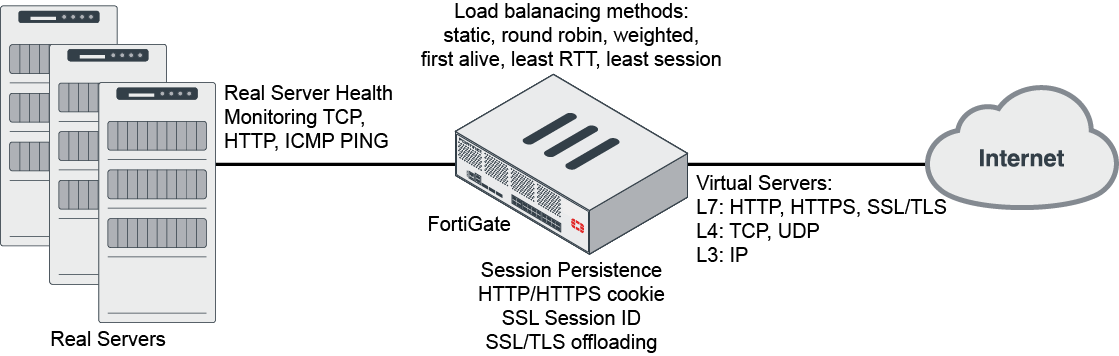

This topic shows a special virtual IP type: virtual server. Use this type of VIP to implement server load balancing.
The FortiOS server load balancing contains all the features of a server load balancing solution. You can balance traffic across multiple backend servers based on multiple load balancing schedules including:
  • Static (failover)
  • Round robin
  • Weighted (to account for different sized servers or based on the health and performance of the server including round trip time and number of connections)
The load balancer supports HTTP, HTTPS, IMAPS, POP3S, SMTPS, SSL/TLS, and generic TCP/UDP and IP protocols. Session persistence is supported based on the SSL session ID based on an injected HTTP cookie, or based on the HTTP or HTTPS host. SSL/TLS load balancing includes protection from protocol downgrade attacks. Server load balancing is supported on most FortiGate devices and includes up to 10,000 virtual servers on high end systems.
The FortiGate 90E and 91E do not support load balancing of secure protocols (HTTPS, IMAPS, POP3S, SMTPS and SSL).
FortiOS HTTP and HTTPS server load balancing does not support load balancing based on URL routing. You can use FortiWeb server pools or FortiADC server load balancing to load balance sessions to two or more URL based routes.
A policy with proxy-based inspection can accept all types of protocols configured in the Virtual Server object. However, a policy with flow-based inspection can only accept TCP/UDP/IP types in the Virtual Server object.
Sample topology
SSL/TLS offloading
FortiGate SSL/TLS offloading is designed for the proliferation of SSL/TLS applications. The key exchange and encryption/decryption tasks are offloaded to the FortiGate unit where they are accelerated using FortiASIC technology which provides significantly more performance than a standard server or load balancer. This frees up valuable resources on the server farm to give better response to business operations. Server load balancing offloads most SSL/TLS versions including SSL 3.0, TLS 1.0, and TLS 1.2, and supports full mode or half mode SSL offloading with DH key sizes up to 4096 bits.
FortiGate SSL offloading allows the application payload to be inspected before it reaches your servers. This prevents intrusion attempts, blocks viruses, stops unwanted applications, and prevents data leakage. SSL/TLS content inspection supports TLS versions 1.0, 1.1, and 1.2 and SSL versions 1.0, 1.1, 1.2, and 3.0.

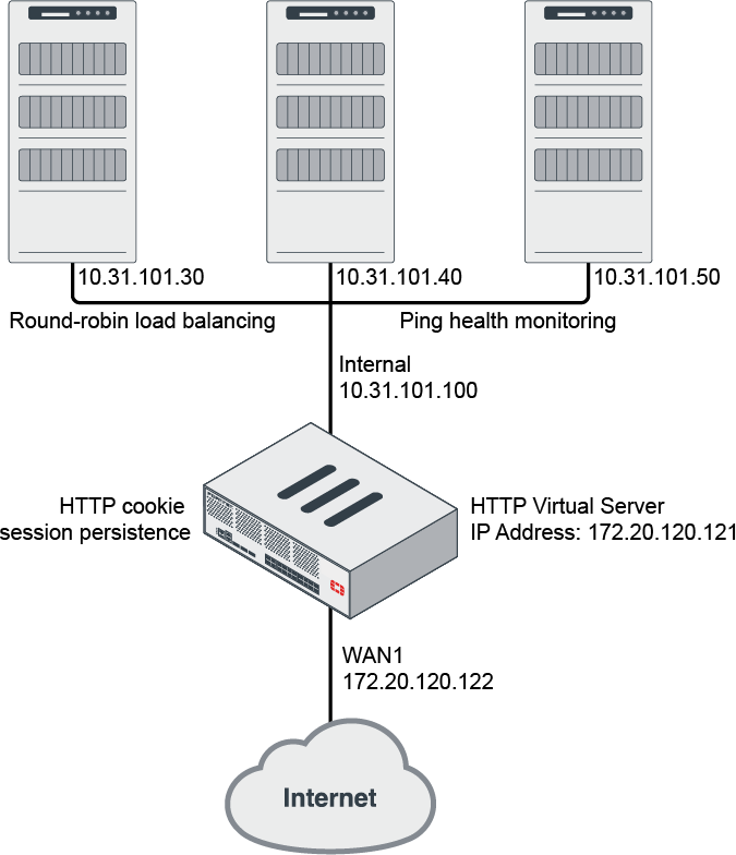

Sample of HTTP load balancing to three real web servers
This example describes the steps to configure the load balancing configuration below. In this configuration, a FortiGate unit is load balancing HTTP traffic from the Internet to three HTTP servers on the internal network. HTTP sessions are accepted at the wan1 interface with destination IP address 172.20.120.121 on TCP port 8080, and forwarded from the internal interface to the web servers. When forwarded, the destination address of the session is translated to the IP address of one of the web servers.
This load balancing configuration also includes session persistence using HTTP cookies, round-robin load balancing, and TCP health monitoring for the real servers. Ping health monitoring consists of the FortiGate unit using ICMP ping to ensure the web servers can respond to network traffic.

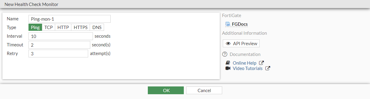

  1. Create a health check monitor.
    A ping health check monitor causes the FortiGate to ping the real servers every 10 seconds. If one of the servers does not respond within 2 seconds, the FortiGate unit will retry the ping 3 times before assuming that the HTTP server is not responding.

To create a health check monitor:
  1. Go to Policy & Objects > Health Check.
  2. Click Create New.
  3. Set the following:
    • Name to Ping-mon-1
    • Type to Ping
    • Interval to 10 seconds
    • Timeout to 2 seconds
    • Retry to 3 attempt(s)
  4. Click OK.

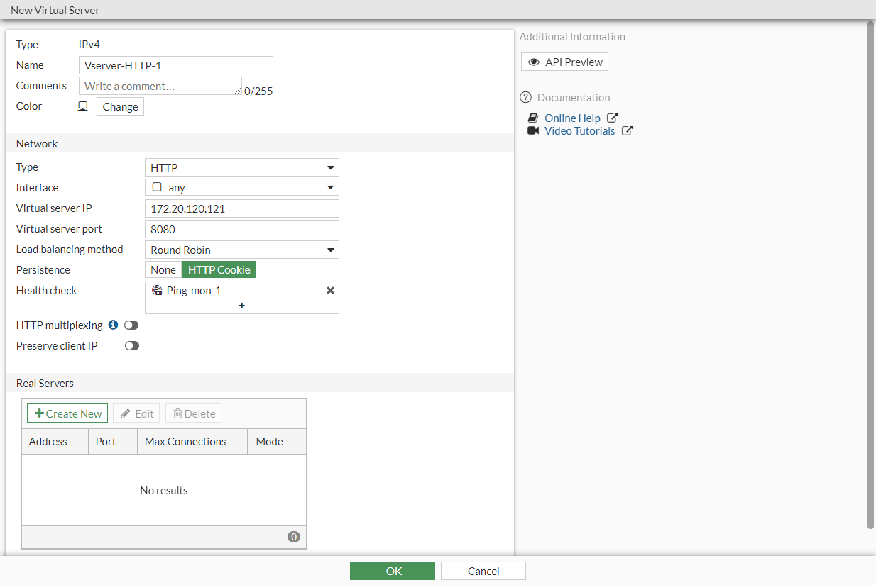

To create a virtual server:
  1. Go to Policy & Objects > Virtual Servers.
    • Name to Vserver-HTTP-1
    • Type to HTTP
    • Interface to wan1
    • Virtual Server IP to 172.20.120.121
    • Virtual Server Port to 8080
    • Load Balance Method to Round Robin
    • Persistence to HTTP Cookie
    • Health Check to Ping-mon-1

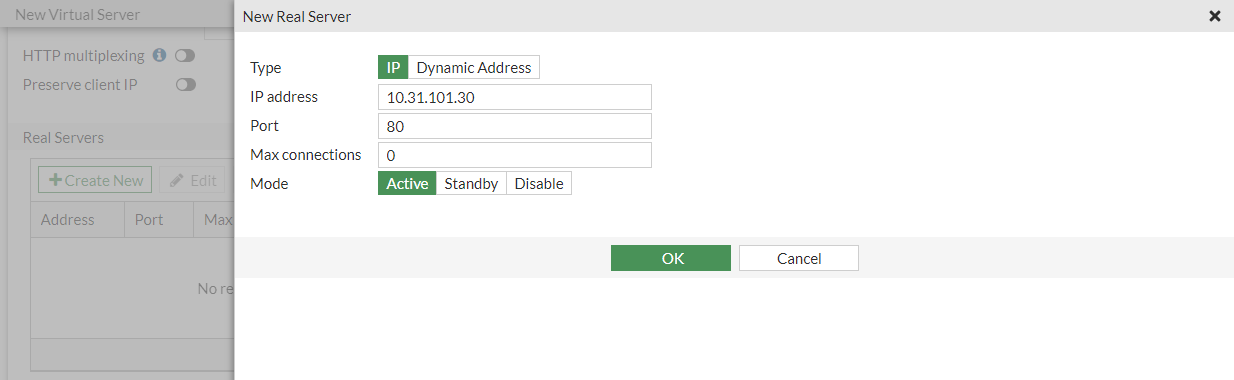

  4. In the Real Servers table, click Create New.
  5. Set the following for the first real server:
    • Type to IP
    • IP Address to 10.31.101.30
    • Port to 80
    • Max Connections to 0
    • Mode to Active
  6. Click OK. Configure two more real servers with IP addresses 10.31.101.40 and 10.31.101.50, and the same settings as the first real server.
  7. Click OK.

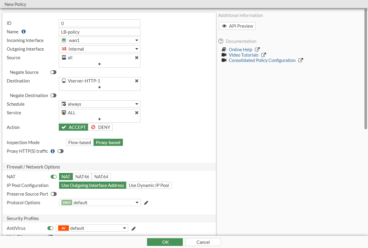

To create a security policy that includes the load balance virtual server as the destination address:
  3. Set the Inspection Mode to Proxy-based. A flow-based firewall policy can only accept TCP/UDP/IP type virtual servers.
  4. Set the following:
    • Name to LB-policy
    • Incoming Interface to wan1
    • Outgoing Interface to internal
    • Source to all
    • Destination to Vserver-HTTP-1
    • Schedule to always
    • Service to ALL
    • Action to ACCEPT
  5. Enable NAT and set IP Pool Configuration to Use Outgoing Interface Address.
  6. Enable AntiVirus and select an antivirus profile.
  7. Click OK.

  1. Create a health check monitor:
    config firewall ldb-monitor
        edit "Ping-mon-1"
            set type ping
            set interval 10
            set timeout 2
            set retry 3
  2. Create a virtual server:
    config firewall vip
        edit "Vserver-HTTP-1"
            set type server-load-balance
            set extip 172.20.120.121
            set extintf "any"
            set server-type http
            set monitor "Ping-mon-1"
            set ldb-method round-robin
            set persistence http-cookie
            set extport 8080
            config realservers
                    set type ip
                    set ip 10.31.101.30
                    set port 80
                    set type ip
                    set ip 10.31.101.40
                    set port 80
                edit 3
                    set type ip
                    set ip 10.31.101.50
                    set port 80
  3. Add the load balancing virtual server to a policy as the destination address:
    config firewall policy
            set name "LB-policy"
            set inspection-mode proxy
            set srcintf "wan1"
            set dstintf "internal"
            set srcaddr "all"
            set dstaddr "Vserver-HTTP-1"
            set service "ALL"
            set utm-status enable
            set av-profile "default"
            set fsso disable
            set nat enable
Results
Traffic accessing 172.20.120.121:8080 is forwarded in turn to the three real servers.
If the access request has an http-cookie, FortiGate forwards the access to the corresponding real server according to the cookie.

In the FortiGate GUI, you can configure health check monitoring so that the FortiGate unit can verify that real servers are able respond to network connection attempts. If a real server responds to connection attempts, the load balancer continues to send sessions to it. If a real server stops responding to connection attempts, the load balancer assumes that the server is down and does not send sessions to it. The health check monitor configuration determines how the load balancer tests real servers. You can use a single health check monitor for multiple load balancing configurations. You can configure TCP, HTTP, DNS, and ping health check monitors. You usually set the health check monitor to use the same protocol as the traffic being load balanced to it. For example, for an HTTP load balancing configuration, you would normally use an HTTP health check monitor.
Session persistence
Use persistence to ensure a user is connected to the same real server every time the user makes an HTTP, HTTPS, or SSL request that is part of the same user session. For example, if you are load balancing HTTP and HTTPS sessions to a collection of eCommerce web servers, when users make a purchase, they will be starting multiple sessions as they navigate the eCommerce site. In most cases, all the sessions started by this user during one eCommerce session should be processed by the same real server. Typically, the HTTP protocol keeps track of these related sessions using cookies. HTTP cookie persistence ensure all sessions that are part of the same user session are processed by the same real server.
When you configure persistence, the FortiGate unit load balances a new session to a real server according to the load balance method. If the session has an HTTP cookie or an SSL session ID, the FortiGate unit sends all subsequent sessions with the same HTTP cookie or SSL session ID to the same real server.
Real servers
Add real servers to a load balancing virtual server to provide information the virtual server requires to send sessions to the server. A real server configuration includes the IP address of the real server and port number the real server receives sessions on. The FortiGate unit sends sessions to the real server’s IP address using the destination port number in the real server configuration.
When configuring a real server, you can also specify the weight (if the load balance method is set to Weighted) and you can limit the maximum number of open connections between the FortiGate unit and the real server. If the maximum number of connections is reached for the real server, the FortiGate unit automatically switches all further connection requests to other real servers until the connection number drops below the limit. Setting Maximum Connections to 0 means that the FortiGate unit does not limit the number of connections to the real server.
    • Type to Ping
  4. Click OK.
    • Type to HTTP
    • Interface to wan1
    • Type to IP
    • Port to 80
    • Mode to Active
  7. Click OK.
    • Name to LB-policy
    • Source to all
    • Service to ALL
    • Action to ACCEPT
  7. Click OK.
