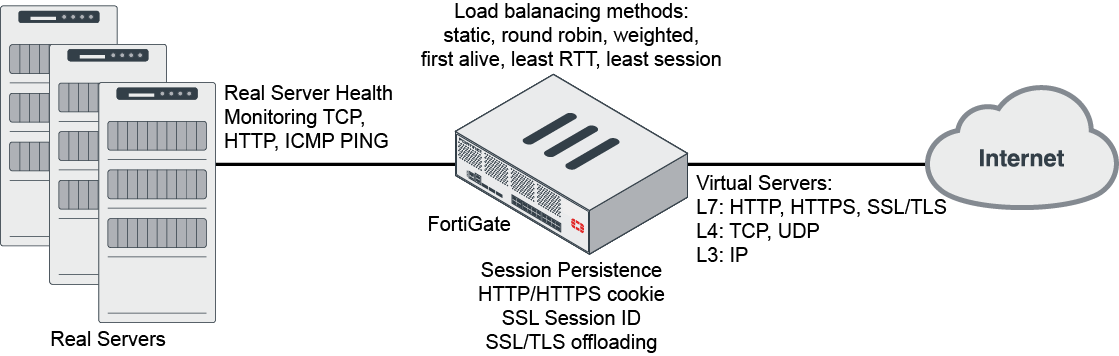

The FortiOS server load balancing contains all the features of a server load balancing solution. You can balance traffic across multiple backend servers based on multiple load balancing schedules including:
- Static (failover)
- Round robin
- Weighted (to account for different sized servers or based on the health and performance of the server including round trip time and number of connections)
The load balancer supports HTTP, HTTPS, IMAPS, POP3S, SMTPS, SSL/TLS, and generic TCP/UDP and IP protocols. Session persistence is supported based on the SSL session ID based on an injected HTTP cookie, or based on the HTTP or HTTPS host. SSL/TLS load balancing includes protection from protocol downgrade attacks. Server load balancing is supported on most FortiGate devices and includes up to 10,000 virtual servers on high end systems.
FortiOS HTTP and HTTPS server load balancing does not support load balancing based on URL routing. You can use FortiWeb server pools or FortiADC server load balancing to load balance sessions to two or more URL based routes. |

Load balancing methods
The load balancing method defines how sessions are load balanced to real servers.
All load balancing methods do not send traffic to real servers that are down or not responding. FortiGate can only determine if a real server is not responding by using a health check monitor. You should always add at least one health check monitor to a virtual server or to real servers; otherwise load balancing might try to distribute sessions to real servers that are not functioning.
Static |
The traffic load is statically spread evenly across all real servers. Sessions are not assigned according to how busy individual real servers are. This load balancing method provides some persistence because all sessions from the same source address always go to the same real server. Because the distribution is stateless, so if a real server is added, removed, or goes up or down, the distribution is changed and persistence might be lost. |
Round Robin |
Directs new requests to the next real server. This method treats all real servers as equals regardless of response time or the number of connections. This method does not direct requests to real servers that down or non responsive. |
Weighted |
Real servers with a higher weight value receive a larger percentage of connections. Set the real server weight when adding a real server. |
Least Session |
Directs requests to the real server that has the least number of current connections. This method works best in environments where the real servers or other equipment you are load balancing all have similar capabilities. This load balancing method uses the FortiGate session table to track the number of sessions being processed by each real server. The FortiGate unit cannot detect the number of sessions actually being processed by a real server. |
Least RTT |
Directs sessions to the real server with the lowest round trip time. The round trip time is determined by a ping health check monitor. The default is 0 if no ping health check monitors are added to the virtual server. |
First Alive |
Directs sessions to the first live real server. This load balancing schedule provides real server failover protection by sending all sessions to the first live real server. If a real server fails, all sessions are sent to the next live real server. Sessions are not distributed to all real servers so all sessions are processed by the first real server only. |
HTTP Host |
Load balances HTTP host connections across multiple real servers using the host’s HTTP header to guide the connection to the correct real server. |

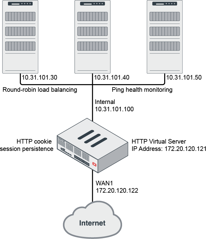

Sample of HTTP load balancing to three real web servers
This example describes the steps to configure the load balancing configuration below. In this configuration, a FortiGate unit is load balancing HTTP traffic from the Internet to three HTTP servers on the internal network. HTTP sessions are accepted at the wan1 interface with destination IP address 172.20.120.121 on TCP port 8080, and forwarded from the internal interface to the web servers. When forwarded, the destination address of the session is translated to the IP address of one of the web servers.
This load balancing configuration also includes session persistence using HTTP cookies, round-robin load balancing, and TCP health monitoring for the real servers. Ping health monitoring consists of the FortiGate unit using ICMP ping to ensure the web servers can respond to network traffic.

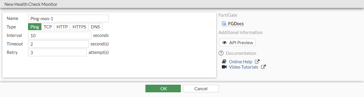

To create a health check monitor:
- Go to Policy & Objects > Health Check.
- Click Create New.
- Set the following:
- Name to Ping-mon-1
- Type to Ping
- Interval to 10 seconds
- Timeout to 2 seconds
- Retry to 3 attempt(s)
- Click OK.

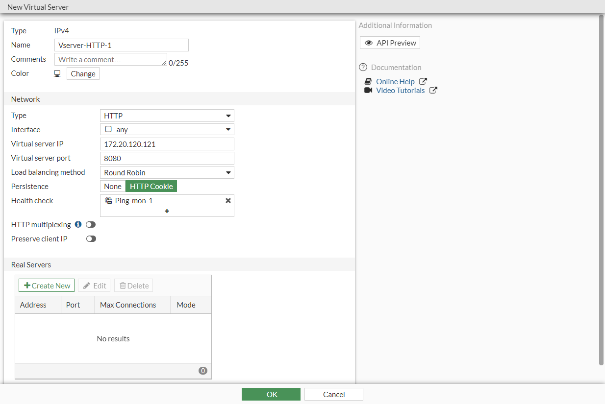

To create a virtual server:
- Go to Policy & Objects > Virtual Servers.
- Click Create New.
- Name to Vserver-HTTP-1
- Type to HTTP
- Interface to wan1
- Virtual Server IP to 172.20.120.121
- Virtual Server Port to 8080
- Load Balance Method to Round Robin
- Persistence to HTTP Cookie
- Health Check to Ping-mon-1

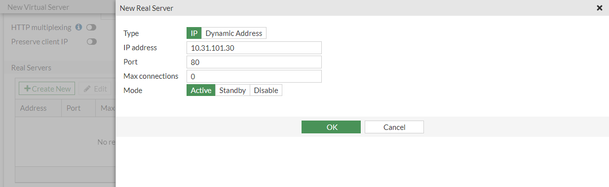

- In the Real Servers table, click Create New.
- Set the following for the first real server:
- Type to IP
- IP Address to 10.31.101.30
- Port to 80
- Max Connections to 0
- Mode to Active
- Click OK. Configure two more real servers with IP addresses 10.31.101.40 and 10.31.101.50, and the same settings as the first real server.
- Click OK.

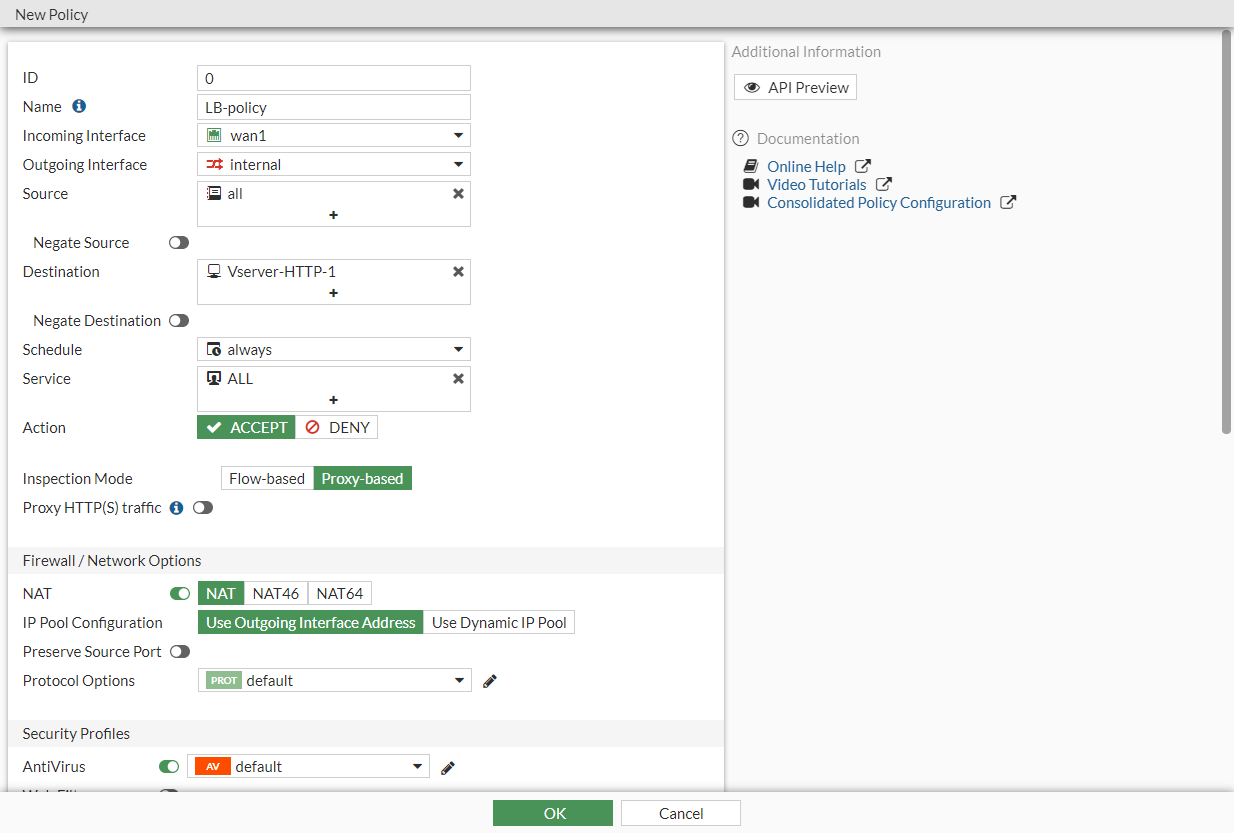

To create a security policy that includes the load balance virtual server as the destination address:
- Go to Policy & Objects > Firewall Policy.
- Click Create New.
- Set the Inspection Mode to Proxy-based. The new virtual server will not be available if the inspection mode is Flow-based.
- Name to LB-policy
- Incoming Interface to wan1
- Outgoing Interface to internal
- Source to all
- Destination to Vserver-HTTP-1
- Schedule to always
- Service to ALL
- Action to ACCEPT
- Enable NAT and set IP Pool Configuration to Use Outgoing Interface Address.
- Enable AntiVirus and select an antivirus profile.
- Click OK.
