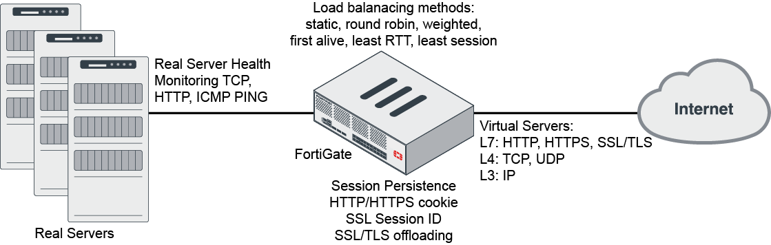

Sample topology
SSL/TLS offloading
FortiGate SSL/TLS offloading is designed for the proliferation of SSL/TLS applications. The key exchange and encryption/decryption tasks are offloaded to the FortiGate unit where they are accelerated using FortiASIC technology which provides significantly more performance than a standard server or load balancer. This frees up valuable resources on the server farm to give better response to business operations. Server load balancing offloads most SSL/TLS versions including SSL 3.0, TLS 1.0, and TLS 1.2, and supports full mode or half mode SSL offloading with DH key sizes up to 4096 bits.
FortiGate SSL offloading allows the application payload to be inspected before it reaches your servers. This prevents intrusion attempts, blocks viruses, stops unwanted applications, and prevents data leakage. SSL/TLS content inspection supports TLS versions 1.0, 1.1, and 1.2 and SSL versions 1.0, 1.1, 1.2, and 3.0.

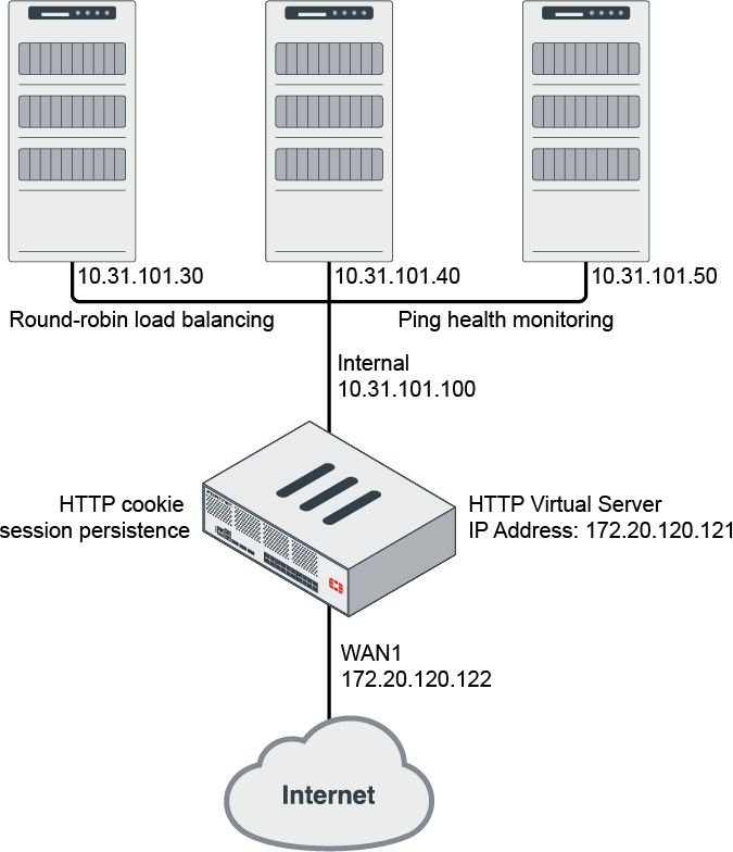

This example describes the steps to configure the load balancing configuration below. In this configuration, a FortiGate unit is load balancing HTTP traffic from the Internet to three HTTP servers on the internal network. HTTP sessions are accepted at the wan1 interface with destination IP address 172.20.120.121 on TCP port 8080, and forwarded from the internal interface to the web servers. When forwarded, the destination address of the session is translated to the IP address of one of the web servers.
This load balancing configuration also includes session persistence using HTTP cookies, round-robin load balancing, and TCP health monitoring for the real servers. Ping health monitoring consists of the FortiGate unit using ICMP ping to ensure the web servers can respond to network traffic.

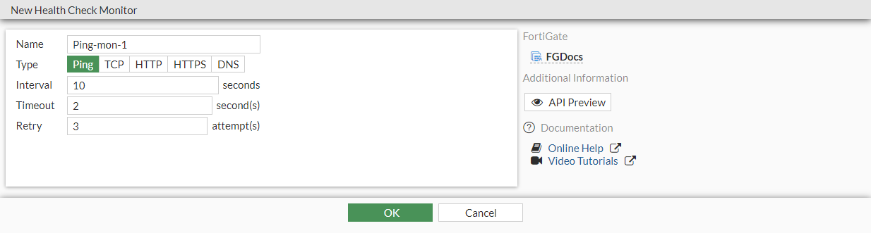

A ping health check monitor causes the FortiGate to ping the real servers every 10 seconds. If one of the servers does not respond within 2 seconds, the FortiGate unit will retry the ping 3 times before assuming that the HTTP server is not responding.

To create a health check monitor:
- Go to Policy & Objects > Health Check.
- Click Create New.
- Set the following:
- Name to Ping-mon-1
- Type to Ping
- Interval to 10 seconds
- Timeout to 2 seconds
- Retry to 3 attempt(s)
- Click OK.

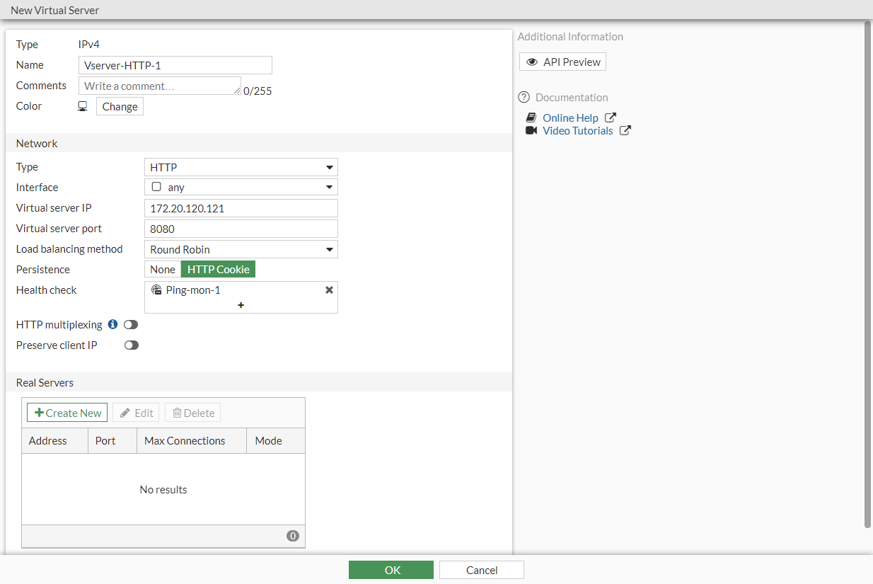

To create a virtual server:
- Go to Policy & Objects > Virtual Servers.
- Click Create New.
- Name to Vserver-HTTP-1
- Type to HTTP
- Interface to wan1
- Virtual Server IP to 172.20.120.121
- Virtual Server Port to 8080
- Load Balance Method to Round Robin
- Persistence to HTTP Cookie
- Health Check to Ping-mon-1
- In the Real Servers table, click Create New.

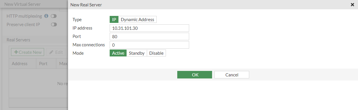

- Set the following for the first real server:
- Type to IP
- IP Address to 10.31.101.30
- Port to 80
- Max Connections to 0
- Mode to Active
- Click OK. Configure two more real servers with IP addresses 10.31.101.40 and 10.31.101.50, and the same settings as the first real server.
- Click OK.

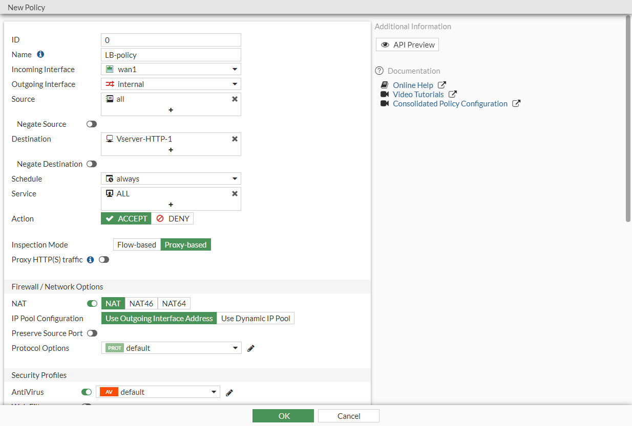

To create a security policy that includes the load balance virtual server as the destination address:
- Go to Policy & Objects > Firewall Policy.
- Click Create New.
- Set the Inspection Mode to Proxy-based. The new virtual server will not be available if the inspection mode is Flow-based.
- Name to LB-policy
- Incoming Interface to wan1
- Outgoing Interface to internal
- Source to all
- Destination to Vserver-HTTP-1
- Schedule to always
- Service to ALL
- Action to ACCEPT
- Enable NAT and set IP Pool Configuration to Use Outgoing Interface Address.
- Enable AntiVirus and select an antivirus profile.
- Click OK.
