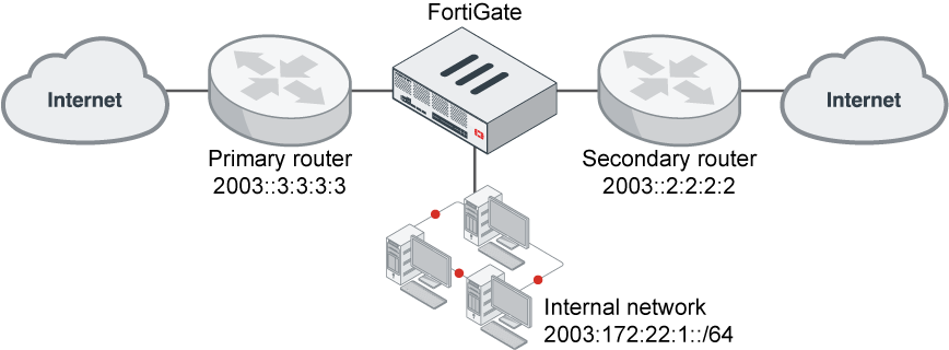

BGP conditional advertisement allows the router to advertise a route only when certain conditions are met. Multiple conditions can be used together, with conditional route map entries treated as an AND operator, and IPv6 is supported.
Multiple conditions example
In this example, the FortiGate only advertises routes to its neighbor 2.2.2.2 if it learns multiple BGP routes defined in its conditional route map entry. All conditionals must be met.

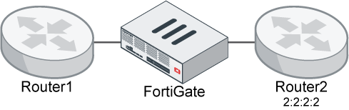

In this example, the FortiGate advertises its local network to the secondary router when the primary router is down. The FortiGate detects the primary router is down in the absence of a learned route.
  • When the FortiGate learns route 2003:172:28:1::/64 from the primary router, it does not advertise its local route (2003:172:22:1::/64) to the secondary router.
  • When the FortiGate does not learn route 2003:17:28:1::/64 from the primary router, advertises its local route (2003:172:22:1::/64) to the secondary router.
  • The BGP conditional advertisement condition is set to be true if the condition route map (2003:172:28:1::/64) is not matched (non-exist).
To configure BGP conditional advertisement with IPv6:

  2. Verify the routing table:
    # get router info6 routing-table bgp
    B       2003:172:28:1::/64 [200/0] via 2003::3:3:3:3 (recursive via ****::***:***:****:****, port9), 01:23:45
    B       2003:172:28:2::/64 [200/0] via 2003::3:3:3:3 (recursive via ****::***:***:****:****, port9), 23:09:22
When the FortiGate learns 2003:172:28:1::/64, it will advertise its local route 2003:172:22:1::/64 to neighbor 2003::2:2:2:2. If the FortiGate has not learned route 2003:172:28:1::/64, it will not advertise its local route 2003:172:22:1::/64 to neighbor 2003::2:2:2:2.
