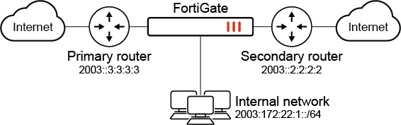

IPv6 example 1
In this example, the FortiGate advertises its local network to the secondary router when the primary router is down. The FortiGate detects the primary router is down in the absence of a learned route.
  • When the FortiGate learns route 2003:172:28:1::/64 from the primary router, it does not advertise its local route (2003:172:22:1::/64) to the secondary router.
  • When the FortiGate does not learn route 2003:17:28:1::/64 from the primary router, advertises its local route (2003:172:22:1::/64) to the secondary router.
  • The BGP conditional advertisement condition is set to be true if the condition route map (2003:172:28:1::/64) is not matched (non-exist).

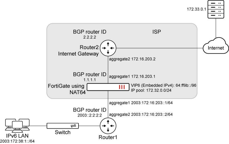

NAT64 example
In this example, the FortiGate uses NAT64 where the LAN via Router1 uses IPv6 and where Router2 is the internet gateway using IPv4.
This example assumes a pure NAT64 design with the following expectations:
  • IPv4 IP pools would be announced to Internet gateway when IPv6 client subnets learned from IPv6 route.
  • IPv6 virtual IP addresses (VIPs) (default = 64:ff9b::/96) would be announced to Router 1 when IPv4 default route learned from Internet gateway.
The administrator of the FortiGate has the following requirements, which are implemented using IPv4 and IPv6 conditional advertisements:
  • The FortiGate needs to announce IPv4 pools for NAT translation towards the internet gateway only if the IPv6 prefix exists in the routing table.
  • The FortiGate needs to advertise the IPv6 address towards the LAN only if the IPv4 default route exists on the FortiGate.

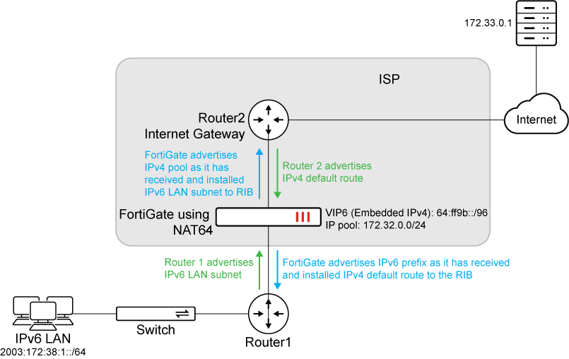

The below diagram details the flow of routing advertisements:
The prefixes defined in IPv4 route map 2814 and IPv6 route map map-281 both exist, so the FortiGate advertises the route map prefix in route-map 2224 (172.22.2.0/255.255.255.0) to its BGP neighbor 2.2.2.2.
For IPv6 neighbor 2003::2:2:2:2, the prefixes defined in IPv4 route map 2874 and IPv6 route map map-38 both do not exist, and the condition-type is set to non-exist, so the FortiGate advertises the route map prefix in route map map-222 (2003:172:22:1::/64) to its BGP neighbor 2003::2:2:2:2.
When the global cross-family-conditional-adv enabled, this is the only time the FortiGate will cross-check the address family; otherwise, it only checks the corresponding conditional map and treats the cross-family addresses as non-existent.

IPv6 example 1

    In this configuration, if route map map-281 does not exist, then the FortiGate advertises route map map-221 to neighbor 2003::2:2:2:2.
  4. Verify the routing table:
    # get router info6 routing-table bgp
    B       2003:172:28:1::/64 [200/0] via 2003::3:3:3:3 (recursive via ****::***:***:****:****, port9), 01:23:45
    B       2003:172:28:2::/64 [200/0] via 2003::3:3:3:3 (recursive via ****::***:***:****:****, port9), 23:09:22
When the FortiGate learns 2003:172:28:1::/64, it will not advertise its local route 2003:172:22:1::/64 to neighbor 2003::2:2:2:2. If the FortiGate has not learned 2003:172:28:1::/64, it will advertise its local route 2003:172:22:1::/64 to neighbor 2003::2:2:2:2.

NAT64 example
