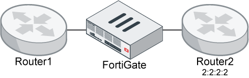

Multiple conditions example
In this example, the FortiGate only advertises routes to its neighbor 2.2.2.2 if it learns multiple BGP routes defined in its conditional route map entry. All conditionals must be met.

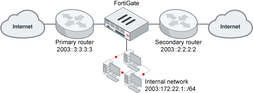

IPv6 example 1
In this example, the FortiGate advertises its local network to the secondary router when the primary router is down. The FortiGate detects the primary router is down in the absence of a learned route.
When the FortiGate learns route 2003:172:28:1::/64 from the primary router, it does not advertise its local route (2003:172:22:1::/64) to the secondary router.
When the FortiGate does not learn route 2003:17:28:1::/64 from the primary router, advertises its local route (2003:172:22:1::/64) to the secondary router.
