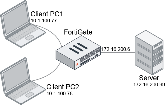

In this example, multiple clients submit requests in HTTP. The requests hit the VIP address, and then FortiGate opens a session between itself (172.16.200.6) and the server (172.16.200.99). The coalescing occurs in this session as the multiple streams share the same session to connect to the same destination server.

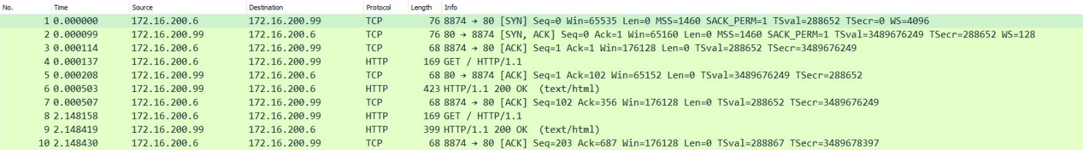

Get the clients to access the server through the explicit web proxy (10.1.100.6:8080). The FortiGate shares the first connection TCP three-way handshake with later connections that connect to same destination address.
Verify the sniffer packet capture on the FortiGate server side. There is one TCP three-way handshake, but there are two HTTP connections.

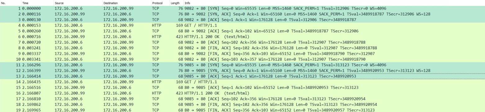

Change the HTTP connection mode to static:
config web-proxy explicit set status enable set http-incoming-port 8080 set http-connection-mode static end -
Verify the sniffer packet capture. This time, the FortiGate establishes a TCP connection for each client.
