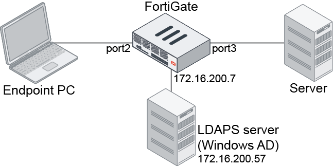

In this example, the FortiGate is configured as an explicit web proxy. It connects to the Windows AD server through LDAPS, where the Windows server requires a client certificate to connect. The client certificate is configured in the CLI.
The endpoint PC connecting to the web server will first need to authenticate to the explicit web proxy before accessing the server.
While this example demonstrates an LDAP client certificate for an explicit proxy configuration, LDAP client certificates can be used in firewall authentication, transparent proxy, ZTNA, and where ever LDAP configurations are used on the FortiGate.

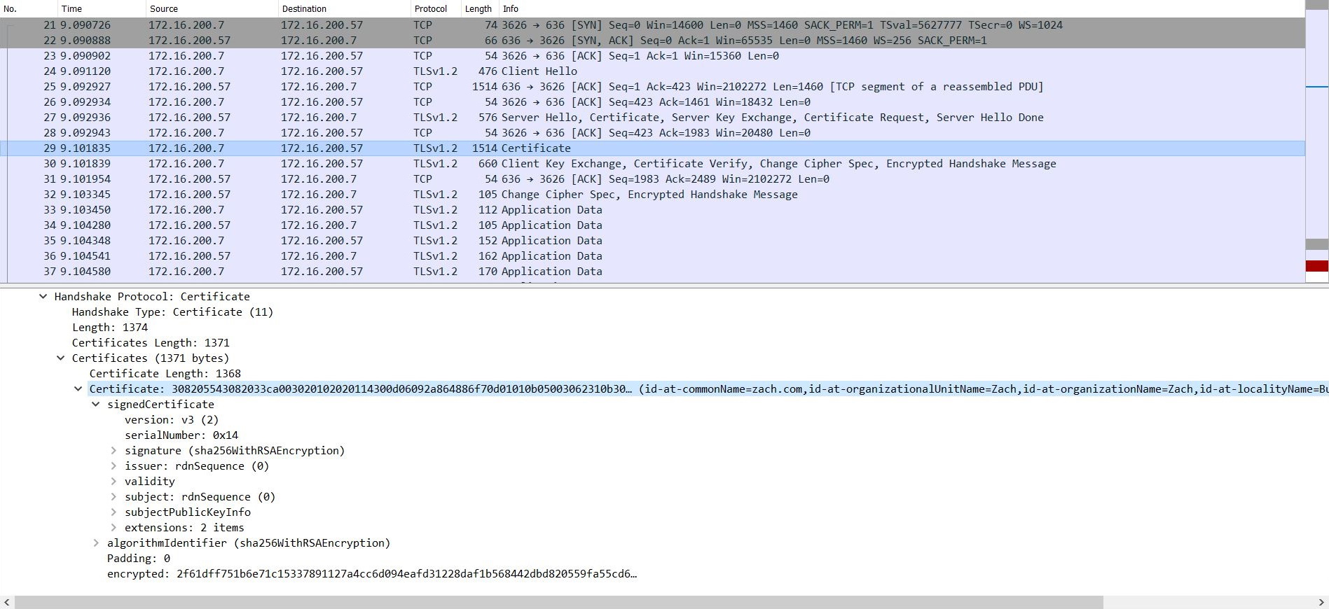

Testing and verification
When traffic from the endpoint PC matches a policy and triggers authentication, the FortiGate starts the LDAPS TLS connection handshake with the Windows AD. The LDAPS server requests a client certificate to identify the FortiGate as a client. The FortiGate provides a configured client certificate, issued to zach.com, to the LDAPS server.
The following communication between the FortiGate and the LDAPS server shows the client certificate is sent by the FortiGate:
