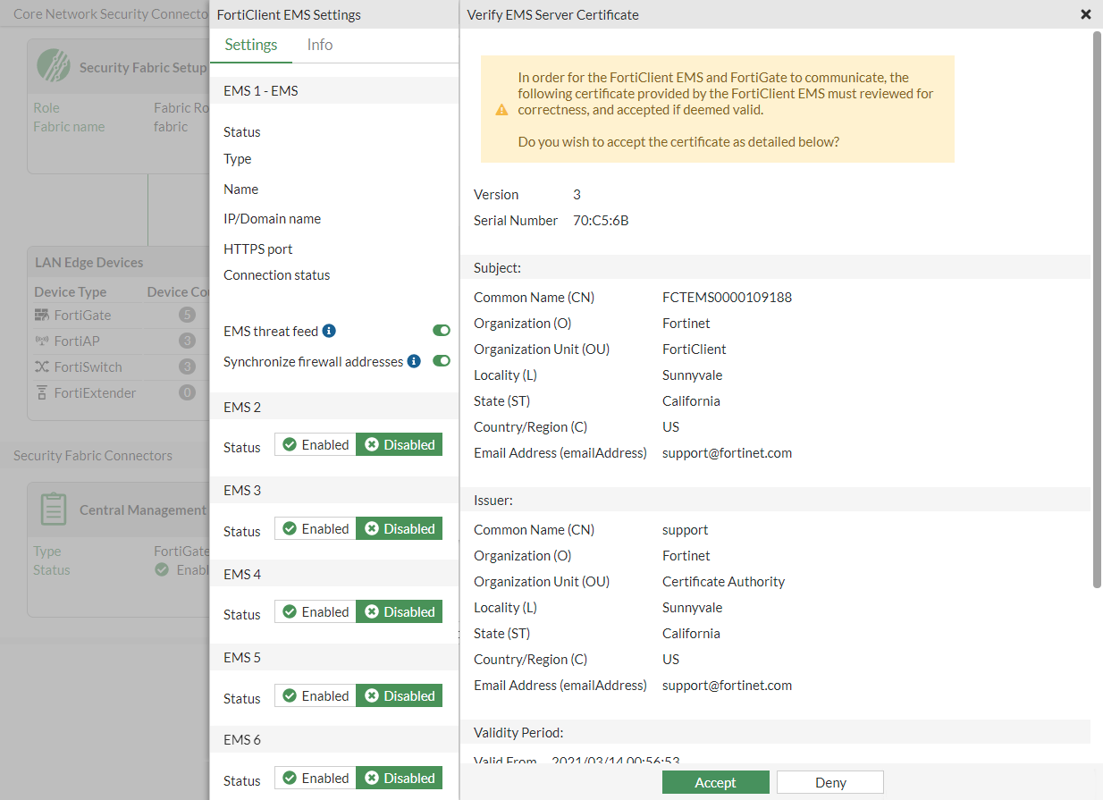

    A window appears to verify the EMS server certificate:
  7. Click Accept.

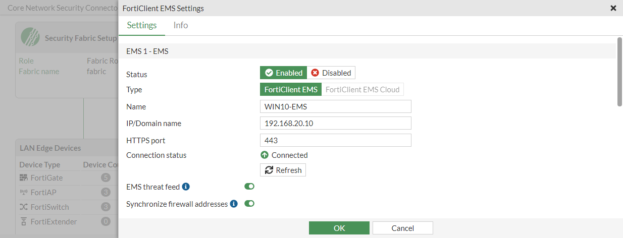

    The Connection status is now Connected:
  8. If the device is not authorized, log in to the FortiClient EMS to authorize the FortiGate under Administration > Fabric Devices.

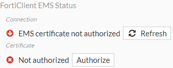

When configuring a new connection to an EMS server, the certificate might not be trusted.
When you click Authorize, a warning displays: The server certificate cannot be authenticated with installed CA certificates. Please install its CA certificates on this FortiGate.
In the CLI, an error message displays when you try to verify the certificate:
# execute fctems verify Win2K16-EMS
certificate not configured/verified: 2
Could not verify server certificate based on current certificate authorities.
Error 1--92-60-0 in get SN call: EMS Certificate is not signed by a known CA.
The default FortiClient EMS certificate that is used for the SDN connection is signed by the CA certificate that is saved on the Windows server when FortiClient EMS is first installed. You can manually export and install it on the FortiGate.

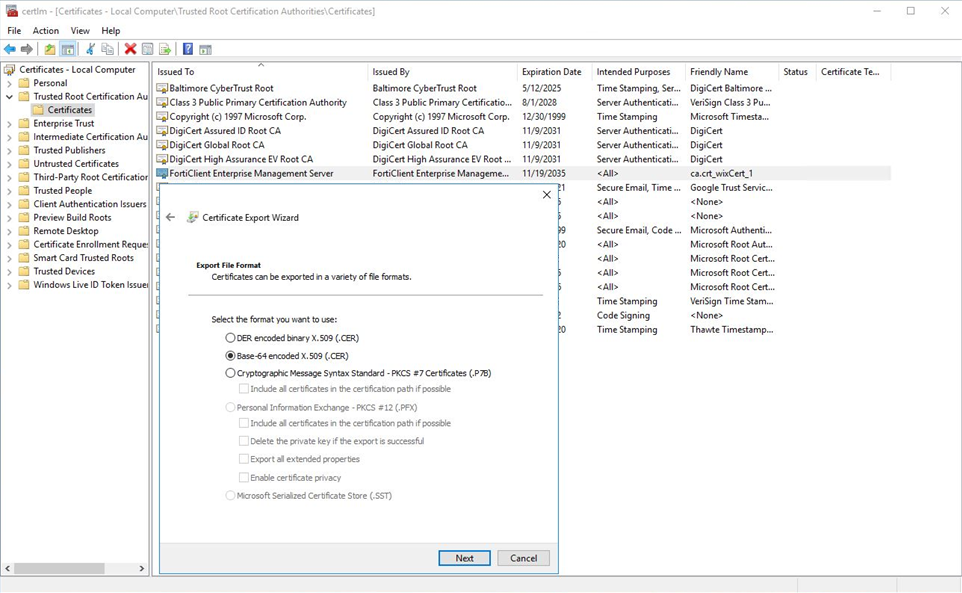

  1. Export the EMS certificate on the server that EMS is installed on:
    1. On the Windows server that EMS is installed on, go to Settings > Manage computer certificates.
    2. In the certificate management module, go to Trusted Root Certification Authorities > Certificates.
    3. Right click on the certificate issued by FortiClient Enterprise Management Server and select All Tasks > Export.
    4. The Certificate Export Wizard opens. Click Next.
    5. Select Base-64 encoded X.509, then click Next.
    6. Enter a file name for the certificate and click Browse to select the folder where it will be located, then click Next.
    7. Review the settings, then click Finish. The certificate is downloaded to the specified folder.

  3. Try to authorize the certificate on the FortiGate:
    1. Go to Security Fabric > Fabric Connectors and edit the FortiClient EMS connector. The connection status should now say that the certificate is not authorized.
    2. Click Authorize. The following warning is shown:
      The warning can also be seen in the CLI:
      failure in certificate configuration/verification: -4
      Could not verify EMS. Error 1--94-0-401 in get SN call: Authentication denied.
  4. Authorize the FortiGate on EMS:
    1. Log in to the EMS server console and go to Administration > Fabric Devices.
    2. Select the serial number of the FortiGate device, then click Authorize.
  5. Try to authorize the certificate on the FortiGate again:
    1. On the FortiGate, go to Security Fabric > Fabric Connectors and edit the FortiClient EMS card.
    2. Click Refresh.
    3. When presented with the EMS server certificate, click Accept to accept the certificate.
      Your connection should now be successful and authorized.

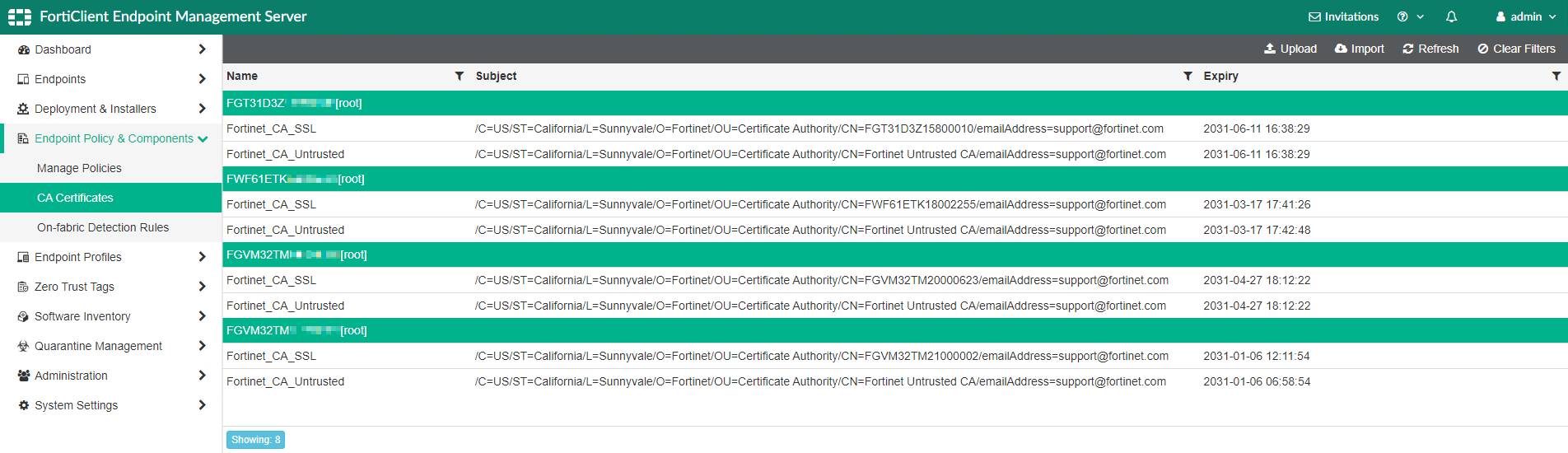

  4. In EMS, verify that the CA certificate was pushed to EMS:
    1. Go to Endpoint Policy & Components > CA Certificates.
    2. Verify the certificate table to see that the EMS server received the CA certification from the different FortiGates.

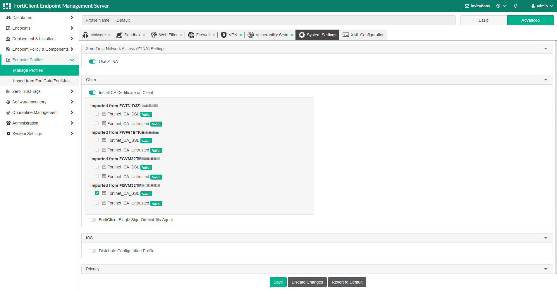

  5. Select the CA certificate in the endpoint profile:
    1. Go to Endpoint Profiles > Manage Profiles and edit a profile. The default profile is used in this example.
    2. Click Advanced in the top right corner and click the System Settings tab.
    3. In the Other section, enable Install CA Certificate on Client and select the Fortinet_CA_SSL certificate for the desired endpoint.
    4. Click Save.
    5. Once the FortiClient endpoint is registered, it receives the CA certificate. When the FortiClient endpoint tries to access the internet through the FortiGate with the firewall policy that has deep inspection, no warning message is displayed. The server certificate is trusted with the installed CA certificate to complete the certificate chain.

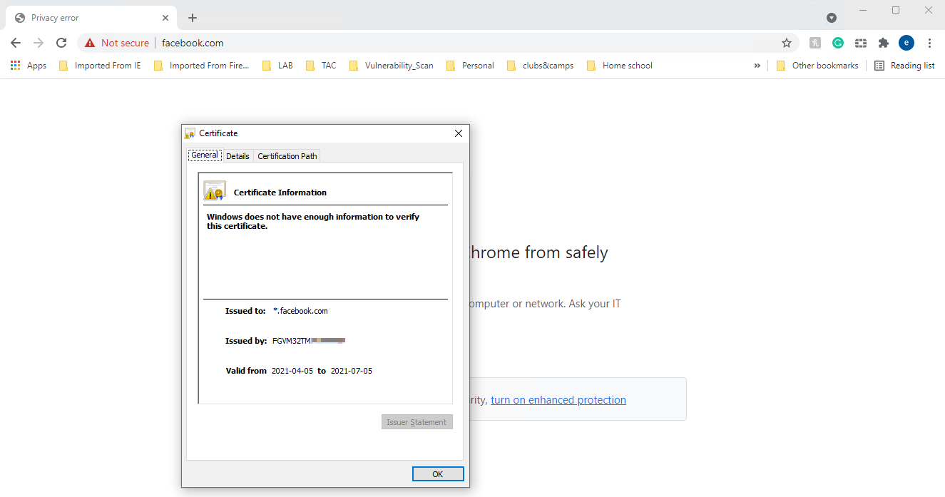

Verification

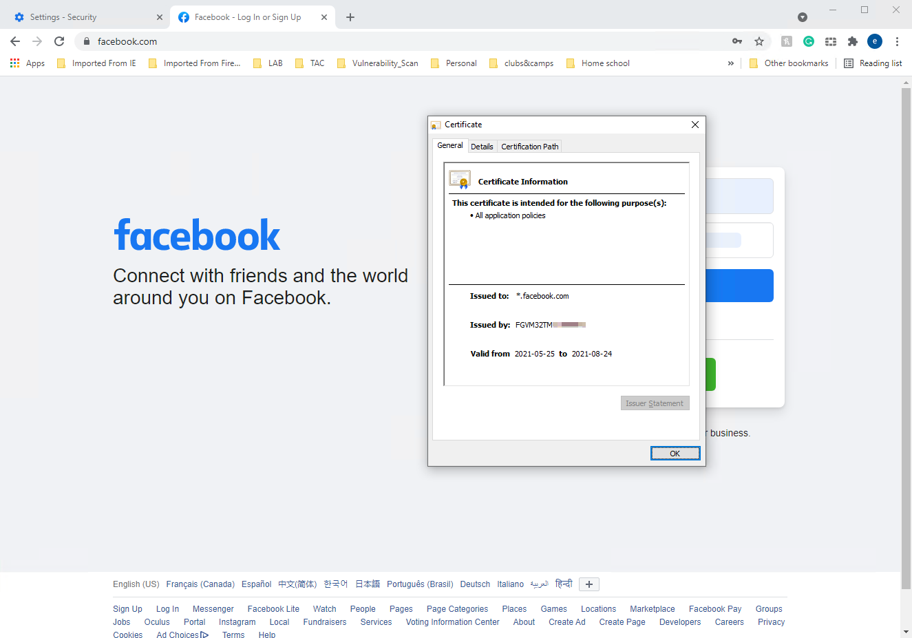

Before configuring deep inspection certificate synchronization, a warning message is displayed when a FortiClient endpoint accesses the internet through the FortiGate with the firewall policy that has deep inspection. The FortiClient certificate store does not have the FortiGate's CA that is used in the deep inspection SSL/SSH profile.
For example, accessing https://www.facebook.com in Chrome shows a warning. In the address bar, clicking Not secure > Certificate opens the Certificate dialog, which indicates that Windows does not have enough information to verify the certificate.
After the EMS profile is pushed to FortiClient endpoint, the expected FortiGate's certificate is shown in its certificate store.

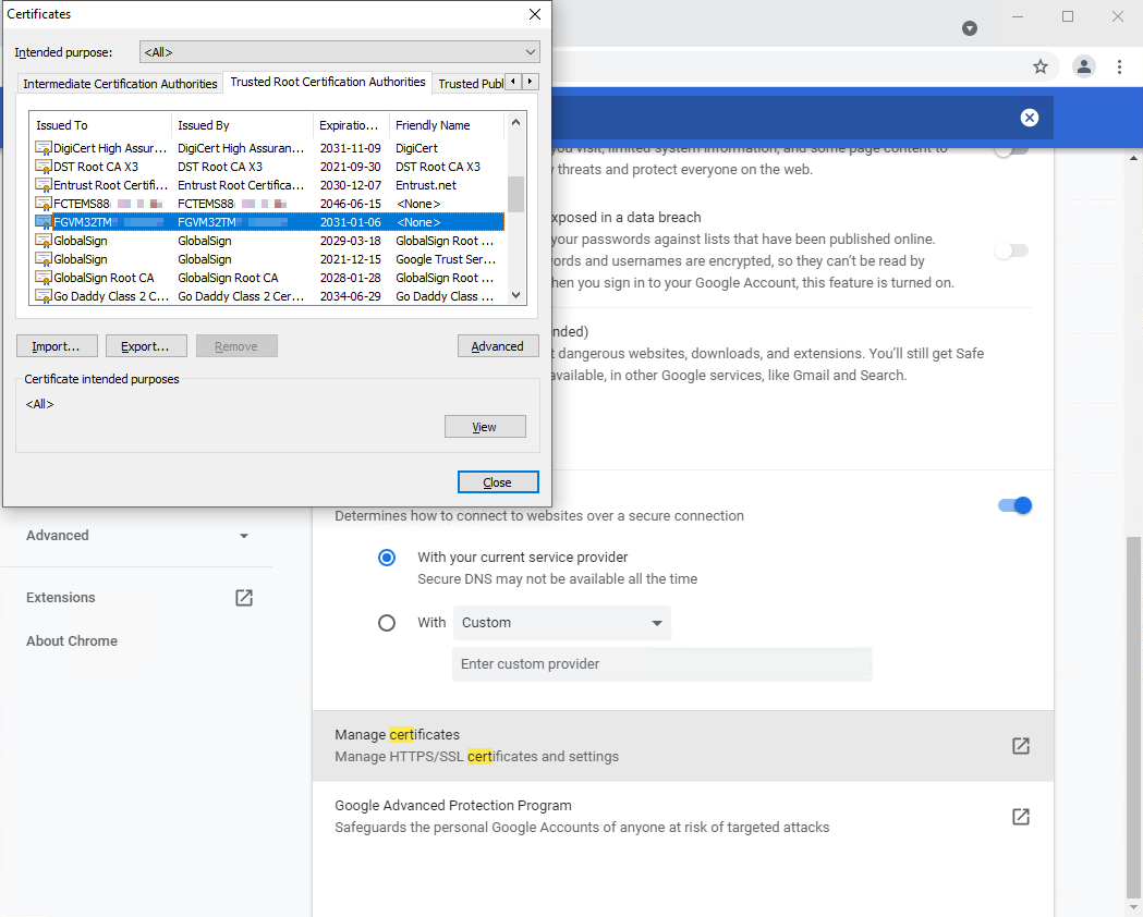

To verify the deep inspection certificate synchronization:
  1. In Chrome, go to Settings > Privacy and security and open Manage certificates.
  2. Click the Trusted Root Certification Authorities tab. The FortiGate's certificate appears in the list.
  3. On the FortiClient endpoint using Chrome, go to https://www.facebook.com. The website is displayed.
  4. In the address bar, click the padlock, then click Certificate. The dialog displays the valid certificate information.

To add an on-premise FortiClient EMS server to the Security Fabric in the GUI:
  1. On the root FortiGate, go to System > Feature Visibility and enable Endpoint Control.
  2. Go to Security Fabric > Fabric Connectors and double-click the FortiClient EMS card.
  3. In the Settings tab, set the Type to FortiClient EMS.
  4. Optionally, enable EMS Threat Feed. See Malware threat feed from EMS for more information about using this setting in an AV profile.
  5. Enter a name and IP address or FQDN. When connecting to a multitenancy-enabled EMS, Fabric connectors must use an FQDN to connect to EMS, where the FQDN hostname matches a site name in EMS (including "Default"). The following are examples of FQDNs to provide when configuring the connector to connect to the default site and to a site named SiteA, respectively: default.ems.yourcompany.com, sitea.ems.yourcompany.com. See Multitenancy.
  6. Click OK.
  7. Click Accept.

    A window appears to verify the EMS server certificate.
  5. Click Accept.

To test connectivity with the EMS server:
  1. Go to Security Fabric > Fabric Connectors and double-click the FortiClient EMS card.
  2. In the Connection status section, click Refresh.

Troubleshooting
Certificate not trusted

Allowing deep inspection certificates to be synchronized to EMS and distributed to FortiClient
On FortiClient EMS versions that support push CA certs capability, the FortiGate will push CA certificates used in SSL deep inspection (see Deep inspection for more details) to the EMS server. On the EMS server, the CA certificates can be selected in the managed endpoint profiles so they can be installed on managed endpoints. FortiClient EMS 7.0.1 and later is required to use this feature.
To configure deep inspection certificate synchronization to EMS:
    4. Click Save.
Verification
