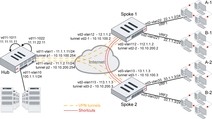

In example 1, multiple companies (or departments of a company) share the ADVPN. Company A and company B each have two branches in two different locations. Company A's branches (A-1 and A-2) can talk to each other using the VPN shortcut, but not to company B's branches (B-1 and B-2). Likewise, company B's branches can talk to each other using the VPN shortcut, but not to company A's branches. Traffic can share the tunnels and shortcuts, but cannot be mixed up.
Example 2 shows that performance SLA health checks can be sent from a spoke's VRF to the loopback on the hub that is in the same VRF.
Example 3 shows that when traffic is ingress on the hub on one overlay, it will preferably egress on the same overlay.
Example 1
In this example, two spokes each have two tunnels to the hub.
  • Each spoke has two VRFs behind it that can use the same IP address or subnets.
  • The computers in VRF1 behind spoke 1 can talk to the computers in VRF1 behind spoke 2, but not to any of the computers in the VRF2s behind either spoke.
  • The computers in VRF2 behind spoke 1 can talk to the computers in VRF2 behind spoke 2, but not to any of the computers in the VRF1s behind either spoke.

Example 2

In this example, when traffic from spoke 1 arrives at the hub on tunnel 1, it will egress the hub on tunnel 1 to go to other spokes. If traffic arrives on tunnel 2, it will egress on tunnel 2, and not tunnel 1.
Example 1
