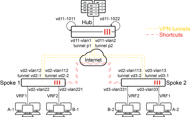

Example 1
In this example, two spokes each have two tunnels to the hub.
  • Each spoke has two VRFs behind it that can use the same IP address or subnets.
  • The computers in VRF1 behind spoke 1 can talk to the computers in VRF1 behind spoke 2, but not to any of the computers in the VRF2s behind either spoke.
  • The computers in VRF2 behind spoke 1 can talk to the computers in VRF2 behind spoke 2, but not to any of the computers in the VRF1s behind either spoke.

To test the configuration on shortcut 1:
  1. From VRF1 of spoke 1 ping VRF1 of spoke 2 and from VRF2 of spoke 1 ping VRF2 spoke 2. Both VRF1 and VRF2 source and destination IP addresses are the same, so you can see how the traffic is isolated
  2. Check sessions on spoke 1:
    The output vd=<vdom ID>:<VRF ID> indicates that sessions are created in and stay in the corresponding VRFs.
    • User at 22.1.1.22 in VRF1 on spoke 1 pings 33.1.1.33 in VRF1 on spoke2.

To test the configuration on shortcut 2:

In example 1, multiple companies (or departments of a company) share the ADVPN. Company A and company B each have two branches in two different locations. Company A's branches (A-1 and A-2) can talk to each other using the VPN shortcut, but not to company B's branches (B-1 and B-2). Likewise, company B's branches can talk to each other using the VPN shortcut, but not to company A's branches. Traffic can share the tunnels and shortcuts, but cannot be mixed up.
Example 2 shows that performance SLA health checks can be sent from a spoke's VRF to the loopback on the hub that is in the same VRF.
Example 3 shows that when traffic is ingress on the hub on one overlay, it will preferably egress on the same overlay.

Example 1

    • User at 22.1.1.22 in VRF2 on spoke 1 pings 33.1.1.33 in VRF2 on spoke 2:
      # diagnose sys session list
      session info: proto=1 proto_state=00 duration=17 expire=43 timeout=0 flags=00000000 socktype=0 sockport=0 av_idx=0 use=3
      origin-shaper=
      reply-shaper=
      per_ip_shaper=
      class_id=0 ha_id=0 policy_dir=0 tunnel=/ vlan_cos=0/255
      state=may_dirty npu
      statistic(bytes/packets/allow_err): org=168/2/1 reply=168/2/1 tuples=2
      tx speed(Bps/kbps): 9/0 rx speed(Bps/kbps): 9/0
      orgin->sink: org pre->post, reply pre->post dev=132->115/115->132 gwy=33.1.1.33/10.10.200.2
      hook=pre dir=org act=noop 22.1.1.22:24917->33.1.1.33:8(0.0.0.0:0)
      hook=post dir=reply act=noop 33.1.1.33:24917->22.1.1.22:0(0.0.0.0:0)
      dst_mac=02:4c:a5:fc:6a:7f
      misc=0 policy_id=1 pol_uuid_idx=630 auth_info=0 chk_client_info=0 vd=6:2
      serial=000a29ca tos=ff/ff app_list=0 app=0 url_cat=0
      rpdb_link_id=00000000 ngfwid=n/a
      npu_state=0x4000001 no_offload
      npu info: flag=0x00/0x82, offload=0/0, ips_offload=0/0, epid=0/0, ipid=0/0, vlan=0x0000/0x0000
      vlifid=0/0, vtag_in=0x0000/0x0000 in_npu=0/0, out_npu=0/0, fwd_en=0/0, qid=0/0
      no_ofld_reason:  disabled-by-policy
    • User at 22.1.1.22 in VRF1 on spoke 1 pings 33.1.1.133 in VRF1 on spoke 2:

Example 2
In this example, SLA health checks are sent from a spoke's VRF to the loopback on the hub that is in the same VRF.
To configure the health check:
config system sdwan
    config health-check
        edit "1"
            set server "11.11.22.11"
            set vrf 1
            set source 22.1.1.2
            set members 1 2
            config sla
                    set latency-threshold 200
                    set jitter-threshold 50
To check the health check status:
# diagnose sys sdwan health-check status  1
Health Check(1):
Seq(1 vd2-1): state(alive), packet-loss(0.000%) latency(0.023), jitter(0.002), mos(4.404), bandwidth-up(0), bandwidth-dw(0), bandwidth-bi(0) sla_map=0x1
Seq(2 vd2-2): state(alive), packet-loss(0.000%) latency(0.022), jitter(0.002), mos(4.404), bandwidth-up(0), bandwidth-dw(0), bandwidth-bi(0) sla_map=0x1
Example 3
In this example, when traffic from spoke 1 arrives at the hub on tunnel 1, it will egress the hub on tunnel 1 to go to other spokes. If traffic arrives on tunnel 2, it will egress on tunnel 2, and not tunnel 1.
