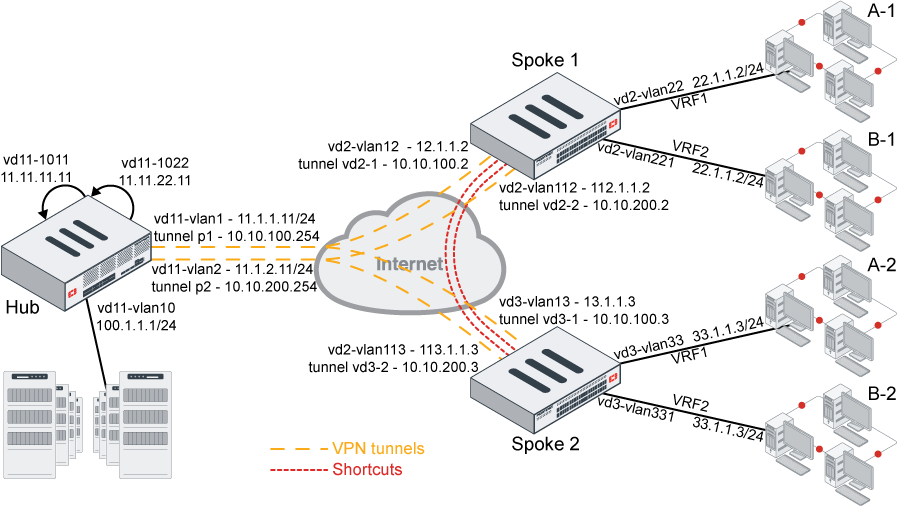

In example 1, multiple companies (or departments of a company) share the ADVPN. Company A and company B each have two branches in two different locations. Company A's branches (A-1 and A-2) can talk to each other using the VPN shortcut, but not to company B's branches (B-1 and B-2). Likewise, company B's branches can talk to each other using the VPN shortcut, but not to company A's branches. Traffic can share the tunnels and shortcuts, but cannot be mixed up.
Example 2 shows that performance SLA health checks can be sent from a spoke's VRF to the loopback on the hub that is in the same VRF.
Example 3 shows that when traffic is ingress on the hub on one overlay, it will preferably egress on the same overlay.
Example 1
In this example, two spokes each have two tunnels to the hub.
Each spoke has two VRFs behind it that can use the same IP address or subnets.
The computers in VRF1 behind spoke 1 can talk to the computers in VRF1 behind spoke 2, but not to any of the computers in the VRF2s behind either spoke.
The computers in VRF2 behind spoke 1 can talk to the computers in VRF2 behind spoke 2, but not to any of the computers in the VRF1s behind either spoke.

To test the configuration on shortcut 1:
From VRF1 of spoke 1 ping VRF1 of spoke 2 and from VRF2 of spoke 1 ping VRF2 spoke 2. Both VRF1 and VRF2 source and destination IP addresses are the same, so you can see how the traffic is isolated
Check sessions on spoke 1:
The output
vd=<vdom ID>:<VRF ID>indicates that sessions are created in and stay in the corresponding VRFs.-
User at 22.1.1.22 in VRF1 on spoke 1 pings 33.1.1.33 in VRF1 on spoke2.
# diagnose sys session list session info: proto=1 proto_state=00 duration=21 expire=42 timeout=0 flags=00000000 socktype=0 sockport=0 av_idx=0 use=3 origin-shaper= reply-shaper= per_ip_shaper= class_id=0 ha_id=0 policy_dir=0 tunnel=/ vlan_cos=0/255 state=may_dirty statistic(bytes/packets/allow_err): org=420/5/1 reply=420/5/1 tuples=2 tx speed(Bps/kbps): 0/0 rx speed(Bps/kbps): 0/0 orgin->sink: org pre->post, reply pre->post dev=89->131/131->89 gwy=10.10.200.3/22.1.1.22 hook=pre dir=org act=noop 22.1.1.22:48417->33.1.1.33:8(0.0.0.0:0) hook=post dir=reply act=noop 33.1.1.33:48417->22.1.1.22:0(0.0.0.0:0) src_mac=02:4c:a5:fc:6a:7f misc=0 policy_id=1 pol_uuid_idx=566 auth_info=0 chk_client_info=0 vd=1:1 serial=00092eee tos=ff/ff app_list=0 app=0 url_cat=0 sdwan_mbr_seq=0 sdwan_service_id=1 rpdb_link_id=ff000001 ngfwid=n/a npu_state=0x5040001 no_offload no_ofld_reason: disabled-by-policy non-npu-intf
User at 22.1.1.22 in VRF2 on spoke 1 pings 33.1.1.33 in VRF2 on spoke2:
# diagnose sys session list session info: proto=1 proto_state=00 duration=4 expire=56 timeout=0 flags=00000000 socktype=0 sockport=0 av_idx=0 use=3 origin-shaper= reply-shaper= per_ip_shaper= class_id=0 ha_id=0 policy_dir=0 tunnel=/ vlan_cos=0/255 state=may_dirty statistic(bytes/packets/allow_err): org=168/2/1 reply=168/2/1 tuples=2 tx speed(Bps/kbps): 39/0 rx speed(Bps/kbps): 39/0 orgin->sink: org pre->post, reply pre->post dev=113->131/131->113 gwy=10.10.200.3/22.1.1.22 hook=pre dir=org act=noop 22.1.1.22:55841->33.1.1.33:8(0.0.0.0:0) hook=post dir=reply act=noop 33.1.1.33:55841->22.1.1.22:0(0.0.0.0:0) src_mac=02:4c:a5:fc:6a:7f misc=0 policy_id=1 pol_uuid_idx=566 auth_info=0 chk_client_info=0 vd=1:2 serial=00092f77 tos=ff/ff app_list=0 app=0 url_cat=0 sdwan_mbr_seq=0 sdwan_service_id=1 rpdb_link_id=ff000001 ngfwid=n/a npu_state=0x5040001 no_offload no_ofld_reason: disabled-by-policy non-npu-intf
Check sessions on spoke 2:
The output
User at 22.1.1.22 in VRF1 on spoke 1 pings 33.1.1.33 in VRF1 on spoke 2:
# diagnose sys session list session info: proto=1 proto_state=00 duration=11 expire=49 timeout=0 flags=00000000 socktype=0 sockport=0 av_idx=0 use=3 origin-shaper= reply-shaper= per_ip_shaper= class_id=0 ha_id=0 policy_dir=0 tunnel=/ vlan_cos=0/255 state=may_dirty npu statistic(bytes/packets/allow_err): org=168/2/1 reply=168/2/1 tuples=2 tx speed(Bps/kbps): 14/0 rx speed(Bps/kbps): 14/0 orgin->sink: org pre->post, reply pre->post dev=132->92/92->132 gwy=33.1.1.33/10.10.200.2 hook=pre dir=org act=noop 22.1.1.22:27733->33.1.1.33:8(0.0.0.0:0) hook=post dir=reply act=noop 33.1.1.33:27733->22.1.1.22:0(0.0.0.0:0) misc=0 policy_id=1 pol_uuid_idx=630 auth_info=0 chk_client_info=0 vd=6:1 serial=000a29fd tos=ff/ff app_list=0 app=0 url_cat=0 rpdb_link_id=00000000 ngfwid=n/a npu_state=0x4000001 no_offload npu info: flag=0x00/0x82, offload=0/0, ips_offload=0/0, epid=0/0, ipid=0/0, vlan=0x0000/0x0000 vlifid=0/0, vtag_in=0x0000/0x0000 in_npu=0/0, out_npu=0/0, fwd_en=0/0, qid=0/0 no_ofld_reason: disabled-by-policy
User at 22.1.1.22 in VRF2 on spoke 1 pings 33.1.1.33 in VRF2 on spoke 2:
# diagnose sys session list session info: proto=1 proto_state=00 duration=17 expire=43 timeout=0 flags=00000000 socktype=0 sockport=0 av_idx=0 use=3 origin-shaper= reply-shaper= per_ip_shaper= class_id=0 ha_id=0 policy_dir=0 tunnel=/ vlan_cos=0/255 state=may_dirty npu statistic(bytes/packets/allow_err): org=168/2/1 reply=168/2/1 tuples=2 tx speed(Bps/kbps): 9/0 rx speed(Bps/kbps): 9/0 orgin->sink: org pre->post, reply pre->post dev=132->115/115->132 gwy=33.1.1.33/10.10.200.2 hook=pre dir=org act=noop 22.1.1.22:24917->33.1.1.33:8(0.0.0.0:0) hook=post dir=reply act=noop 33.1.1.33:24917->22.1.1.22:0(0.0.0.0:0) dst_mac=02:4c:a5:fc:6a:7f misc=0 policy_id=1 pol_uuid_idx=630 auth_info=0 chk_client_info=0 vd=6:2 serial=000a29ca tos=ff/ff app_list=0 app=0 url_cat=0 rpdb_link_id=00000000 ngfwid=n/a npu_state=0x4000001 no_offload npu info: flag=0x00/0x82, offload=0/0, ips_offload=0/0, epid=0/0, ipid=0/0, vlan=0x0000/0x0000 vlifid=0/0, vtag_in=0x0000/0x0000 in_npu=0/0, out_npu=0/0, fwd_en=0/0, qid=0/0 no_ofld_reason: disabled-by-policy
To test the configuration on shortcut 2:
The output
User at 22.1.1.22 in VRF1 on spoke 1 pings 33.1.1.133 in VRF1 on spoke 2:
# diagnose sys session listsession info: proto=1 proto_state=00 duration=17 expire=45 timeout=0 flags=00000000 socktype=0 sockport=0 av_idx=0 use=3 origin-shaper= reply-shaper= per_ip_shaper= class_id=0 ha_id=0 policy_dir=0 tunnel=/ vlan_cos=0/255 state=may_dirty statistic(bytes/packets/allow_err): org=336/4/1 reply=336/4/1 tuples=2 tx speed(Bps/kbps): 19/0 rx speed(Bps/kbps): 19/0 orgin->sink: org pre->post, reply pre->post dev=89->137/137->89 gwy=10.10.200.3/22.1.1.22 hook=pre dir=org act=noop 22.1.1.22:25968->33.1.1.133:8(0.0.0.0:0) hook=post dir=reply act=noop 33.1.1.133:25968->22.1.1.22:0(0.0.0.0:0) src_mac=02:4c:a5:fc:6a:7f misc=0 policy_id=1 pol_uuid_idx=566 auth_info=0 chk_client_info=0 vd=1:1 serial=000aa475 tos=ff/ff app_list=0 app=0 url_cat=0 sdwan_mbr_seq=0 sdwan_service_id=2 rpdb_link_id=ff000002 ngfwid=n/a npu_state=0x5040001 no_offload no_ofld_reason: disabled-by-policy non-npu-intf
User at 22.1.1.22 in VRF2 on spoke 1 pings 33.1.1.133 in VRF2 on spoke 2:
# diagnose sys session listsession info: proto=1 proto_state=00 duration=8 expire=53 timeout=0 flags=00000000 socktype=0 sockport=0 av_idx=0 use=3 origin-shaper= reply-shaper= per_ip_shaper= class_id=0 ha_id=0 policy_dir=0 tunnel=/ vlan_cos=0/255 state=may_dirty statistic(bytes/packets/allow_err): org=252/3/1 reply=252/3/1 tuples=2 tx speed(Bps/kbps): 30/0 rx speed(Bps/kbps): 30/0 orgin->sink: org pre->post, reply pre->post dev=113->137/137->113 gwy=10.10.200.3/22.1.1.22 hook=pre dir=org act=noop 22.1.1.22:28528->33.1.1.133:8(0.0.0.0:0) hook=post dir=reply act=noop 33.1.1.133:28528->22.1.1.22:0(0.0.0.0:0) src_mac=02:4c:a5:fc:6a:7f misc=0 policy_id=1 pol_uuid_idx=566 auth_info=0 chk_client_info=0 vd=1:2 serial=000aa49f tos=ff/ff app_list=0 app=0 url_cat=0 sdwan_mbr_seq=0 sdwan_service_id=2 rpdb_link_id=ff000002 ngfwid=n/a npu_state=0x5040001 no_offload no_ofld_reason: disabled-by-policy non-npu-intf
The output
# diagnose sys session list session info: proto=1 proto_state=00 duration=24 expire=38 timeout=0 flags=00000000 socktype=0 sockport=0 av_idx=0 use=3 origin-shaper= reply-shaper= per_ip_shaper= class_id=0 ha_id=0 policy_dir=0 tunnel=/ vlan_cos=0/255 state=may_dirty npu statistic(bytes/packets/allow_err): org=336/4/1 reply=336/4/1 tuples=2 tx speed(Bps/kbps): 13/0 rx speed(Bps/kbps): 13/0 orgin->sink: org pre->post, reply pre->post dev=138->92/92->138 gwy=33.1.1.133/10.10.200.2 hook=pre dir=org act=noop 22.1.1.22:25968->33.1.1.133:8(0.0.0.0:0) hook=post dir=reply act=noop 33.1.1.133:25968->22.1.1.22:0(0.0.0.0:0) misc=0 policy_id=1 pol_uuid_idx=630 auth_info=0 chk_client_info=0 vd=6:1 serial=000aa476 tos=ff/ff app_list=0 app=0 url_cat=0 rpdb_link_id=00000000 ngfwid=n/a npu_state=0x4000001 no_offload npu info: flag=0x00/0x82, offload=0/0, ips_offload=0/0, epid=0/0, ipid=0/0, vlan=0x0000/0x0000 vlifid=0/0, vtag_in=0x0000/0x0000 in_npu=0/0, out_npu=0/0, fwd_en=0/0, qid=0/0 no_ofld_reason: disabled-by-policy
User at 22.1.1.22 in VRF2 on spoke 1 pings 33.1.1.133 in VRF2 on spoke2:
# diagnose sys session list session info: proto=1 proto_state=00 duration=15 expire=46 timeout=0 flags=00000000 socktype=0 sockport=0 av_idx=0 use=3 origin-shaper= reply-shaper= per_ip_shaper= class_id=0 ha_id=0 policy_dir=0 tunnel=/ vlan_cos=0/255 state=may_dirty npu statistic(bytes/packets/allow_err): org=252/3/1 reply=252/3/1 tuples=2 tx speed(Bps/kbps): 16/0 rx speed(Bps/kbps): 16/0 orgin->sink: org pre->post, reply pre->post dev=138->115/115->138 gwy=33.1.1.133/10.10.200.2 hook=pre dir=org act=noop 22.1.1.22:28528->33.1.1.133:8(0.0.0.0:0) hook=post dir=reply act=noop 33.1.1.133:28528->22.1.1.22:0(0.0.0.0:0) misc=0 policy_id=1 pol_uuid_idx=630 auth_info=0 chk_client_info=0 vd=6:2 serial=000aa4a0 tos=ff/ff app_list=0 app=0 url_cat=0 rpdb_link_id=00000000 ngfwid=n/a npu_state=0x4000001 no_offload npu info: flag=0x00/0x82, offload=0/0, ips_offload=0/0, epid=0/0, ipid=0/0, vlan=0x0000/0x0000 vlifid=0/0, vtag_in=0x0000/0x0000 in_npu=0/0, out_npu=0/0, fwd_en=0/0, qid=0/0 no_ofld_reason: disabled-by-policy
