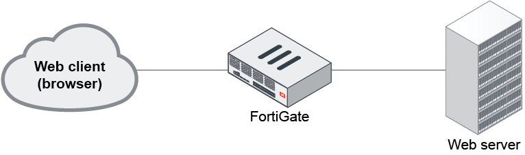

When a HTTP request requires authentication in an explicit proxy, the authentication can be redirected to a secure HTTPS captive portal. Once authentication is complete, the client can be redirected back to the original destination over HTTP.
Example
A user visits a website via HTTP through the explicit web proxy on a FortiGate. The user is required to authenticate by either basic or form IP-based authentication for the explicit web proxy service. The user credentials need to be transmitted over the networks in a secured method over HTTPS rather than in plain text. The user credentials are protected by redirecting the client to a captive portal of the FortiGate over HTTPS for authentication where the user credentials are encrypted and transmitted over HTTPS.
In this example, explicit proxy authentication over HTTPS is configured with form IP-based authentication. Once configured, you can enable authorization for an explicit web proxy by configuring users or groups in the firewall proxy policy.
Example
