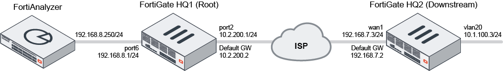

Sample topology
This sample topology shows a downstream FortiGate (HQ2) connected to the root FortiGate (HQ1) over IPsec VPN to join Security Fabric.

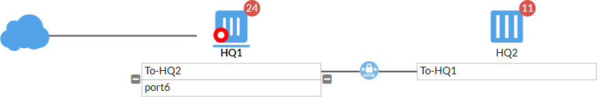

To check Security Fabric over IPsec VPN:
- On the root FortiGate (HQ1), go to Security Fabric > Physical Topology.
The root FortiGate (HQ1) is connected by the downstream FortiGate (HQ2) with VPN icon in the middle.
On the root FortiGate (HQ1), go to Security Fabric > Logical Topology.
The root FortiGate (HQ1) VPN interface To-HQ2 is connected by downstream FortiGate (HQ2) VPN interface To-HQ1 with VPN icon in the middle.
