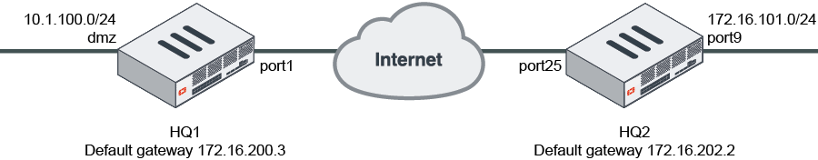

This is a sample configuration of IPsec VPN authenticating a remote FortiGate peer with a certificate. The certificate on one peer is validated by the presence of the CA certificate installed on the other peer.

- Configure the WAN interface and default route. The WAN interface is the interface connected to the ISP. The IPsec tunnel is established over the WAN interface.
- Configure HQ1.
config system interface edit "port1" set vdom "root" set ip 172.16.200.1 255.255.255.0 next end config router static edit 1 set gateway 172.16.200.3 set device "port1" next end
- Configure HQ2.
config system interface edit "port25" set vdom "root" set ip 172.16.202.1 255.255.255.0 next end config router static edit 1 set gateway 172.16.202.2 set device "port25" next end
- Configure HQ1.
- Configure the internal (protected subnet) interface. The internal interface connects to the corporate internal network. Traffic from this interface routes out the IPsec VPN tunnel.
- Configure HQ1.
config system interface edit "dmz" set vdom "root" set ip 10.1.100.1 255.255.255.0 next end
- Configure HQ2.
config system interface edit "port9" set vdom "root" set ip 172.16.101.1 255.255.255.0 next end

- Configure the static routes. Two static routes are added to reach the remote protected subnet. The blackhole route is important to ensure that IPsec traffic does not match the default route when the IPsec tunnel is down.
- Configure HQ1.
config router static edit 2 set dst 172.16.101.0 255.255.255.0 set device "to_HQ2" next edit 3 set dst 172.16.101.0 255.255.255.0 set blackhole enable set distance 254 next end
- Configure HQ2.
config router static edit 2 set dst 10.1.100.0 255.255.255.0 set device "to_HQ1" next edit 3 set dst 10.1.100.0 255.255.255.0 set blackhole enable set distance 254 next end
- Configure HQ1.
- Configure two firewall policies to allow bidirectional IPsec traffic flow over the IPsec VPN tunnel.
- Configure HQ1.
config firewall policy edit 1 set name "inbound" set srcintf "to_HQ2" set dstintf "dmz" set srcaddr "172.16.101.0" set dstaddr "10.1.100.0" set action accept set schedule "always" set service "ALL" next edit 2 set name "outbound" set srcintf "dmz" set dstintf "to_HQ2" set srcaddr "10.1.100.0" set dstaddr "172.16.101.0" set action accept set schedule "always" set service "ALL" next end
- Configure HQ2.
config firewall policy edit 1 set name "inbound" set srcintf "to_HQ1" set dstintf "port9" set srcaddr "10.1.100.0" set dstaddr "172.16.101.0" set action accept set schedule "always" set service "ALL" next edit 2 set name "outbound" set srcintf "port9" set dstintf "to_HQ1" set srcaddr "172.16.101.0" set dstaddr "10.1.100.0" set action accept set schedule "always" set service "ALL" next end
