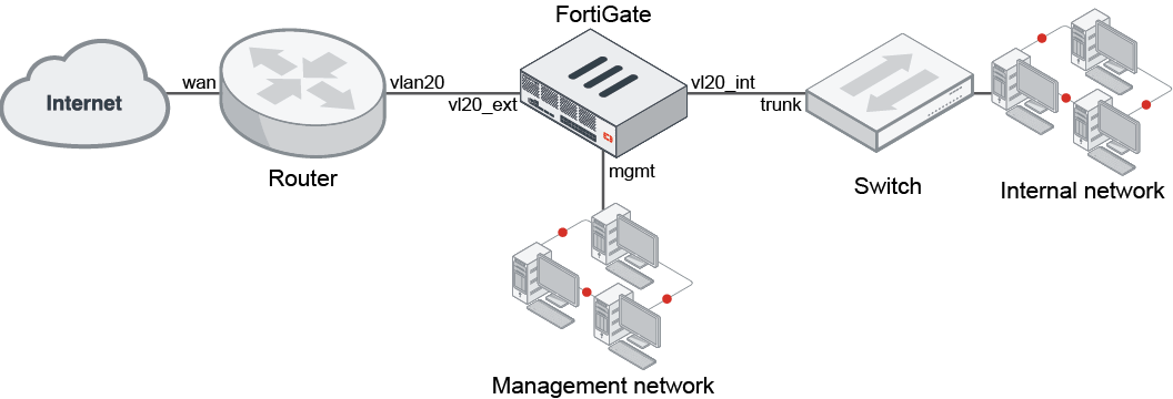

Transparent mode
The FortiGate or VDOM operates in layer 2 to forward traffic between network devices such as routers, firewalls, and switches. For example. it can be installed inline between a router and a switch to perform security scanning without changing the network topology or modifying the IP addresses. When you add a FortiGate that is in transparent mode to a network, it only needs to be provided with a management IP address in order to access the device. It is recommended that a dedicated interface is used to connect to the management network in transparent mode.
The following topology is an example of a transparent mode FortiGate inserted inline between a router and a switch:
Using transparent mode VDOMs is recommended when multiple VLANs pass through the FortiGate. Otherwise, they must be separated into different forwarding domains within the same VDOM.
See NAT and transparent mode for more information.
